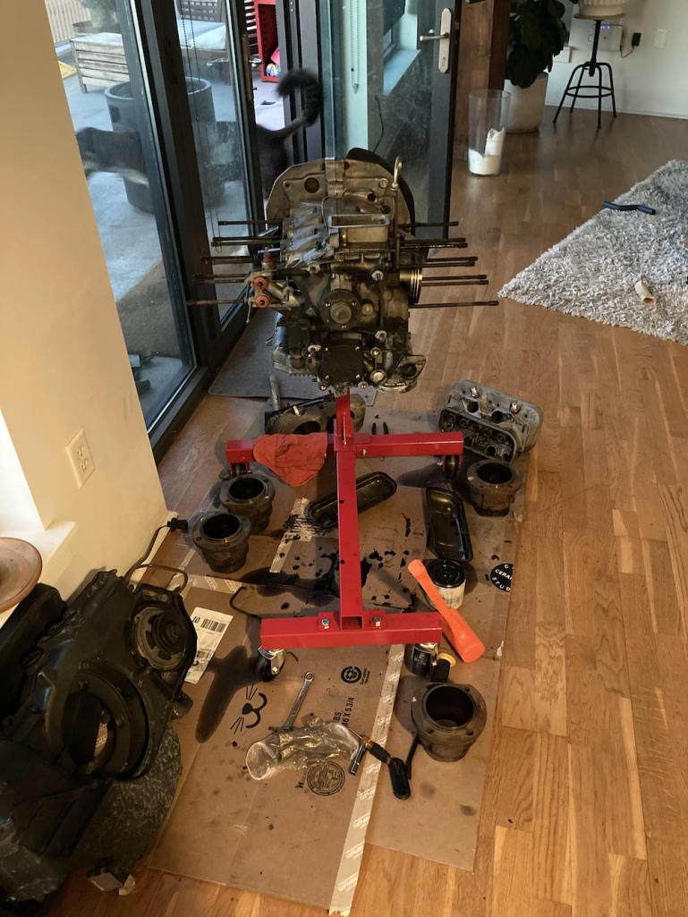

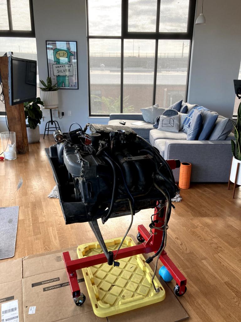

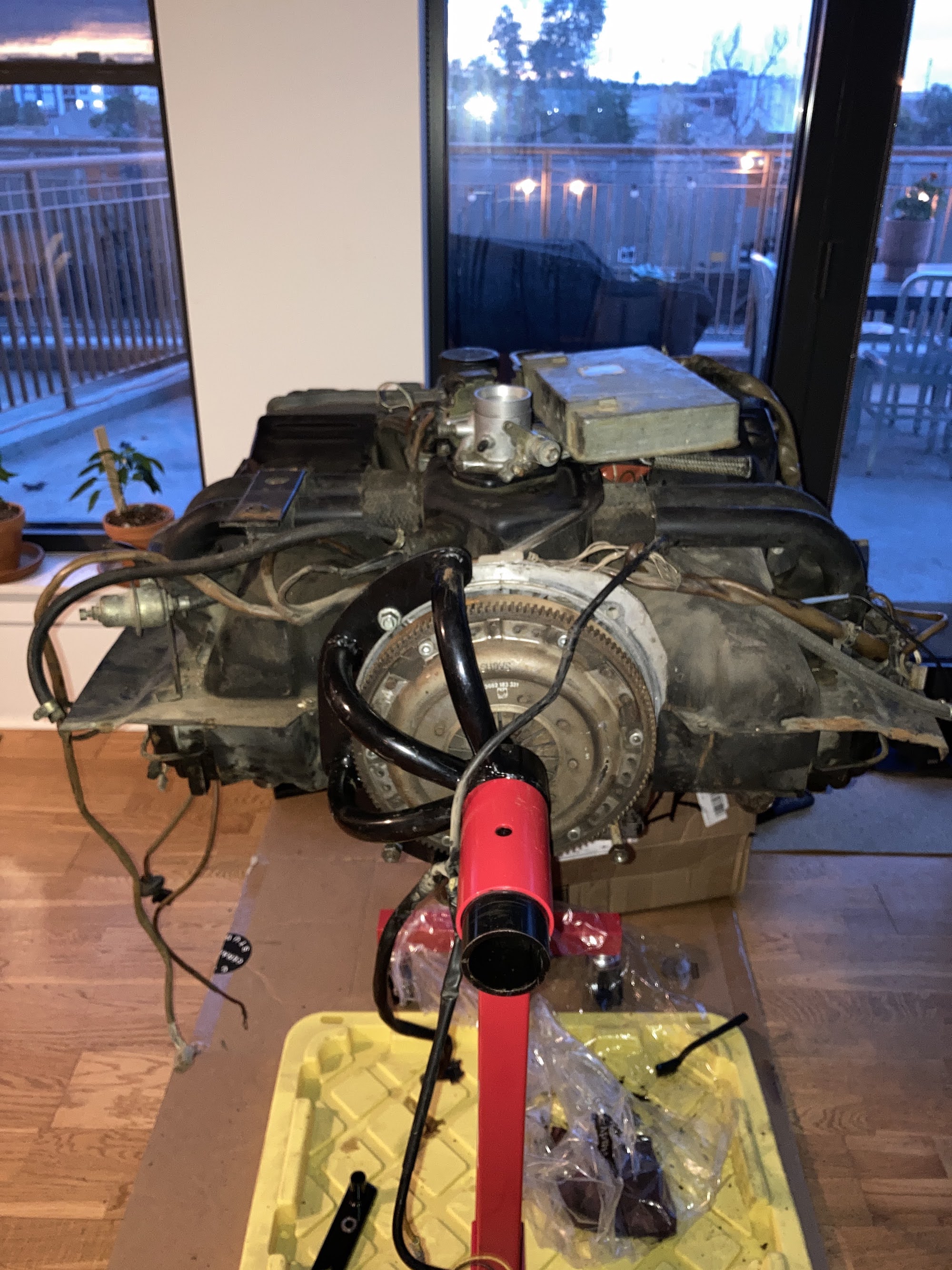

Yes, I do mean it when I said I'm tearing down the motor in my livingroom. I have a very understanding girlfriend.

What a terrific color and nice chassis. I don't think I could get away with the engine in our home, but you got a keeper there if she allows it. (IMG:style_emoticons/default/beerchug.gif)

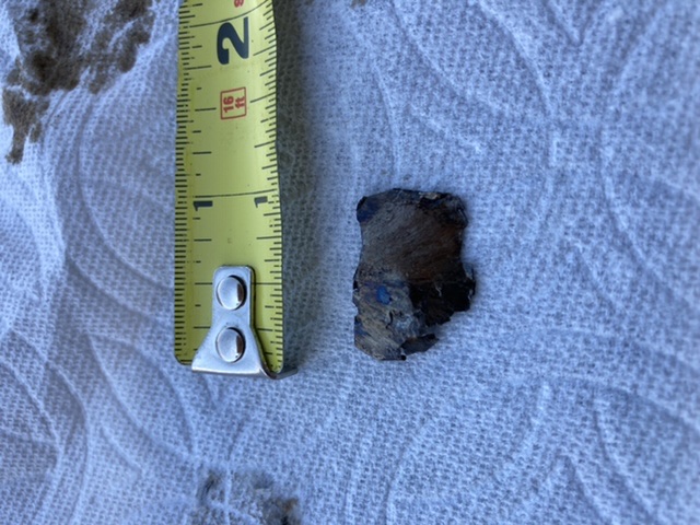

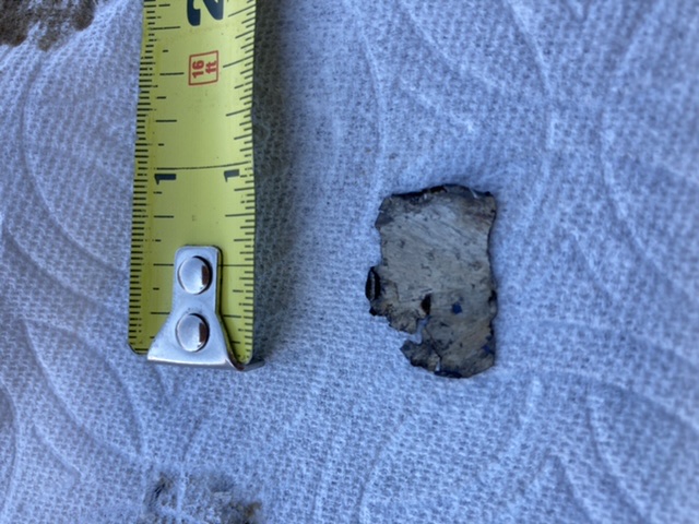

Just a few days in and I already have a scare. I’ve pulled tin off the engine, cleaned everything I could, and ordered hoses, hardware, and seals. I just opened the oil filler neck and saw something at the bottom of the chamber. I grabbed a magnet, and this 1” piece of metal shot out.
Does anybody have a clue as to what this might be? I’m hoping it’s a foreign object and not a piece of the case, but I’m stumped as to where it came from. My hope with this motor was to run it without splitting the case, but that plan is in doubt now. The metal piece has jagged edges and is shiny. Any guesses are appreciated.

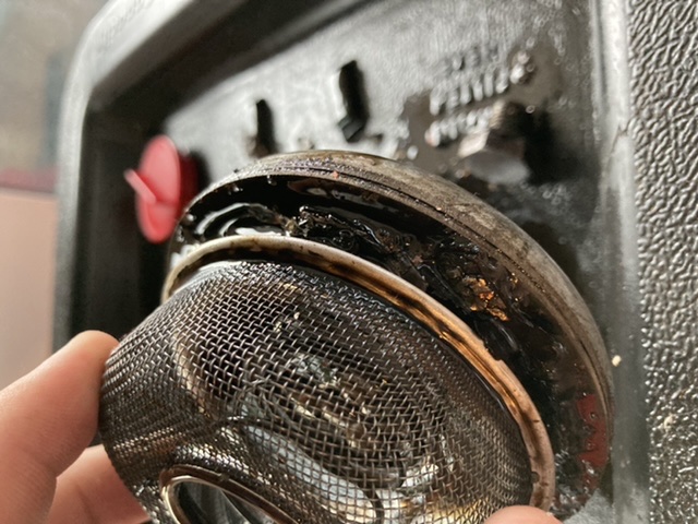

Opened the sump plate and it’s metal city! Looks like it’s time to split the case and check the damage.

QUOTE(andrewck @ Jul 31 2020, 12:27 PM) *
QUOTE(Cairo94507 @ Jul 26 2020, 01:45 PM) *
I hate to say it, but that looks like a piece of a bearing. (IMG:style_emoticons/default/barf.gif)

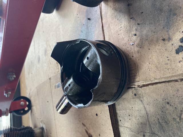

If I were a betting man, I’d say this could be the problem. The remains of piston #1...how does this even happen?
IronHillRestorations
post Aug 3 2020, 08:11 PM
I. I. R. C.
Posts: 6,959
Joined: 18-March 03
From: West TN
Member No.: 439
Friction from worn rings, or a bad rebuild

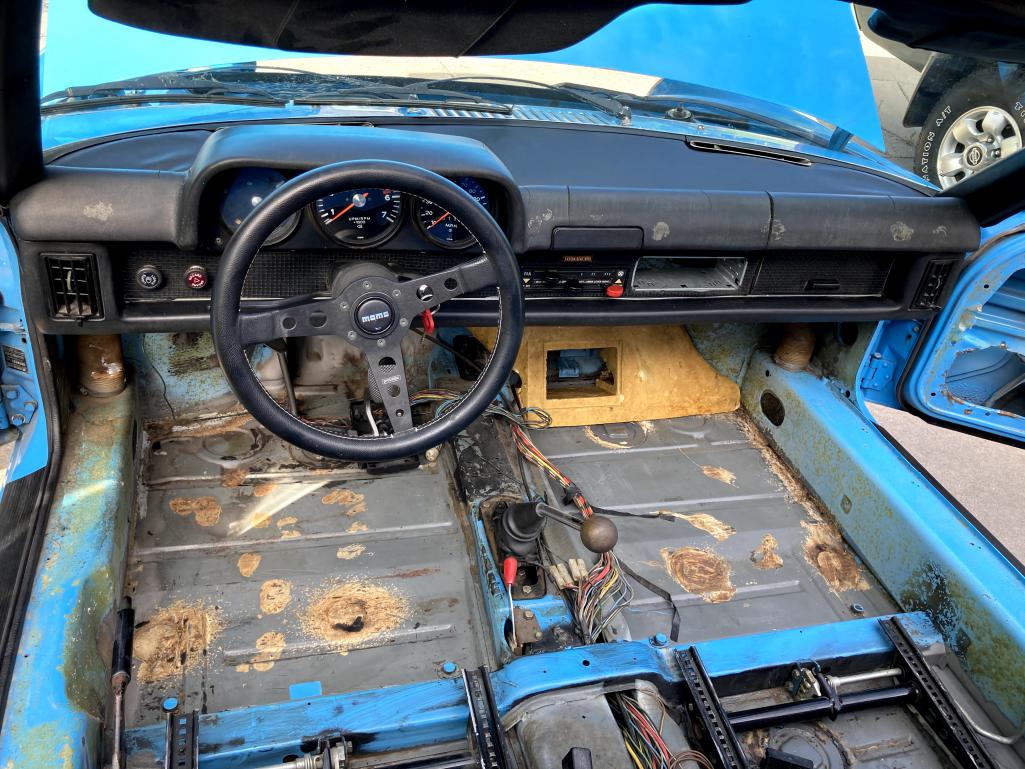

The car made its way home with me today and is ready to be reassembled! It's amazing how small the 914 is compared to my 996 2S. Having not run across major issues yet, my super ambitious and 'straight forward" plan is:
Interior
- Test electric and start to button up the cabin
- Replace dash
- Install door cards
- Install perlon backing
- Install carpet
- Install seats
- Door cards
Suspension & brakes
- Get tires mounted
- Install new front/rear rotors and hubs (5 lug conversion)
- Mount rebuilt calipers
Fuel
- Install all new hard lines
- Install all new fuel hoses and filter
- Install gas tank
Exterior
- Paint side skirts
Motor
- Reassemble 2nd 2.0 that came with the car and run it ASAP
- Build out the second 2.0 into 2056 perhaps over the next 1-2 years
- Rebuild the second transmission using Dr. Evil's course
Having just typed out that list, it feels a bit daunting but really excited to get going and build my first car! Also, the dog is already upset about how much attention the car is taking away from him. Hope to reward him with a wind-filled drive this fall.
