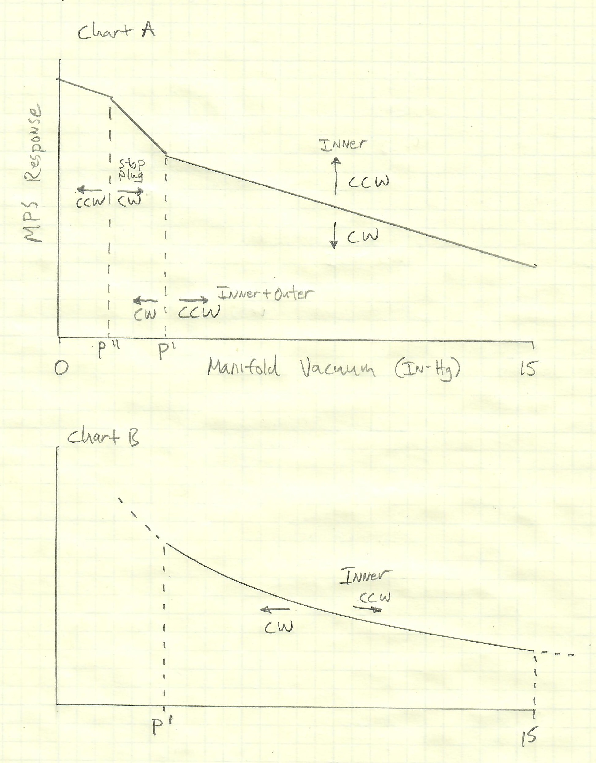

As you can see in the "Chart A" sketch above, the MPS Inner Screw (in isolation), Outer Screw+Inner Screw (together), and Stop Plug Screw can be used to tune the MPS's affect on the AFR (via its effect on the Fuel Injection pulse width) vs Manifold Vacuum. As shown, the Inner Screw affects the mixture over the whole vacuum range; the Inner+Outer Screw controls the onset pressure P' where the diaphragm begins to lift off the part-load stop; the Stop Plug Screw controls the final pressure P'' where the diaphragm comes to rest on the full-load stop. On this chart, "up" corresponds to a longer FI pulse; "down" to a shorter FI pulse. For details, see pbanders's excellent link, above.
I had previously thought that the effect of the Inner Screw was similar to that of changing the fuel pressure via the fuel pressure regulator. Namely:
Inner Screw CCW = Increase Fuel Pressure => Richer AFR across entire vacuum range
Inner Screw CW = Decrease Fuel Pressure => Leaner AFR across entire vacuum range
There appeared to be no way to change the slope of the MPS Response curve in the region from 15 In-Hg to P'. And, I was experiencing the same problem that Demick posted about years ago in the thread linked above. Namely, the AFR would become too lean under moderate-load conditions across all RPM's, like this (from Demick's post):

To fix the lean condition around 6-8 In-Hg, it's really necessary to change the slope of the MPS response curve, not just raise or lower the whole curve.
However, there appears to be hope. It seems that the MPS inductance is not simply linear WRT manifold pressure in the 15 In-Hg to P' region. I speculate that this may be due to non-linearity in the MPS Inductance across its range of movement and/or the effect of the MPS spring. The result is that the curve seems to look more like the "Chart B" sketch above. And, the effect of turning the MPS inner screw isn't really raising or lower the entire curve, but rather shifting the Chart B curve left/right. (Chart B is a really rough sketch, and may even have the convexity backwards. For a more quantitative look, see below.)

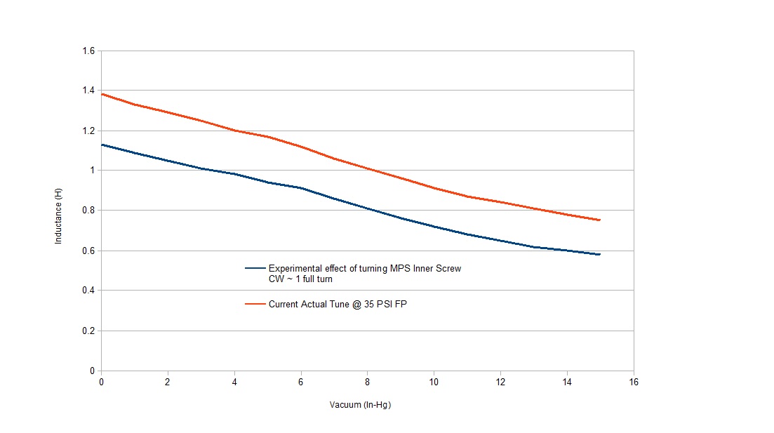

I measured the inductance of my MPS at two different inner-screw settings: The red curve is the MPS tuned to pbanders's values corrected for 700 Torr ambient pressure. The blue curve represents an attempt to richen the AFR by turning the inner screw CCW.

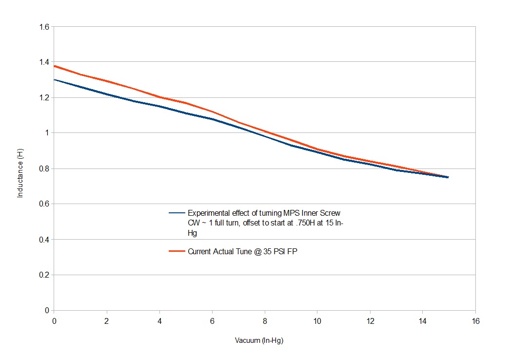

As you can see, the slope of the red curve is steeper than the blue curve in this region. Apparently, turning the inner screw CCW has the effect of reducing the slope by raising the right end, rather than raising the whole curve.
I'm surprised that the curves cross around 7 In-Hg and that the blue curve value is less than the red curve value at the left side of the chart. This may be due to the effect of the part-load stop coming into play near P', measurement error, or something else. (IMG:style_emoticons/default/confused24.gif)
The salient point, however, is that adjusting the inner screw affects the slope of the curve, whereas presumably adjusting the fuel pressure does not.
The opens the possibility of tuning the AFR vs Manifold pressure curve by trading off fuel pressure vs inner screw position:
Increase Fuel Pressure + Turn Inner Screw CW => Enrich 6-8 In-Hg region
Decrease Fuel Pressure + Turn Inner Screw CCW = Lean out 6-8 In-Hg region

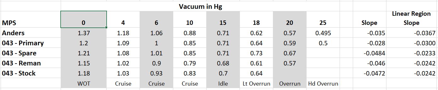

Just for fun I'll throw in some of my data and "analysis" from a few years ago. This was when I was trying to tune a 2056 with a stock cam and later a 2056 with a Raby 9950 (or 9550, whichever it is). I think the latter is similar to a Webcam 73, or maybe even the same grind.
I ended up comparing the following for vacuum / inductance numbers for the 043 MPS, which should have been correct for my '74 D-Jet setup (and compatible with the 043 ECU):
1. Anders' numbers for MPS tuning on his website.
2. An 043 "Primary" that I rebuilt using Chris Foley's kit. This was the one I fiddled with the most in terms of tuning and driving.
3. 043 "Spare." This one was also rebuilt, and I used this kind of as my fallback if I screwed up the primary too badly. I also used it to compare how the car ran with the other one.
4. 043 "Reman." This one was rebuilt and tuned years ago by that company that used to perform this service years ago ("Fuel Injection Company" or whatever it is/was). I did not mess with this one.
5. 043 "Stock." Thanks to the yard sale at Jim McLeod's (RIP (IMG:style_emoticons/default/sad.gif) ) a couple of years ago I managed to acquire a working, unmolested 043. Used this primarily to baseline my inductance meter's numbers against those of Anders.
Here are the results in table form. Remember, I was primarily tuning 043 "Primary" and "Spare," so those numbers could be all over the place. I've got the slope in there, but the most relevant slope is that over the "linear region" which I think Anders defines as between 6 and 18 in Hg.
And here's the graph, such as it is.

QUOTE(BeatNavy @ Aug 16 2020, 05:19 AM) *
Here are my lessons learned:
1. I spend a LOT of time on this, and I learned a lot, which was enjoyable. But I got more return out of that than any performance increase or optimization (IMG:style_emoticons/default/smile.gif)
2. Inductance meters seem to vary significantly. I'm not sure why this is (I know mine was a cheap one, not a Wavetek), but I know others have had similar findings. You can see that my stock 043 didn't even get close to Anders' numbers, which I found interesting. It also means you can't simply go by Anders' numbers if you are using those as a baseline.
3. Chasing AFR can be a challenge. Type 4 idle AFR can be very unreliable, and exhaust leaks and/or valve issues can really mess with the numbers. Different exhaust systems / bung location can also impact your values. I guess my point here is that trying to get to an exact AFR down to the tenth can be like chasing your tail. Sometimes it's more important to focus on what the car is telling you (how much that engine "likes" the tune in terms of performance, gas consumption, plug fouling, etc. etc.).
4. I took a tip from a member here (Frank, I believe), and hooked up a "T" vacuum line from my MPS to a vac gauge in the cockpit. That was very helpful for understanding the relationship between "part load," throttle position, and AFR. It gave me a better understanding of when I should be looking for what AFR value. EDIT: in that regard, I should have changed the labels in the table above where 4 in Hg is not "cruise" but "strong acceleration" and 6 in Hg "acceleration."
5. D-Jet has limitations (of course). It works like a champ for what it was intended to do, but of course you can only tease so much out of it either in terms of fine-tuning or performance enhancements. Unless you REALLY get creative or go off the deep end. I've recently moved on to Microsquirt where I can now be ignorant in that arena (IMG:style_emoticons/default/smile.gif)
Just my two cents for the OP who obviously has a much more rigorous scientific and analytical background than do I.
BeatNavy, That's awesome data! Thanks.
Your "Anders" values look like they are for 1280 ft el (726 Torr). At what elevation did you measure the others? (I assume your values are raw -- uncorrected for elevation.)
"I spend a LOT of time on this, and I learned a lot, which was enjoyable. But I got more return out of that than any performance increase or optimization"
Yeah! No kidding. I've got way too much time in this so far, but I think it's been really worthwhile. The most valuable stuff for me was 1) Getting a wideband O2 meter instead of trying to tune it blind, and 2) Tangerine Racing's MPS adjustment kit which lets you easily tune the MPS in-car rather than taking it out and fiddling with it on a bench.
"I took a tip from a member here (Frank, I believe), and hooked up a "T" vacuum line from my MPS to a vac gauge in the cockpit."
I've been doing the same thing. Tuning would be much simpler if I had data logging and a couple hours of dyno time. As it is, I have an analog vac gauge and hand-held non-logging AFR meter in the car. I have a 5-mile loop with a nice hill in the middle. I drive a loop, glance at the numbers. Stop, write everything down. Make a small adjustment to...something. Lather, rinse, repeat. (IMG:style_emoticons/default/biggrin.gif)
"I've recently moved on to Microsquirt where I can now be ignorant in that arena"
When I first bought my car, the fact that it had the original D-Jet mostly intact and mostly working was part of its appeal. Had I to do it all over again, I think I would have gone with a Microsquirt as well when I had the engine rebuilt. (IMG:style_emoticons/default/unsure.gif)
Cheers. (IMG:style_emoticons/default/beerchug.gif)

*** UPDATE ***
I was bothered by the Inductance vs Vacuum graph in my OP (the one with the red and blue lines). I couldn't explain why the red and blue curves crossed at around 7 In-Hg. I also wanted to illustrate how to determine P' and P'' from the graphs. Finally, Olympic914 asked why the graph didn't go all the way to 0 In-Hg.
So, I took some more data. I'm at 2250 ft elevation (700 Torr), and its about 90F in the garage today. The red curve in the graph below shows my actual current MPS tune. The blue curve shows the effect of turning the inner MPS screw (in isolation) one full turn CW. The blue curve is just an experiment to see what would happen to the MPS response -- it doesn't represent any kind of useful tune. I also graphed the data all the way down to 0 In-Hg to show the WOT part of the response.
At first glance, it appears that turning the inner screw CW just lowers the whole curve. But, if you "raise" the blue curve by adding an offset so it starts at .750H at 15 In-Hg like the red curve, the difference in slope becomes clearer:
P', where the MPS diaphram begins to lift off of the part-load stop, and P'', where the diaphram hits the full-load stop aren't readily visible with this particular tune because their effects on the slope are too small to see here.
As to the crossing traces in the OP, data for that graph was taken on different days with different tunes. So, maybe the effect of the outer screw and/or plug affected the values. Maybe it was a difference in temperature or barometric pressure on those days. Maybe it was a measurement error. I dunno. (IMG:style_emoticons/default/confused24.gif)
Finally, the graph in my OP appeared to show that turning the inner screw CW would make the slope of the response curve steeper and thus:
Today's data shows exactly the reverse -- turning the inner screw CW appears to reduce the slope of the response curve. Hence:
Increase Fuel Pressure + Turn Inner Screw CW => Lean out 6-8 In-Hg region
Decrease Fuel Pressure + Turn Inner Screw CCW = Enrichen out 6-8 In-Hg region
So, I dunno. I may reduce my fuel pressure back to 29 psi and retune the MPS to see the actual in-car driveability effects. If anybody else wants to post data from their own MPS's, that might be useful.
