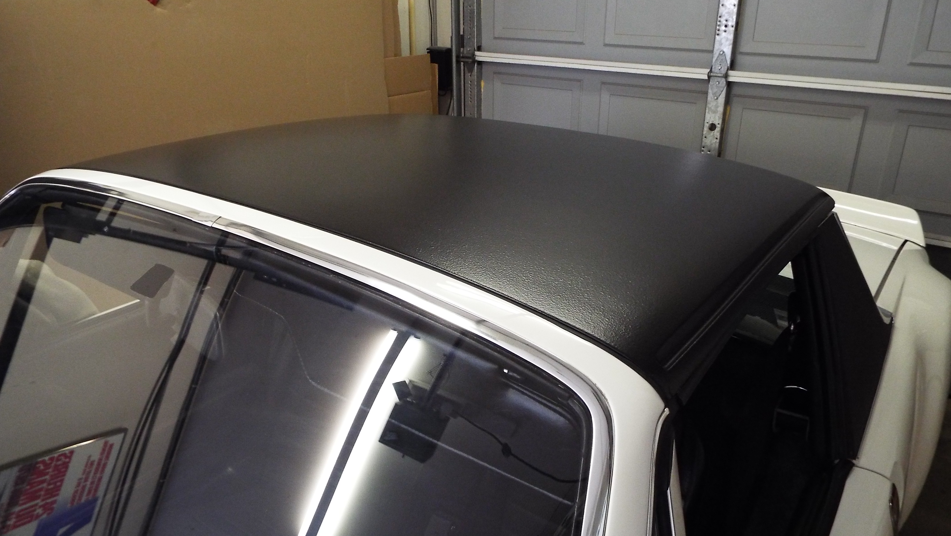

Had great results with SEM Trim Black. Cleaned top with Prep-sol, no sanding, no primer, just right over the existing texture that was there. Provides a nice sheen but not shiny.
You must keep a wet edge, which is difficult with a rattle can, but can be done. You will need 2-3 coats.
Have received lots of complements on it. Good luck!
(IMG:style_emoticons/default/driving.gif) (IMG:style_emoticons/default/white914.jpg)

QUOTE(Lucky9146 @ Aug 23 2020, 10:01 PM) *
That really looks nice! SEM stuff is good.

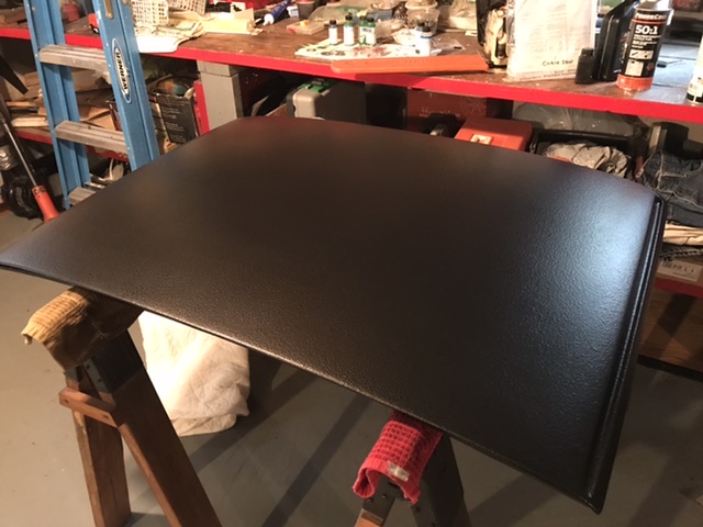

Refresh done!
Followed suggestions posted here. Used liquid sandpaper to degloss, Simple Green followed by substitute TSP, SEM spray prep solv (1/2 can for 3 wipe downs), and SEM satin trim black (2 light coats followed by 1 medium coat; just short of one can).
Whew! Pleased with result. Was nervous about messing up the top.
Fortunately, texture was still fine.
