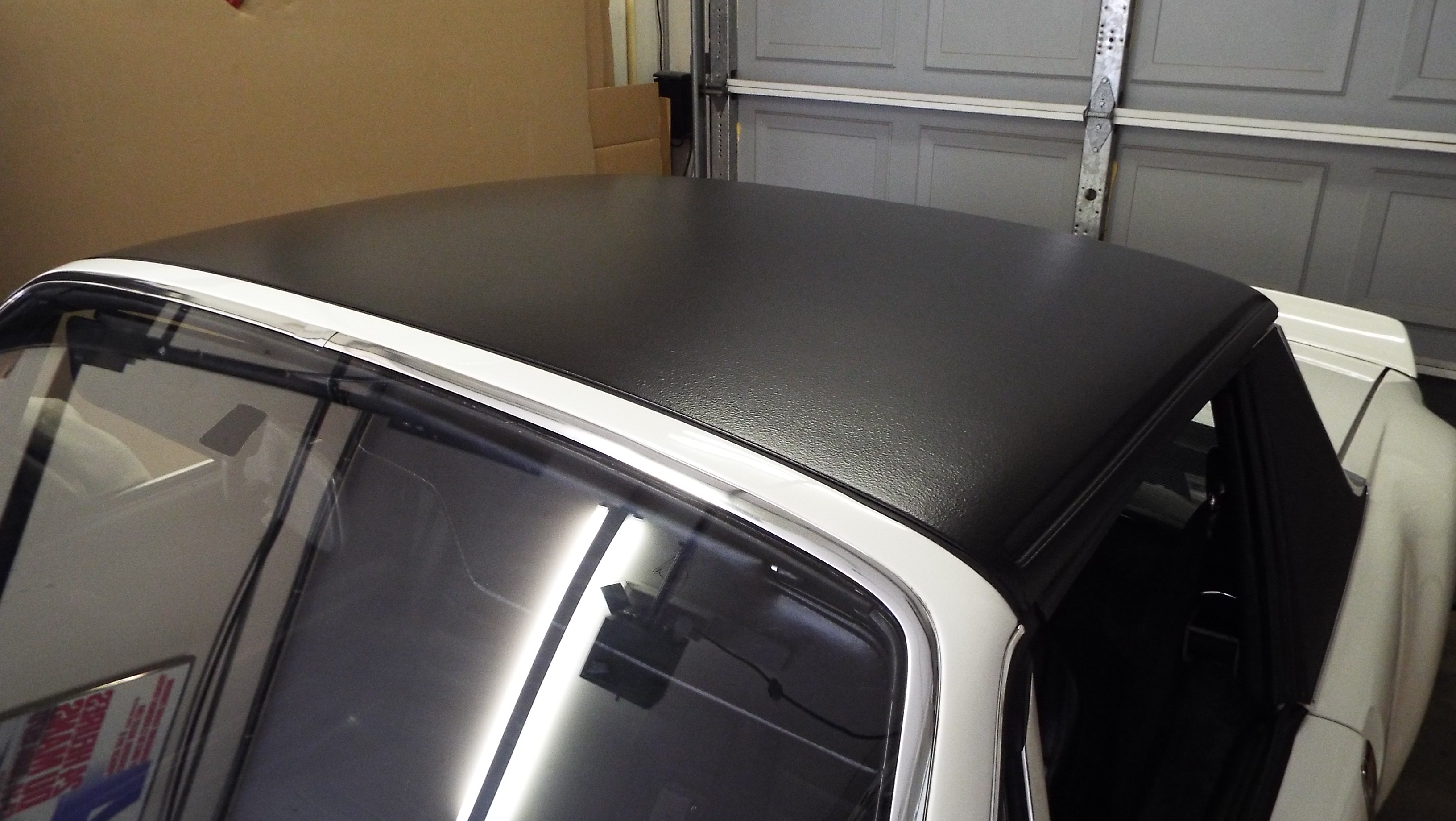

Had great results with SEM Trim Black. Cleaned top with Prep-sol, no sanding, no primer, just right over the existing texture that was there. Provides a nice sheen but not shiny.
You must keep a wet edge, which is difficult with a rattle can, but can be done. You will need 2-3 coats.
Have received lots of complements on it. Good luck!

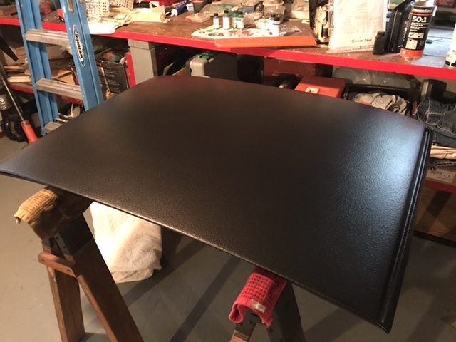

Followed suggestions posted here. Used liquid sandpaper to degloss, Simple Green followed by substitute TSP, SEM spray prep solv (1/2 can for 3 wipe downs), and SEM satin trim black (2 light coats followed by 1 medium coat; just short of one can).
Whew! Pleased with result. Was nervous about messing up the top.
Fortunately, texture was still fine.

Not nearly as scary as I thought it would be. That SEM spray prep solve worked great - easy to use and the spray gets in all those tiny depressions. Use OUTSIDE or in well ventilated area, though; NOT water-based! driving.gif

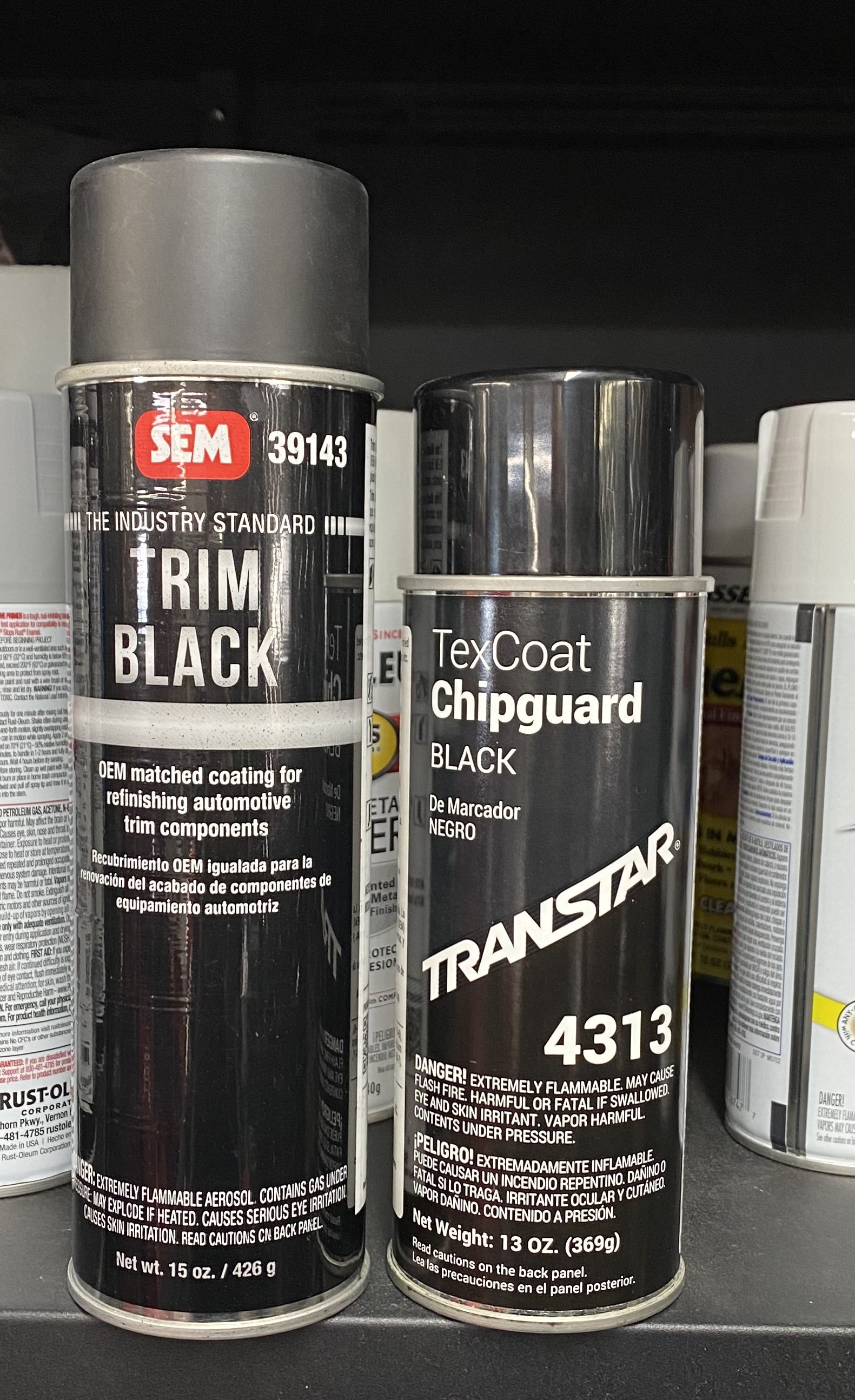

If needing retexture, suggest this product. Can knock it down with sanding to get just the right texture- likely two cans needed for the whole top if starting from a smoothly sanded state.
SEM black pictured overall a good sheen and black tone match for our 914s.
Highly recommend compatible SEM primers if not going with a 2k primer.

No trouble keeping a wet edge with the SEM spray. It has a bit of a vertical spray pattern. Used the SEM trim instead of the Wurth as the SEM can suggests no primer needed if base in good shape and prepared (scuffed and deglossed, I interpreted).
