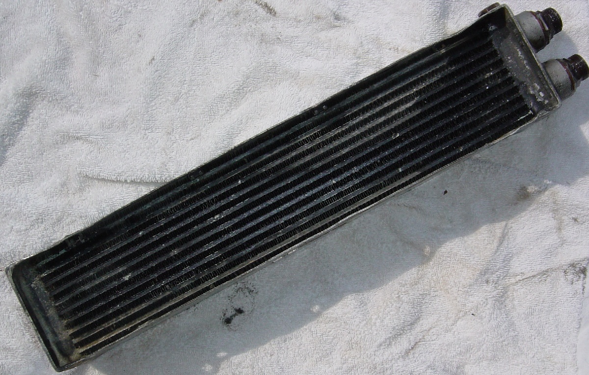

Hey - I extracted one from a Mercedes 300D in the local pick n pull. It sits vertically in the Mercedes, but fits nicely (horizontally) in the GT style front mount shroud area. The fittings are each end and metric, and you'll have to fab up your own mounts, but otherwise its a functional, high "value for money" option. Made by Behr as well, keeping that Germanic flavor to your freshly cooled oil.
FYI,
- Tony
Retroracer

Tony, what are the dimensions of this Mercedes 300D oil cooler. Any particular years.

Youre on to something with the Behr 300D cooler. Dimensions check out and used on EBay under $100, even new aluminum version only $250. Much better. Thanks

QUOTE(davep @ Aug 31 2020, 04:48 PM) *
What I found was Behr part #1261800065. 4” tall by 17.5” wide cooling area. Tanks look to be about 1.5 inch so overall width 20.5” approx.

QUOTE(Retroracer @ Sep 1 2020, 10:51 AM) *
Another pic:
- Tony
(IMG:style_emoticons/default/agree.gif) excellent choice ,when buying used get it cleaned ,you can soak it in a bath or get a ultrasonic clean which is best,amazing the shit that comes out after years of use.
Diesel cars coolers tend to get really dirty which reduces oil cooling,petrol cars to a much lesser extent.

There are at least three different heights used on diesel Mercedes. Ranging in height from 2.75 to 5 inches in height.

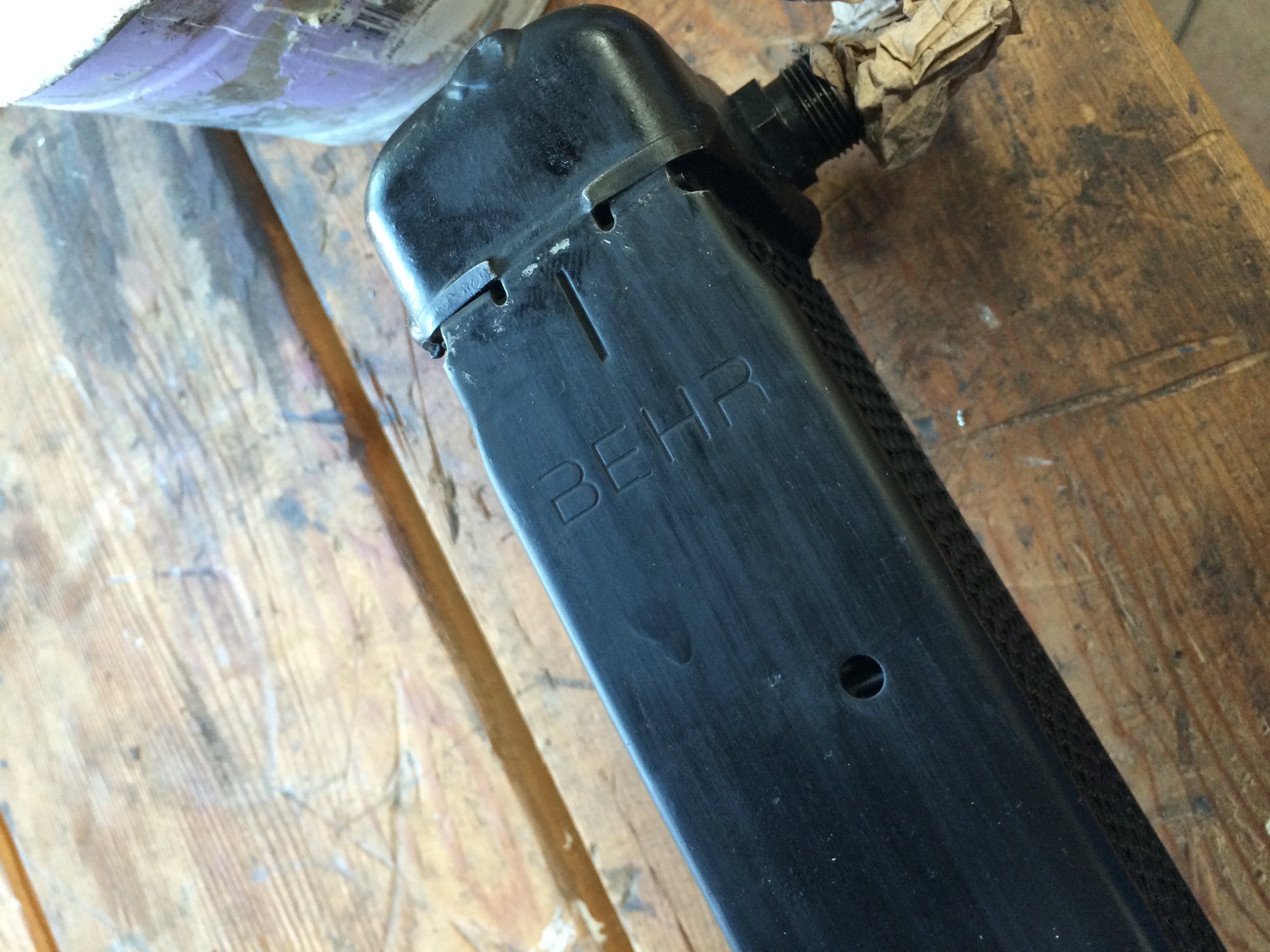

@Montreal914 - looks like a smaller version of the one I have. Attached shot shows part number as well:
@davep - the dimensions are (roughly) 20" wide and 4" high. It fits in nicely in a GT shroud without having to make cuts.
