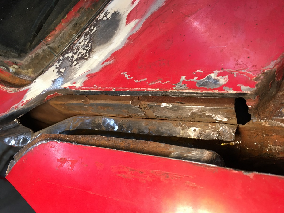

I am trying to understand the construction of the rear part of the fender, more precisely the area joining the front cowling.
Below is a sketch of how I think it is made but i would like someone to confirm...

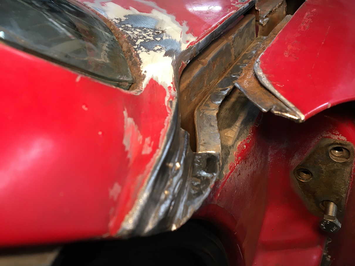

Having removed the seam sealer in the upper rear area, I have discovered "this" (IMG:style_emoticons/default/dry.gif) which is not really unusual, but clearly a pain to fix. I am not sure though what I am looking at. If my sketch is correct, I guess the inner rusted layer is from the fender rear bulkhead that actually becomes an inner layer on the rear upper point of the fender by the door and cowling junction.
I might be able to cut this from the underside preventing me from cutting the outer surface of the fender. But I would like to better understand what is happening at the junction to the body.
How many layers are there from the fender, one or two?
Is the metal peeling off at the joint to the body the metal from the bulkhead/inner layer, or is it the outer fender layer?

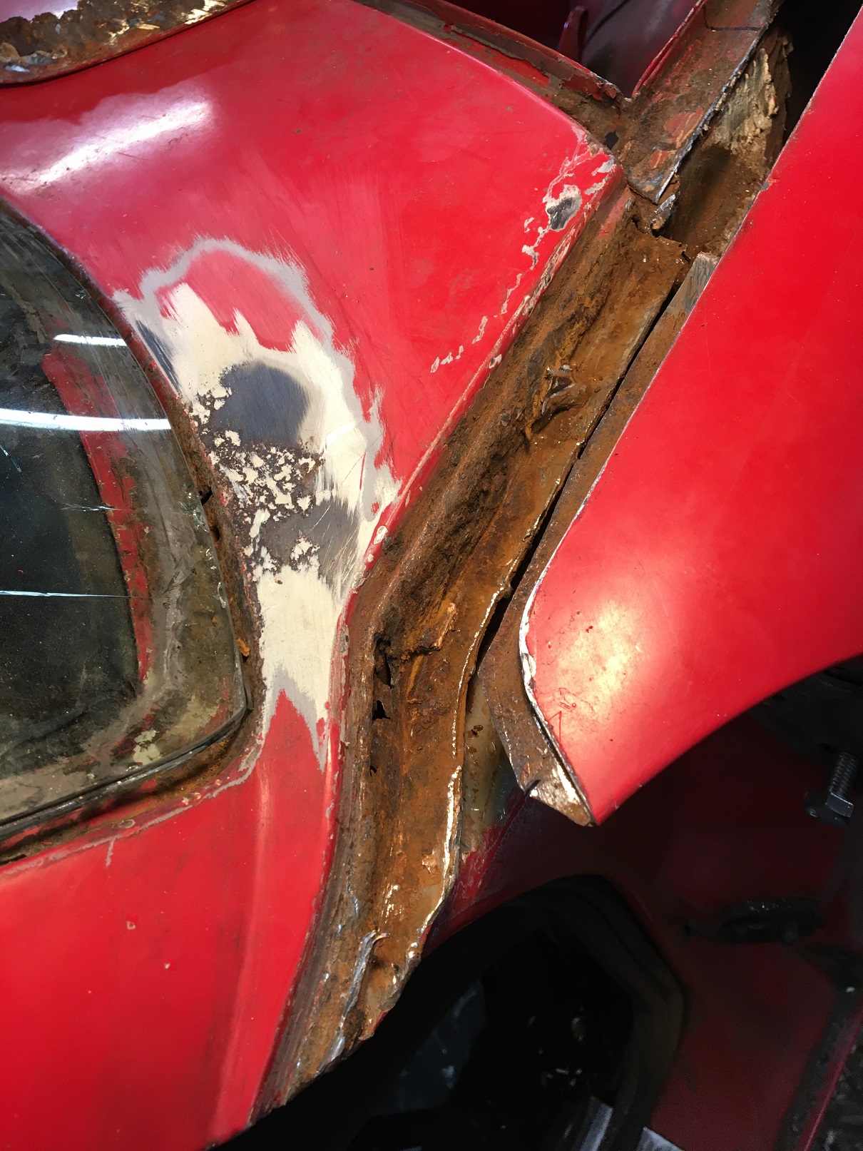

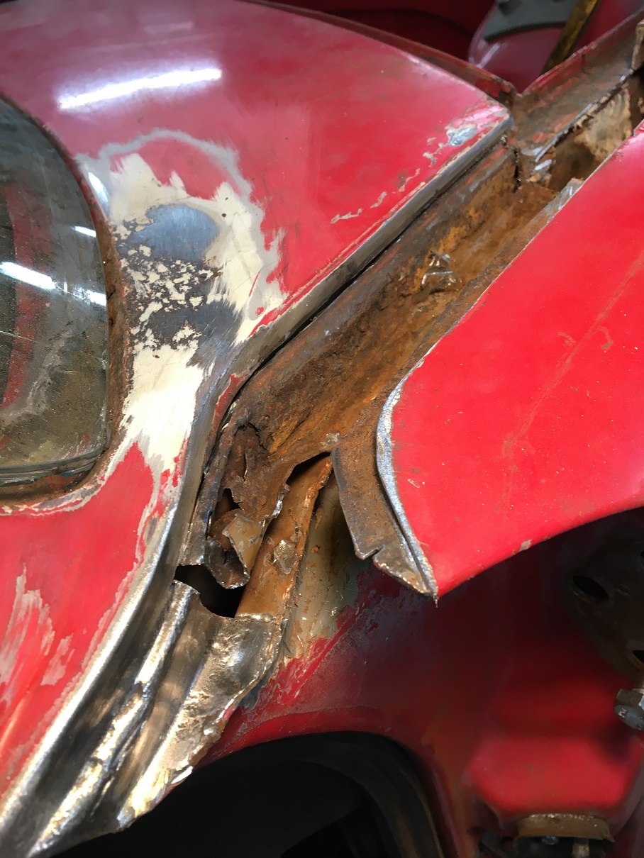

As a reference, this if the situation of the channel, surface rust, but how bad? Is there a way to better know without destroying? Maybe poke with a screwdriver? (IMG:style_emoticons/default/confused24.gif)
Comments appreciated (IMG:style_emoticons/default/smile.gif)
cary
post Oct 24 2020, 06:32 PM
Posts: 3,900
Joined: 26-January 04
From: Sherwood Oregon
Member No.: 1,608
You got it.
http://www.914world.com/bbs2/index.php?s=&...t&p=2848611
http://www.914world.com/bbs2/index.php?s=&...t&p=2550335
http://www.914world.com/bbs2/index.php?s=&...t&p=2549481
http://www.914world.com/bbs2/index.php?s=&...t&p=2546557

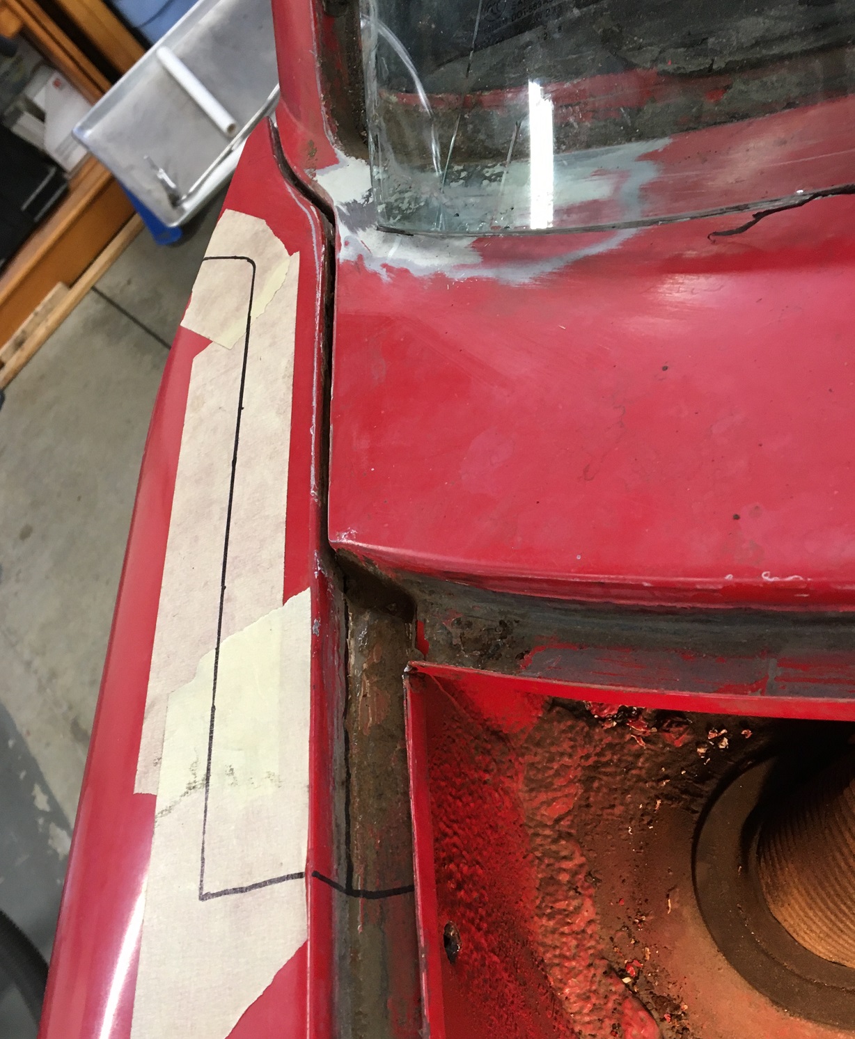

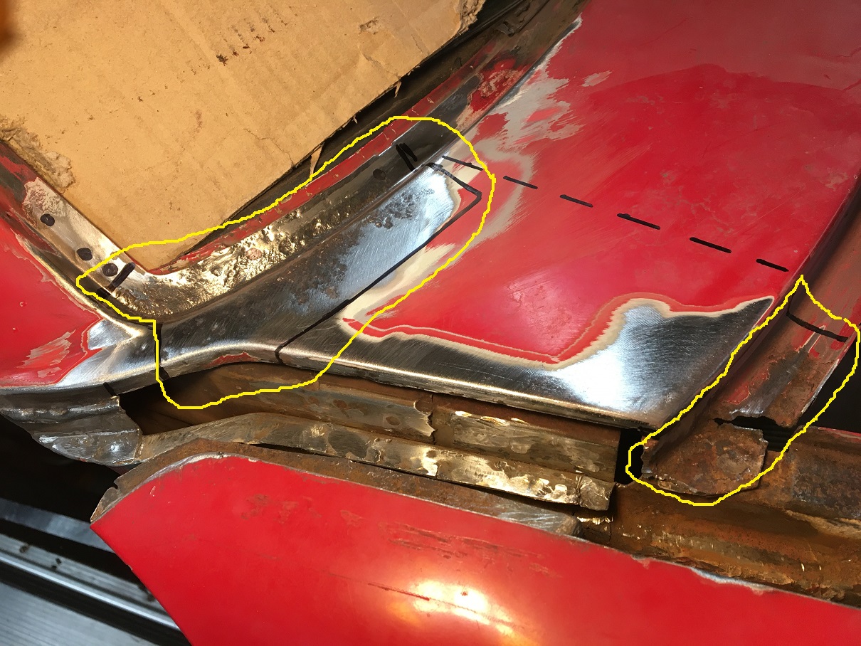

Today's update. After carefully studying Cary's pictures (IMG:style_emoticons/default/smilie_pokal.gif) I dove in (IMG:style_emoticons/default/sawzall-smiley.gif)
No big surprises here.
At his point the cowl corner needs to be addressed at the fender junction, at the front trunk seal, and under the windshield area. I think my best bet is to get both or these replacement parts as a foundation for the repair.
Any comments one the fit of these?
cary
post Oct 25 2020, 04:28 PM
Posts: 3,900
Member No.: 1,608
Looks good. Full speed ahead.
I didn't know George even made that piece. Not in Body Sheet Metal section.
I'll do some digging. Lionel has it in their Ebay store.

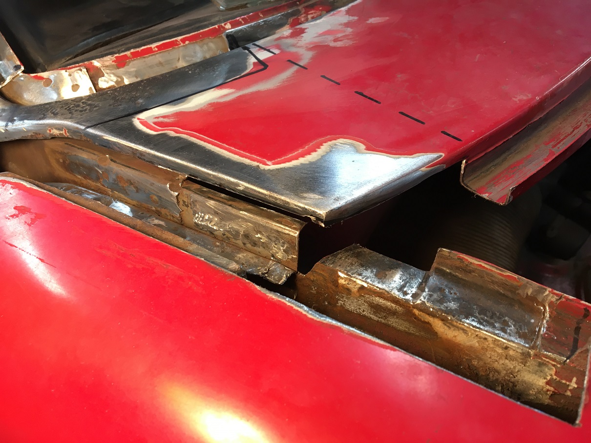

I worked a couple of hours last night and began to look for solid metal at the junction of the fender with the cowl.
This is after a cut below the fold of the cowl. If I need to go above it I will, but I would rather weld-in the new piece in this hidden area.
After the rusted metal was removed, I now have a decent shelf for the new piece to rest on and a nice clean metal in the vertical section of the cowl joint to the fender. Obviously, there will be more prepping before reconstruction.

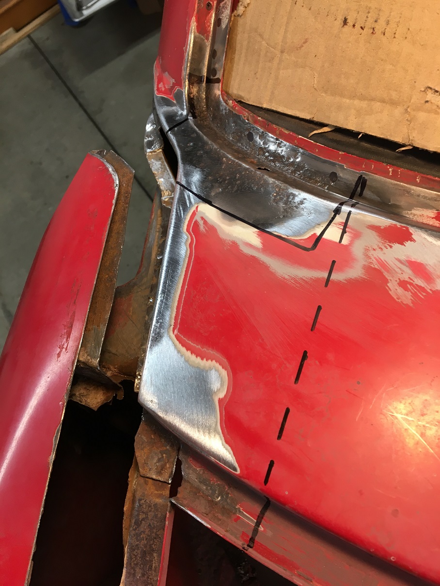

A little more cleaning up tonight. Looking at the situation I am considering 2 options (IMG:style_emoticons/default/idea.gif) but which one would be the best... (IMG:style_emoticons/default/confused24.gif)
@cary I really value your advice. What would you recommend? Cutting across per dashed line, or a patch work?
For the patching option, the trunk seal area would get cut out the same way as the fender to cowl to hide the weld. In the windshield area I have to go on the finished surface (IMG:style_emoticons/default/sad.gif) , unless I Ospho the surface and do the cut in an area where the windshield trim will hide the welds, but that seems like a half job since I am already way deep in this. (IMG:style_emoticons/default/sad.gif)
Comments appreciated (IMG:style_emoticons/default/beerchug.gif)

cary
post Oct 28 2020, 08:26 AM
Posts: 3,900
Member No.: 1,608
I'd wait till you have the new patch panel in hand. To verify mold and size.
I'd take the section that attaches to the windshield frame out with a couple more cuts.
That way you can lightly touch the spot welds on the glass channel with the right angle die grinder and peel them back.

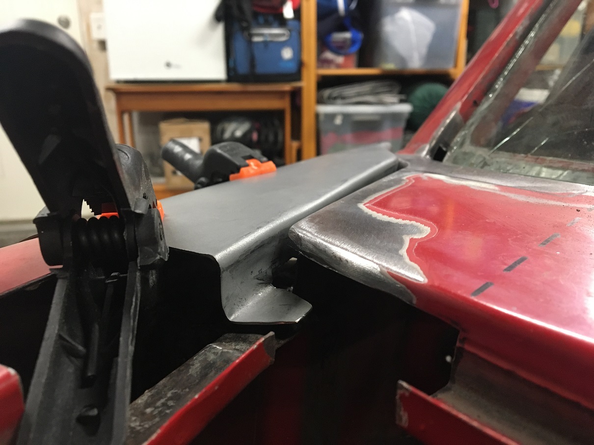

Did a little work this WE. I removed some metal in the windshield corner area while waiting for the repair sheet metal that should arrive Wednesday. I still haven't removed the pitted area, but I am leaning towards cutting the solid marker line, not the dashed one in hope to better keep the overall line of the cowl.
We can see the factory reinforcement layer in the windshield frame corner. I didn't touch that piece, the cut is factory.
Then I removed the rusted metal in the cowl corner to the trunk seal area. This is basically ready to receive the repair sheet metal piece after some Ospho and protection.

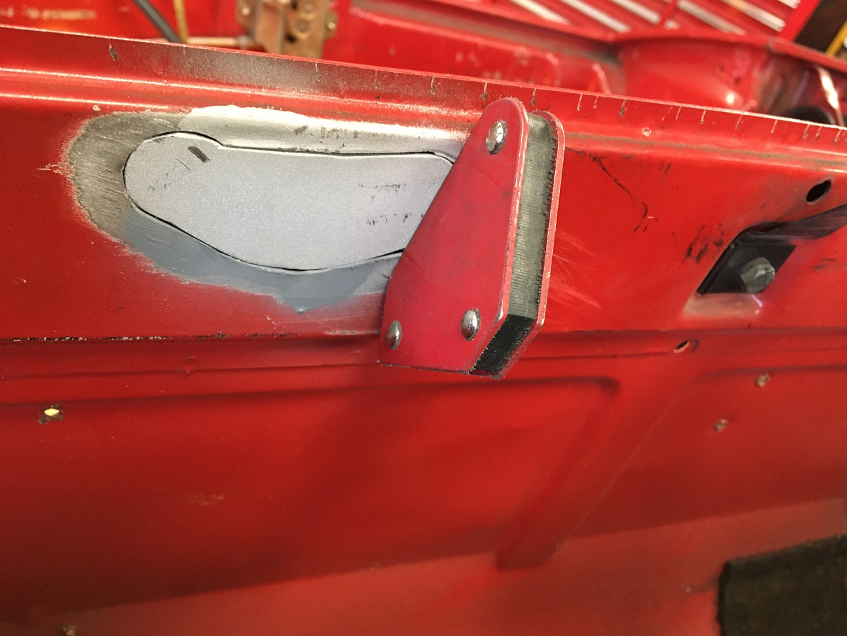

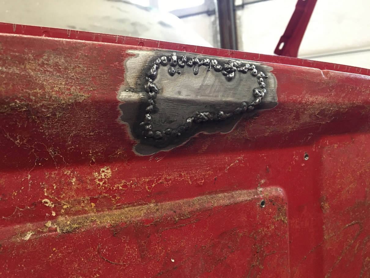

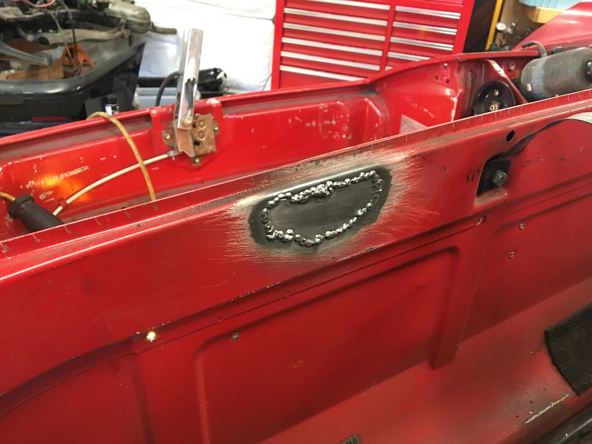

I moved on to repair some DAPO chassis weakening done to run the wiring to a very important piece of equipment (IMG:style_emoticons/default/rolleyes.gif) , an amplifier mounted on the bulkhead in front of the tank...
Before;
Prepared the patches to fit in the 2 holes, file, adjust, try, and again, until good fit...
The bulkhead is actually thin metal ~0.030" while the back side of that beam is closer to 16 ga. Luckily, I had pieces of metal of the same thicknesses. (IMG:style_emoticons/default/smile.gif)
Bulkhead layer patched:
Then the back side (tank side) of the cross beam piece.
Small steps... (IMG:style_emoticons/default/smile.gif)

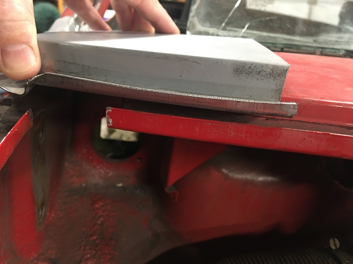

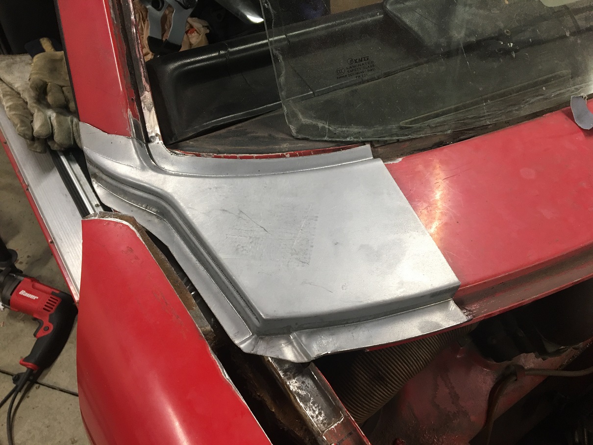

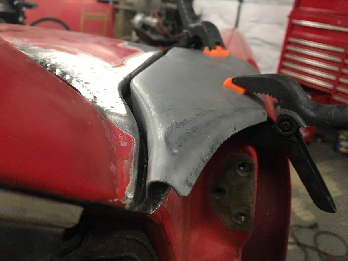

Yesterday I received my sheet metal repair pieces, the cowl and rear top fender parts.
The cowl piece is pretty nice and I am still wondering what should be my best approach with this. I can keep as much original metal to the car and cut all up the repair panel to patch the various areas, Or cut straight across the car's cowl and install about half of the width of the repair piece. (IMG:style_emoticons/default/idea.gif)
Here are a few pictures of the cowl piece.
Here we can see that hey could have been more generous on the front fold for the trunk seal. I will need to extend that lip a little.
Last one showing the line where I could cut the new piece to repair the damaged sections of the car, otherwise, just use the left (car orientation) half of the repair piece and cut the car up.
Moving on to the fender repair panel. This one is made for Auto Atlanta but is not the same quality as the cowl piece. The part was bent of hit or something as you can see. Also, the curved outside edge that will create the door gap is not folded. This will be a challenge (at least for me) to fold while creating the proper curve that will define the front top door gap.
Definitely open to suggestions here...
In this angle you can see the damaged area of the part which lifts up the back side of it... (IMG:style_emoticons/default/dry.gif)
I would like to tackle the cowl repair this weekend, but before that, I need to decide how. (IMG:style_emoticons/default/headbang.gif)
Open to comments/suggestions. Thanks! (IMG:style_emoticons/default/beerchug.gif)
cary
post Nov 6 2020, 12:08 PM
Posts: 3,900
Member No.: 1,608
Your now into what we/I call the art of massaging patch panels. Almost all need
tuning.
Give us a shot of the fender patch flipped over.
