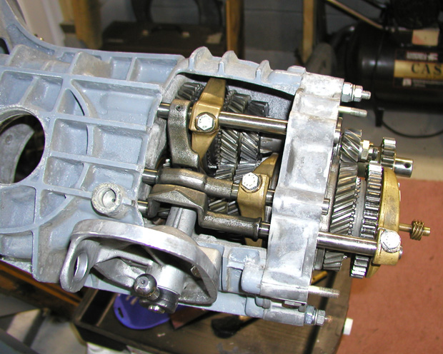

If you are lucky enough to have a core transmission you can pull the intermediate plate out and clean it up. You need to pull out the old bearings.
If you want to make one yourself the intermediate plate serves as a great template

QUOTE(Mark Henry @ Nov 7 2020, 09:55 AM) *
Thickness doesn't matter.
If you're working on the cheap you can just cut it out of an old trans case.
(IMG:style_emoticons/default/sawzall-smiley.gif)
Actually, an old trans case works better than the jig. Here is a thread from years ago that shows it in detail:
http://www.914world.com/bbs2/index.php?showtopic=25856
Clay

This is the most accurate way to align the shift forks, just cut out the area from an old case with a hack saw.
