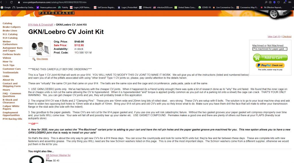

So don't bother cleaning/inspecting/measuring the best "old one" out of both recently purchased axles . . .just buy one pre-machined GK cv joint kit from PMB (feels like 3 out of 4 of my original ones are good)?

Yep...that'd be my course if I were you.
BTDT. PMB and I think Chris at Tangerine can do the whole smear...I think.
I tried saving my first set and I had one that was bad....howled and was old.
It is just a nasty job and why go there more than once?
Do the whole drive train and never do it again.

QUOTE(pete000 @ Dec 3 2020, 11:10 PM) *
Regarding non-914 cv joints - since there's no machined recess for the gasket, wouldn't I need to use a sealant?
And doesn't that increase the risk of grease leakage/joint failure?
914_teener
post Dec 4 2020, 10:26 AM
Posts: 5,270
Joined: 31-August 08
From: So. Cal
Member No.: 9,489
QUOTE(MM1 @ Dec 4 2020, 07:31 AM) *
Leakage yes....failure probably not. It'll just splatter some grease up on the body.
Think of it as rust repllelant.
Like PMB states though....don't use the gaskets unless there is a recess for them.

I have used a glue hypo and put a small bead of RTV around the edge of the metal boot retainer.
You could also put a bead around the edge of the gasket area to lessen the grease thrown up on the body.

(IMG:style_emoticons/default/agree.gif) & those (Jbugs link) still wont work until machined as they havent the larger reliefs for locating roll pins regardless of the gasket
