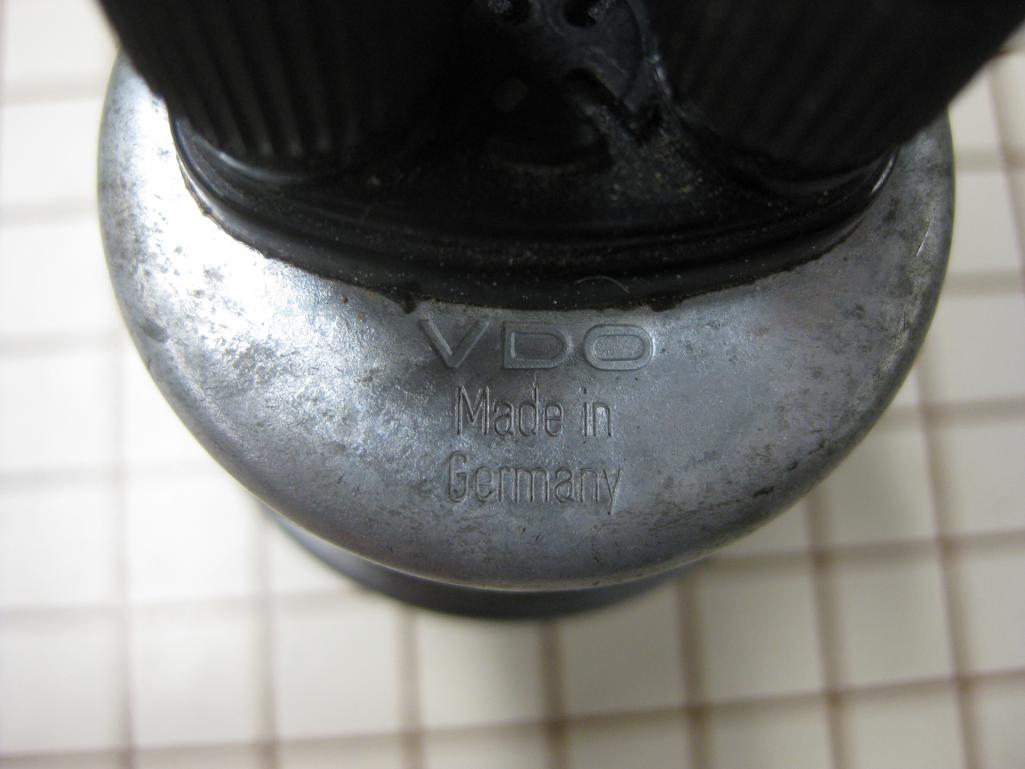

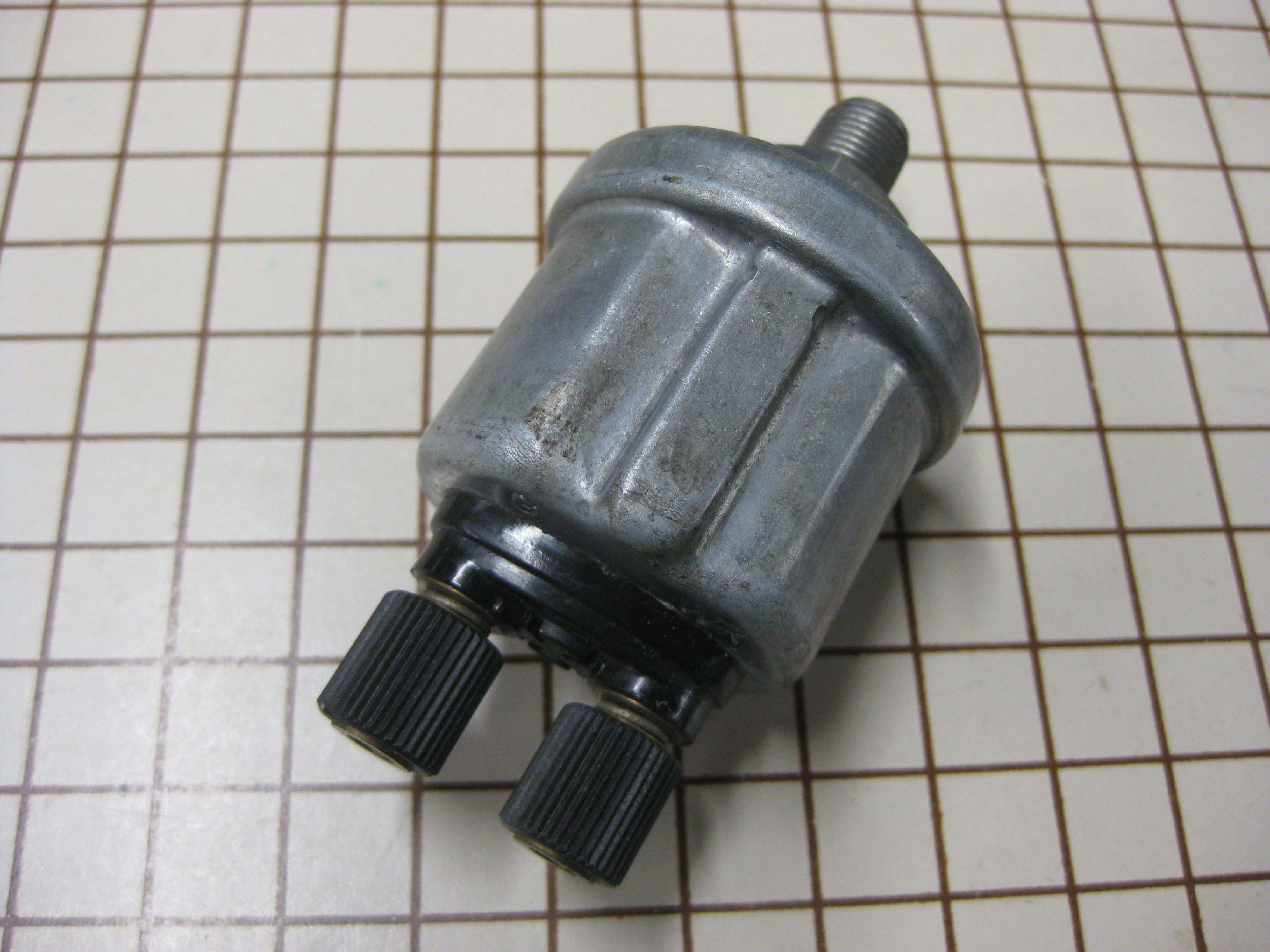

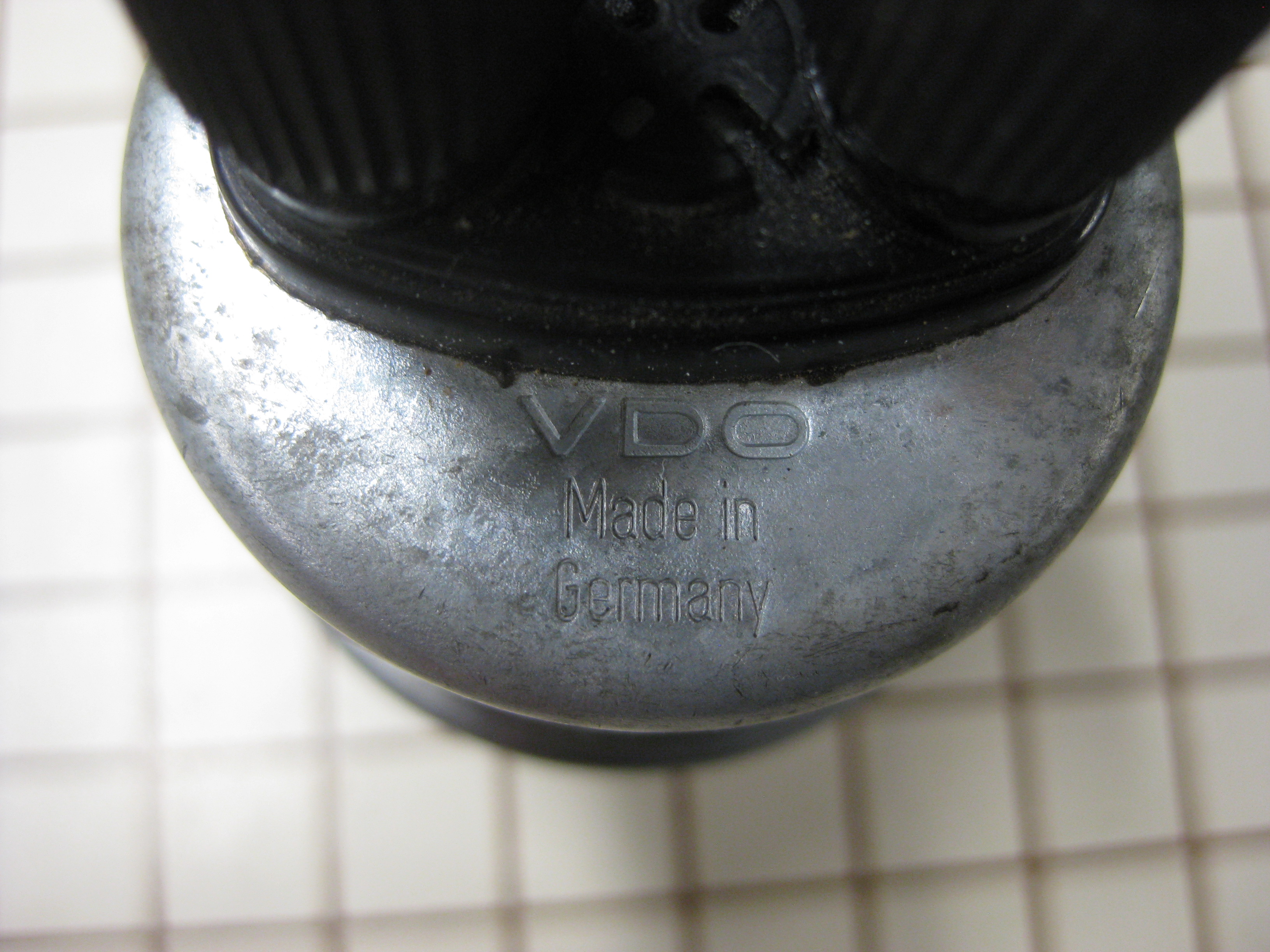

BillJ
I have this good used VDO made in Germany sending unit available if interested.
$27 shipped to you in CLT
Thanks

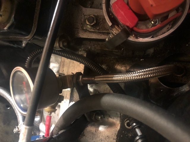

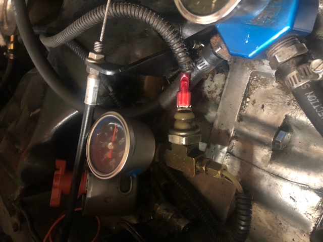

I set up a Paint Ball hose and put a 3 Way at the end of it. It has the original Dash Light fitting and a pressure gauge in the engine bay and a Line for my VDO Pressure gauge in the console. I would include some Pic's but I'm on the road.

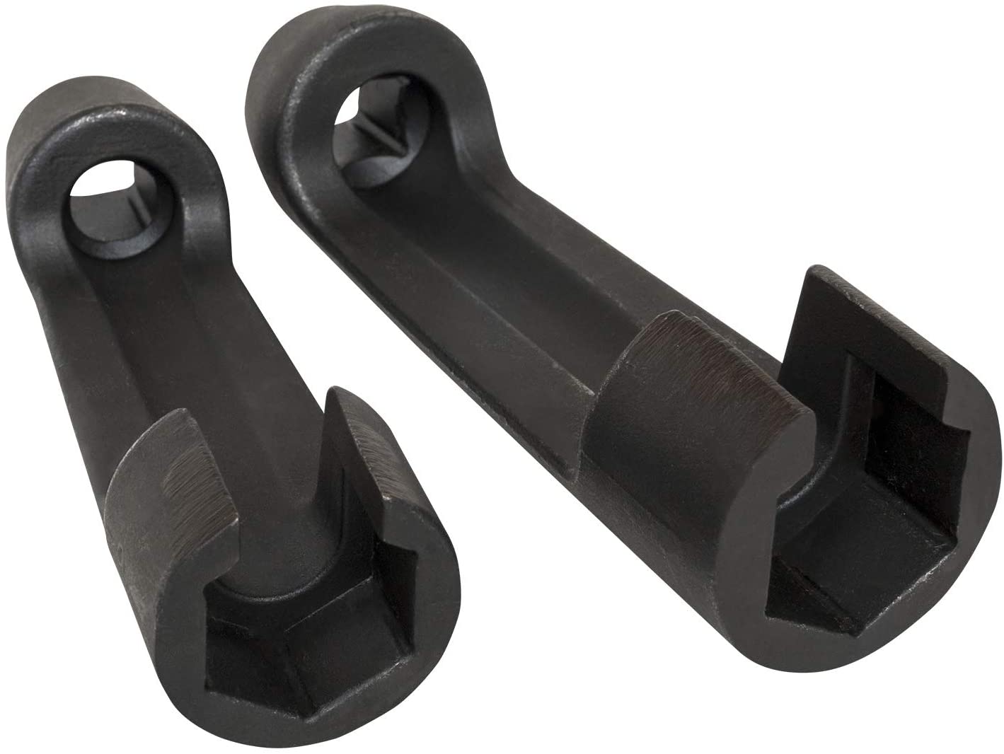

FlacaProductions
post May 12 2021, 07:02 PM
Posts: 2,176
Joined: 24-November 17
From: LA
Member No.: 21,628
I may be doing this install next week and the engine will be in - which means tight access.
Think it's possible to use a line socket to install the Level 42 Designs remote hose? Just trying to figure out how to get a wrench through the tins and i'm not sure a crows foot will do it.

QUOTE(FlacaProductions @ May 12 2021, 09:02 PM) *
something like this:
Those ARE nice! Where can you get them? And 42 Design?

QUOTE(euro911 @ May 12 2021, 10:40 PM) *
Those look like they'd work for great the CHT sensor installation/removal/replacement (XX-mm) ... not sure if you'd need one for the oil pressure sensor (IMG:style_emoticons/default/confused24.gif)
wouldn't need them for the stock oil pressure sensor, no - I'd need it for the installation of the hose in that same hole (obviously) for a remote oil pressure sender. it's gotta be tight with the engine in and the tins on. my real issue is that i'm in a different state than my 914 and i only get short bursts of time to mess around with it so i have to try to visualize and plan do research while I'm away.
search "line socket" and the appropriate size and you'll find options.
that pic came from amazon but there are numerous sources.

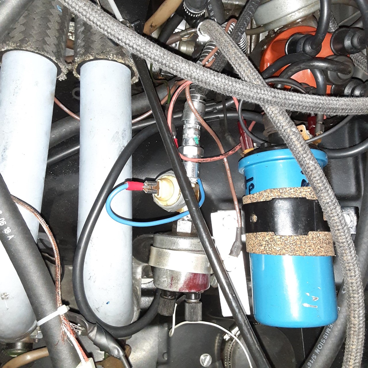

Hi @BillJ , thought I'd post a picture of what I did. Before you hook up the idiot light sender, you might want to put a mechanical gauge on that port to compare to your VDO electric gauge. Just as an example, I was getting 4~6 psi at hot (215F) 1000 rpm idle on the VDO while I was getting 12 psi on my mechanical gauge. The VDO seems to read low throughout the range. Not a big deal, just nice to know you have oil pressure even though the gauge may not indicate so (at low rpm and hot days). If you're curious that's a 928 brake line.

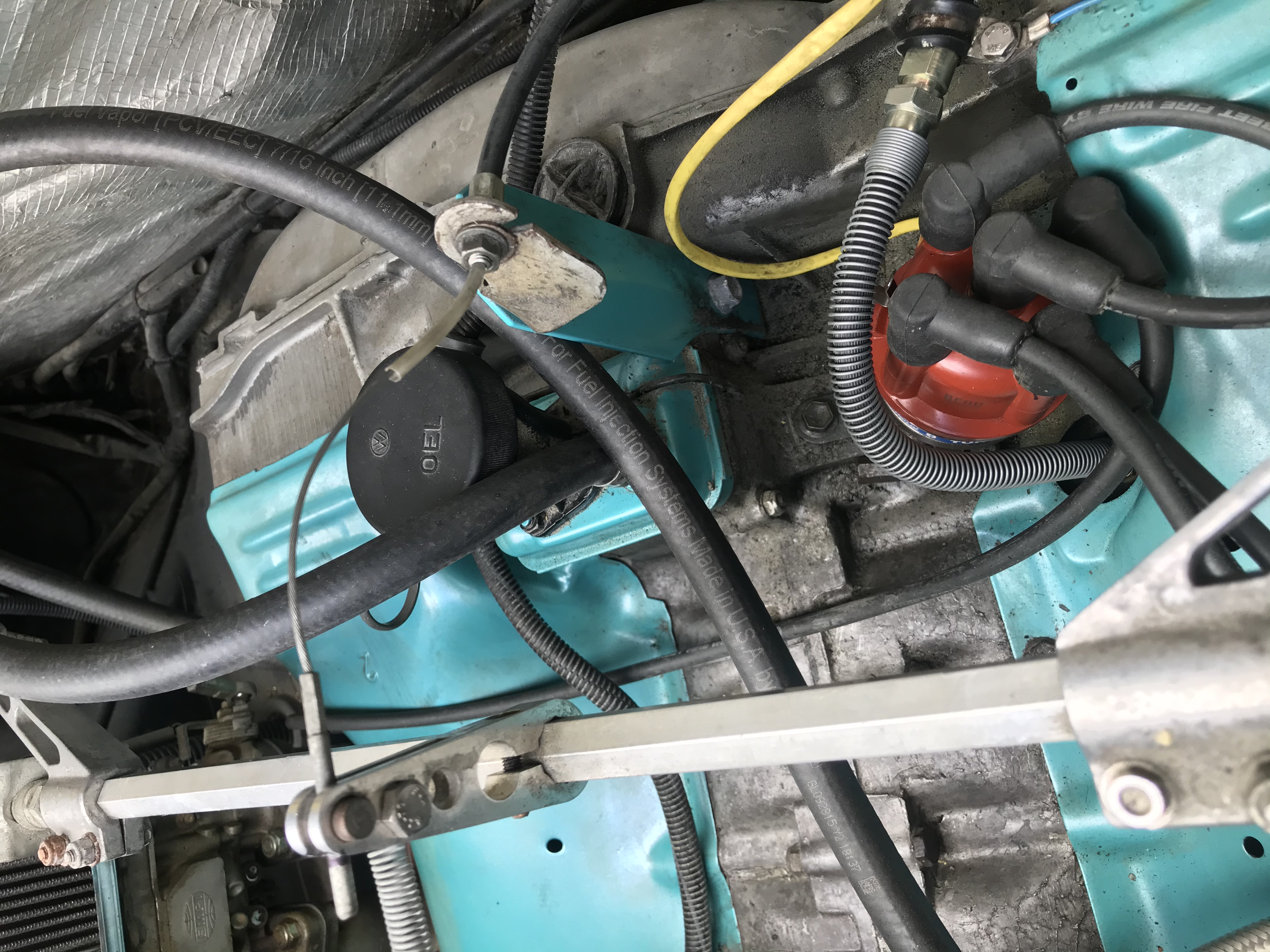

Pictures of my set up for both plus 1 in the engine bay
