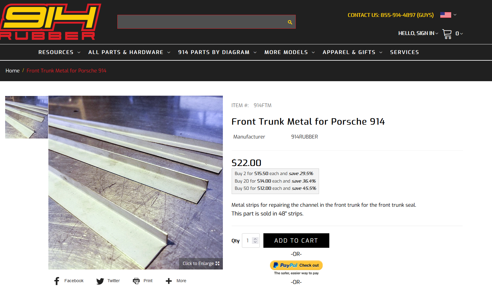

We replicated the metal so that you could drill out the spot welds and replace.
https://914rubber.com/front-trunk-metal-for-porsche-914
Hope this helps

QUOTE(Mikey914 @ Jul 14 2021, 09:35 PM) *
Hope this helps
Man, you guys are awesome ! (IMG:style_emoticons/default/pray.gif) I will be placing an order for sure. I was thinking I'd have to half ass it.
Does it get tacked in one direction, then over-lap to create the second 'lip' ?
Also - does it bend to form the nose curve or does it need to be snipped, or..?
THANKS.

It lays down just like factory metal does so you can really just drill out the spot welds. Yes you will have to cut and form it to fit. Cary uses this all the time. One of the reasons we made it.

@Mikey914 are they curved?
@Literati914 the upper half of the channel is the top edge of the front bulkhead, so if the top part is bad, it takes a little more work
Yes, that's what I wasn't quite understanding.. I may need to use this to 're-build' some of the under/upper section before adding it to recreate the top/front lip sections. I'm glad to see it's available.

They are not curved.

The nose needs a few soft bites on the shrinker. I mean really soft.

I used the 914 Rubber pieces, and got pretty good results. I was able to induce a bit of curvature with hand hammering to expand the outer edge of the short side.
