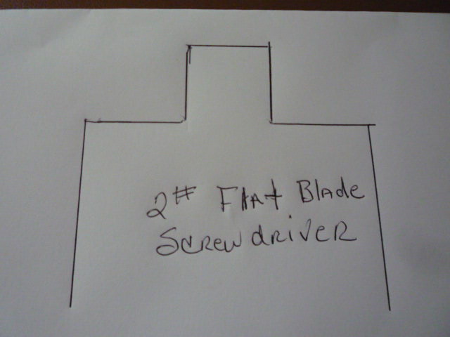

just replaced all the parts of my shifter and having a tough time getting the springs back in. Anyone know an easy way to get it done?
Thanks

Here is your answer. Take an old worn out #2 flat blade screwdriver and notch it out as shown. This tool will let you compress the spring you can move the pin into place.

I use a Phillips screwdriver and vice grips, use the screw driver on one side, pin on the other. Push the spring into place with the vice grips and push out the screwdriver with the oem pin. Takes 30 seconds once you get the hang of it and the vice grips will keep the spring from flying if you mess up.
But wear the glasses anyway.

Thanks for the tips 914sixer & mepstein!! I'll give it a shot again later.
