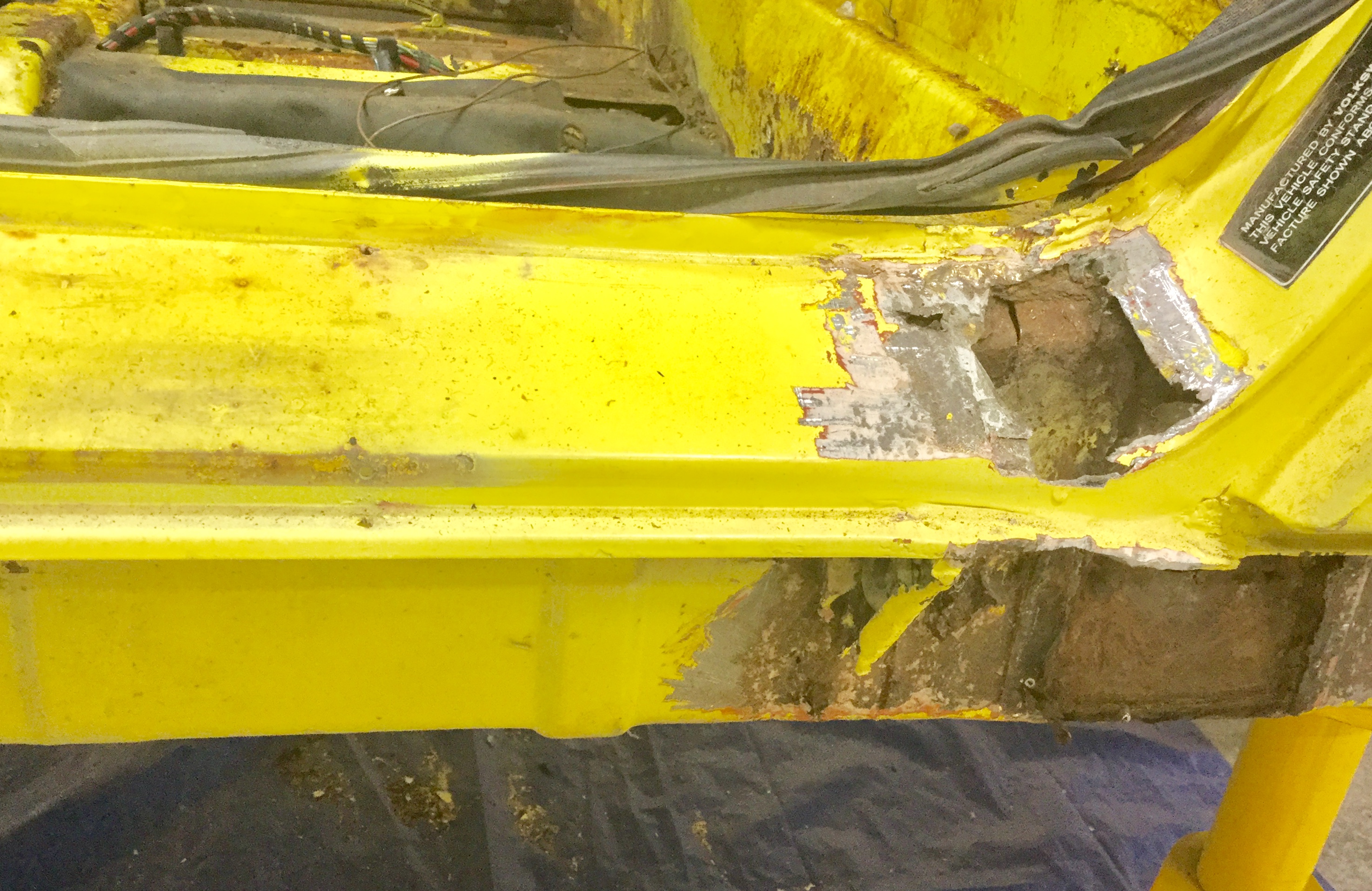

Outside of jack pad area looked a little roughAttached Image

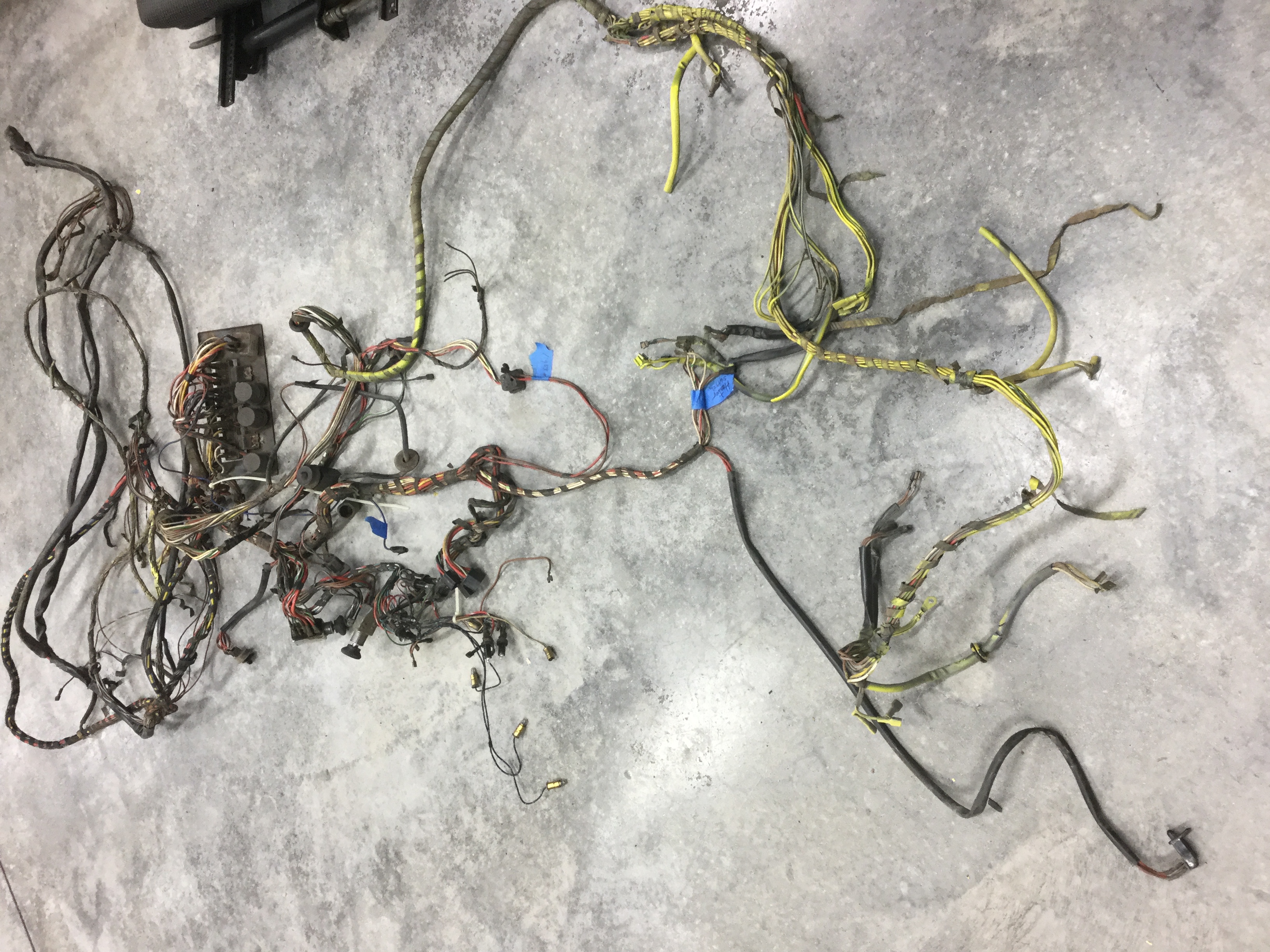

I even yanked out the old crusty wiring harness. I’ll be replacing it with my own custom harness which will be much simpler and lighter. Going to use GT style cables on the headlights, so I will be eliminating the front headlight motors, etc.

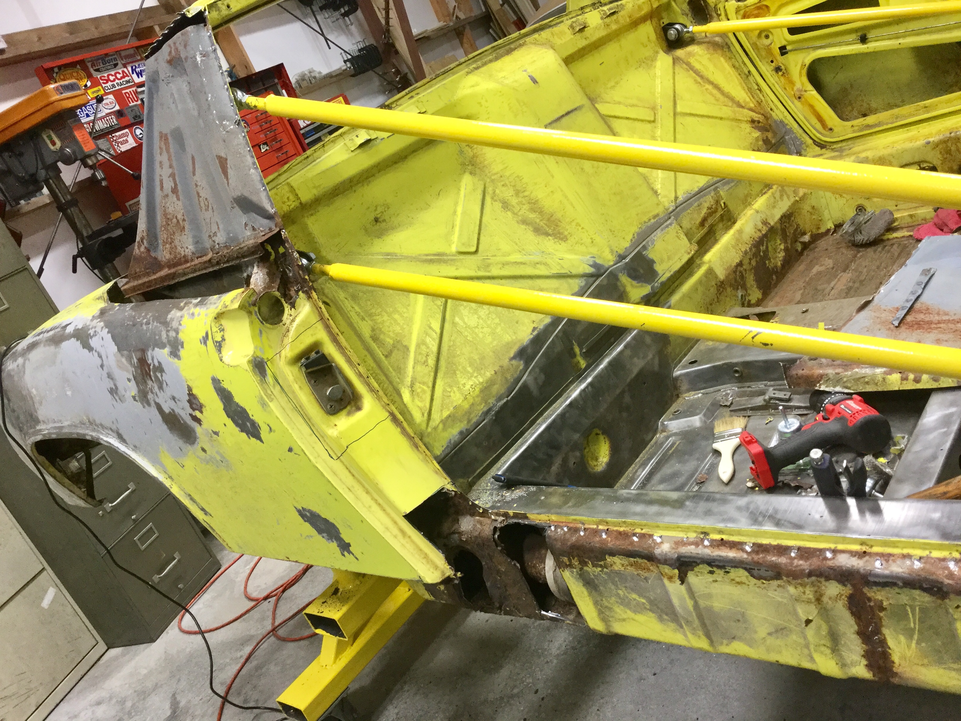

Went ahead and made up some door opening braces. I mounted them inboard so I can still fit the doors on the car while the braces are in.Attached Image

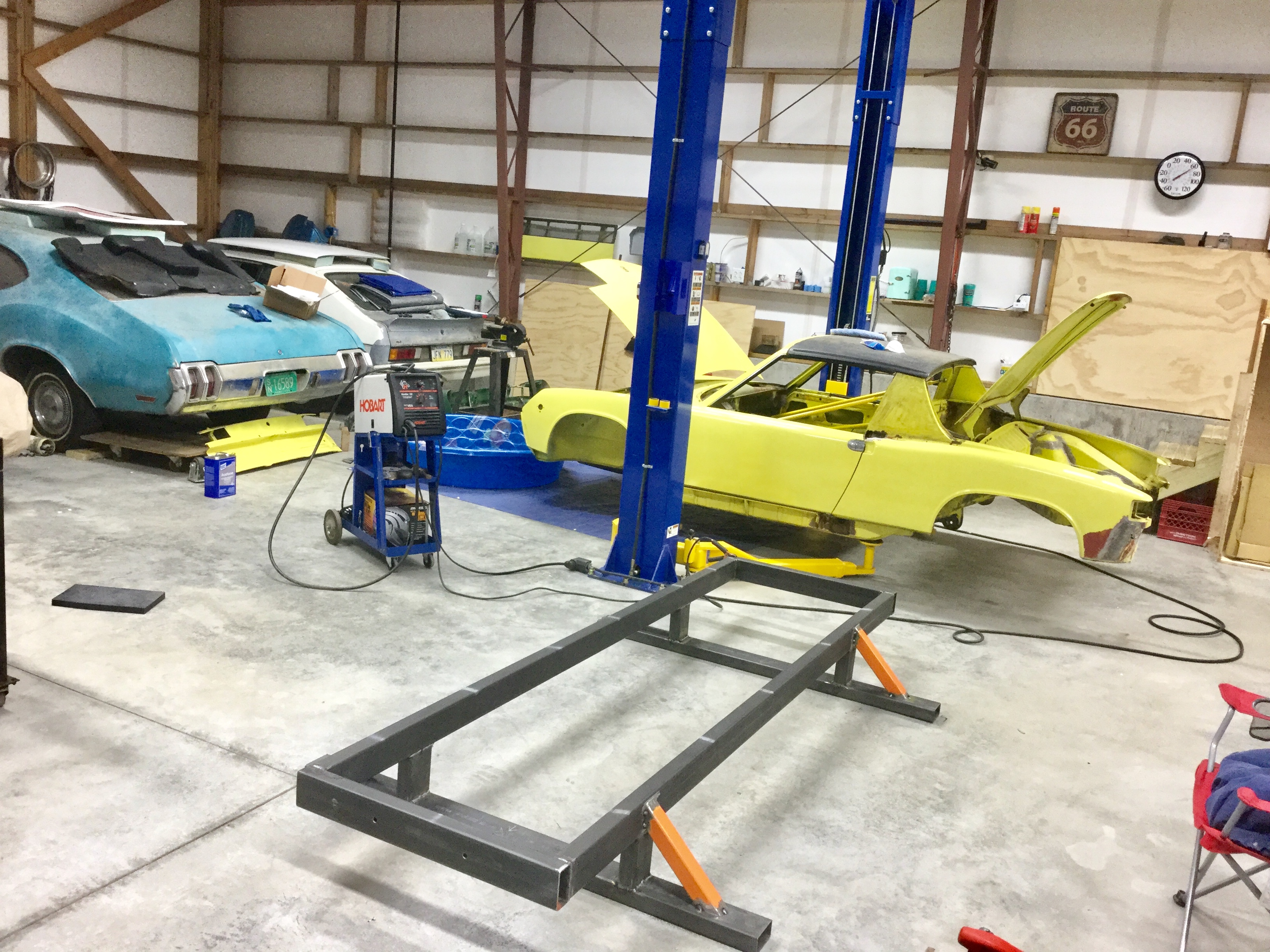

Starting to make cross braces and supports for a cart for the car. Borrowed the idea from I believe ,MR Hall’s build here.Attached Image

Cart constructionAttached Image

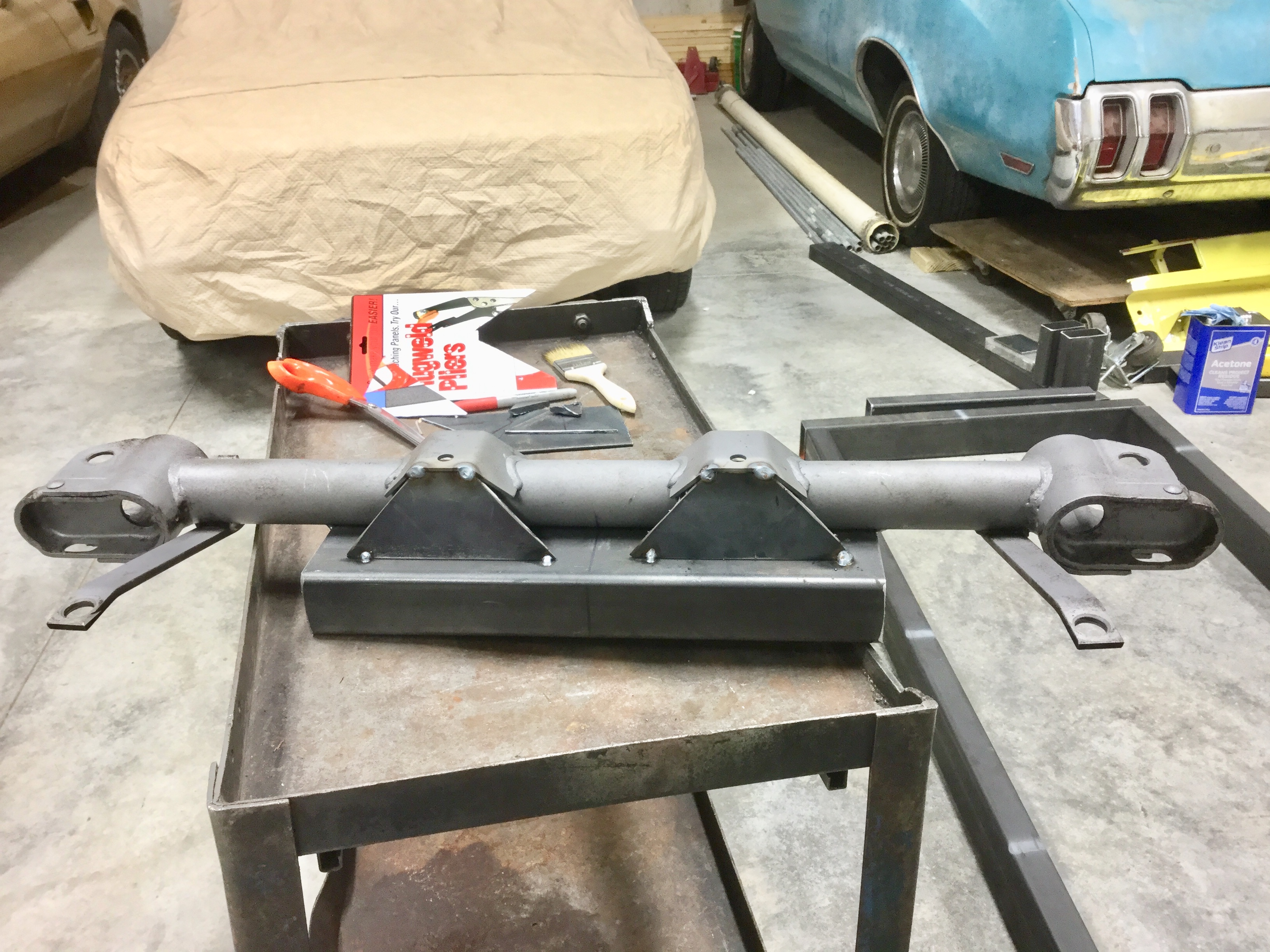

Rear suspension mount. Also added one at the trans mount area and a support under the firewall/floor pan area.

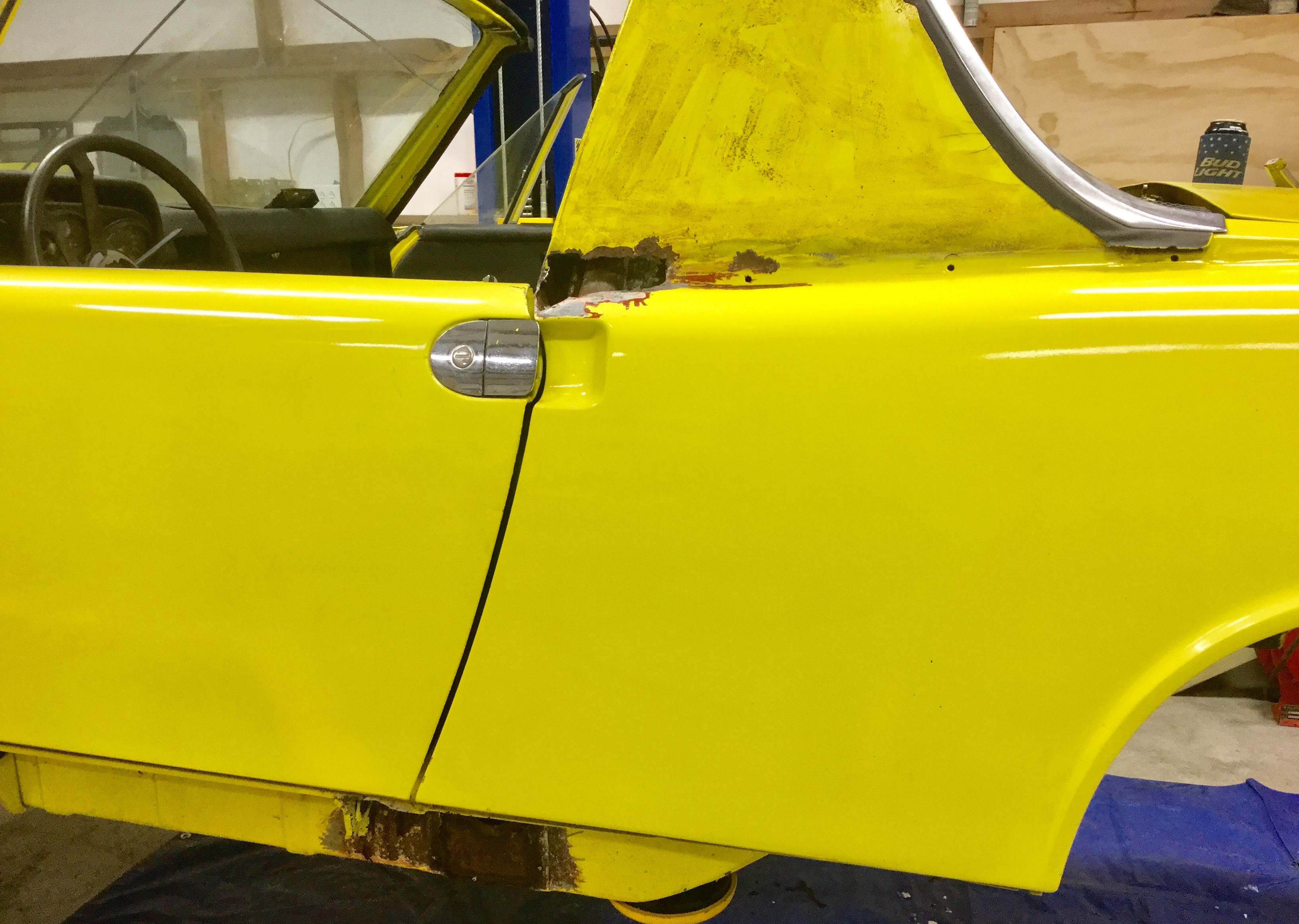

First “lesson learned”. I should have left the door latch area installed and just cut the door jam around it. Attached Image
