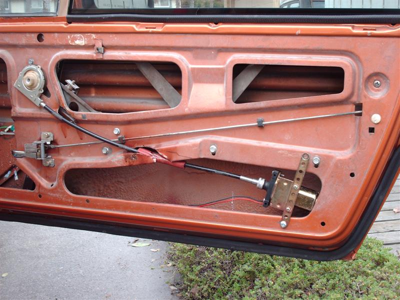

Here’s a very clean installation of a kit that available.

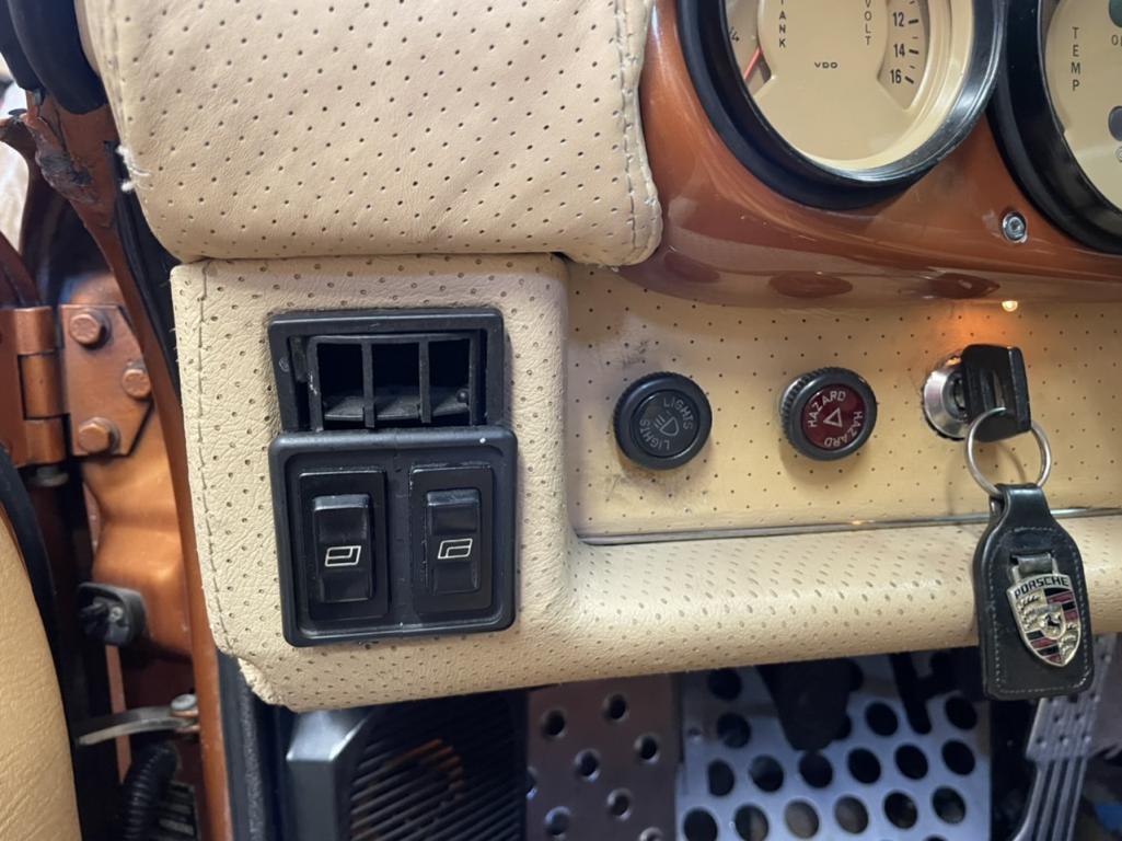

QUOTE(theer @ Jul 22 2022, 07:52 AM) *
Where/how did you wire the motors and the switches? In particular, getting power to the motors as well as the drivers switch for the passenger window?
My switches; more later….
I picked up an extra vent and modified it with the Dremel tool. The wires run under the cowling to each door. Really easy way to connect the switches.
I have a wiring diagram, I’ll see if I can find it.

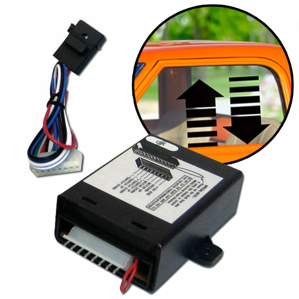

Bookmark this link: https://www.autoloc.com/catalog/Power-Windo...h-Express-Units
This is a must-have; it allows you to touch the up or down button once instead of holding your finger on the switch. Mine have been working for 10+ years.
Also, a second touch will stop the window
Mine are mounted behind the door panel in a recessed area
