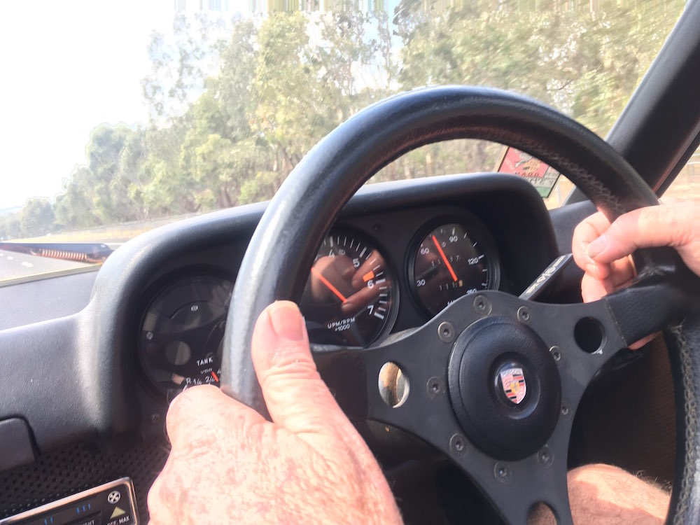

near enough around 3K at 70mph in 5.
correct profile 165 XAS tyres.
checked against GPS on phone by passenger.
68.5 mph.
not a pedant - in cop paranoid mode on hume highway.
speed limit = 110 kph. or 68.35 mph.
tolerance is down to 1 kph officially.
"dictatorship" is on an insane post covid revenue drive. (IMG:style_emoticons/default/barf.gif)

what you are saying is your speedo is reading 5mph higher than your actual speed?
that would be correct if that is what is going on.
speedo will be reading higher.
225/50r16 = about 632 mm diam.
165 XAS 15 = about 646mm diam. which is pretty much stock.
and the speedo is almost dead on, at least on mine.
ie your tyres are not bigger than stock and the speed should be faster on the speedo as a result. (IMG:style_emoticons/default/beerchug.gif)
