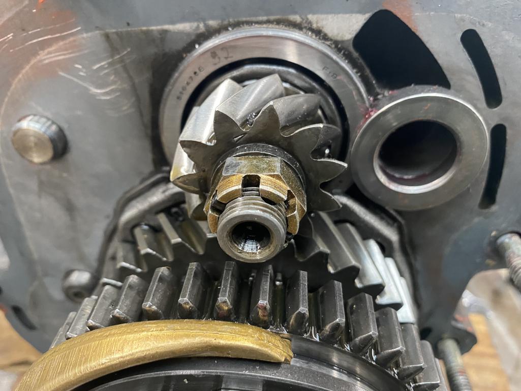

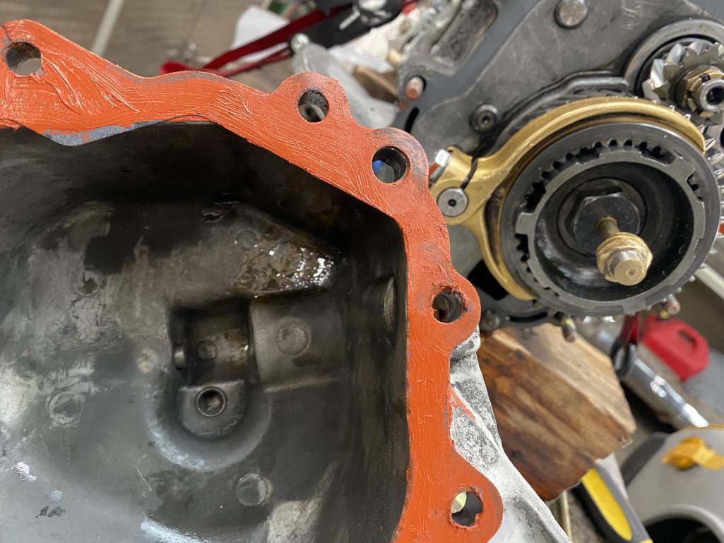

ok so i attached a pic of the position of the cut spacer.
i also attached a pic of the inside of the cover and the trans gears. in the center of the cover there looks to be a bushing. the speedo gear coming out of the trans appears to be hitting that bush. on the old cover, that piece has worn away and i can not see what was there. it looks like, if that bushing was gone, it would work. can i remove that and not use it? it must be there for a reason. the numbers on the old and replacement case are the same.
any help would be great! thanksAttached Image

i have the spacer with the "moon" cut in place and the spacer and bearing races on the reverse shaft but in spite of my bag and tag process, these wound up on the bench.
can anyone I.D. them?
forgot to add this oneAttached Image

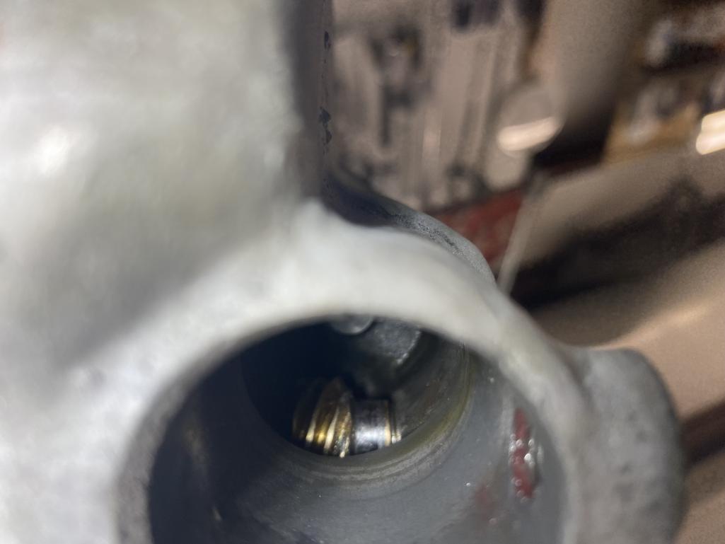

here is what i've found.
after pulling the speedo drive i have the same problem. so i took a bore scope and had a look and i've attached a pic. the rod coming out of the trans that has the speedo gear on it, is hitting the case. i think the old case had the same problem and thats why it wore a hole in the case. so my questions are, is there a different case? or can i change the rod to a smaller one? is it possible to cut the rod or remove some material from the case? is there something else going on with the trans?
thanksAttached Image Attached Image Attached Image

Looks like the bushing from the old cover is stuck on the end of the gear.

Member No.: 47
was the old cover with the hole in it... caused by the speedo gear backing out?
thats from the large nut holding the gear stack coming loose and allowing the stack to move forward and back... eventually drives a hole through the rear case.
when mine did that... I did not reuse the speedo drive, as it was pretty damaged from boring through the case.
