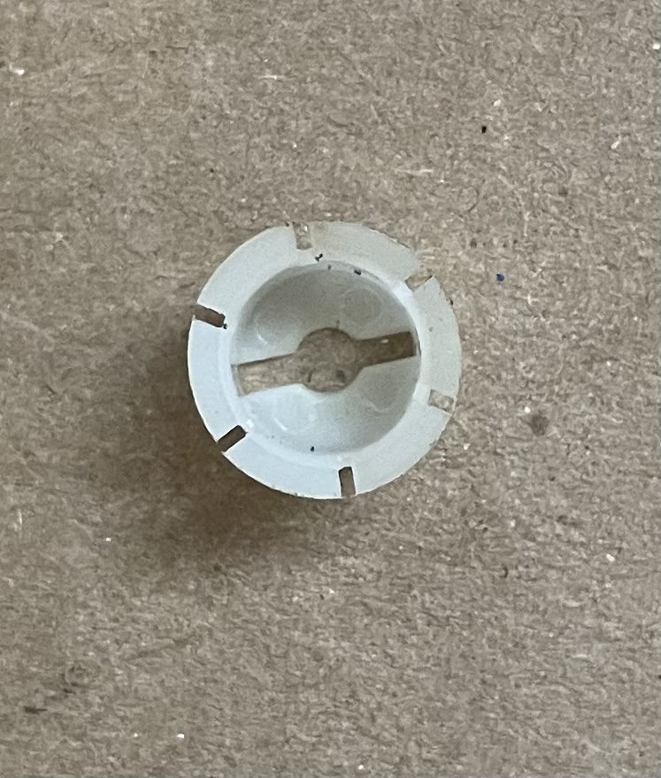

Need some help.
I have disassembled my 914 gauges to install LED back lighting.
When I disassembled the tachometer this little white part dropped out.
Need some help with what it is and where does it go.
Thanks in advance.

See pic

I don't have a VDO tach in pieces right now to show you - but from memory, these are the spacers which sit between the back of the case and the mechanism core. If this has fallen out (and you have not removed the bezel) then someone has unscrewed those locating screws on the back at some point. Or, it has been repaired and someone was careless in zipping it back up?
If it was me - and the tach works fine - ignore and continue driving. If the tach is malfunctioning, then either a) you're prying the bezel off to investigate / fix or b) you contact NHS or PAS to get things sorted.
This item should not simply fall out of the tach! Hope this helps,
- Tony
PS. I have a bunch of these if you're just missing one. Ping me if you need extra

I have the gauge completely dissassembled, eg: can opened, bezel off, screws removed. The can(s) are now empty. is there a diagram where this white part goes within the tach. I'll probably reassembled in the next couple of days and desire to get it right.
