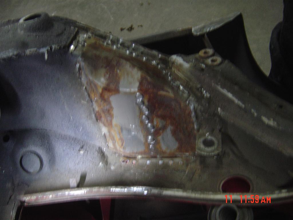

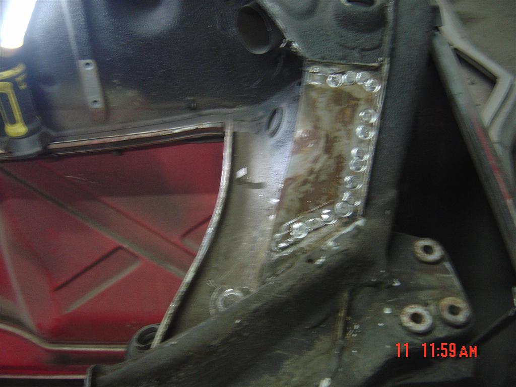

I left mine in only because I was too lazy to remove them. It won’t hurt to leave them but it’s a nicer job if you take them out. It’s a messy job but there’s often rust behind the mounts so it’s worth doing.
Actually I did have the mounts removed on a chassis that I’m converting. There was a big rust spot behind the passenger mount.

Not much to add here other than if you do choose to remove, keep in mind the R. side mount can be valuable to folks doing rust-oration.
This is a part not yet being reproduced & is often compromised.

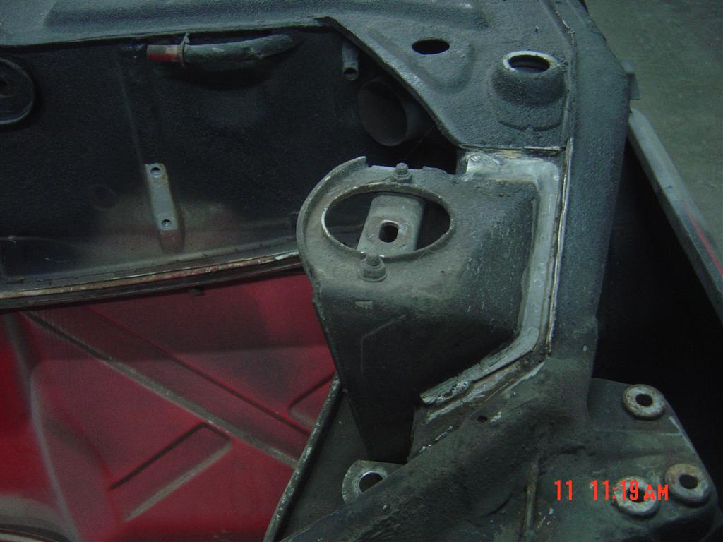

Here’s my other car

I removed mine on my six conversion and like Mepstein, mine had rust behind the mount on the passenger side. I cleaned it up, but the area was weekend and eventually cracked and we had to add a scab plate. This does give you more room to adjust the valves on the six, but with the high cost of six motors, it will also not allow you to go to a lower cost motor in the future like Subi or LS.

Thank you all for the replies! Very helpful, esp. the photos. Thanks again, Brian

You can just cut them off and leave the plates the are spot welded to the body. It's not that big of a job and gives you the room. I did it a long time ago.
