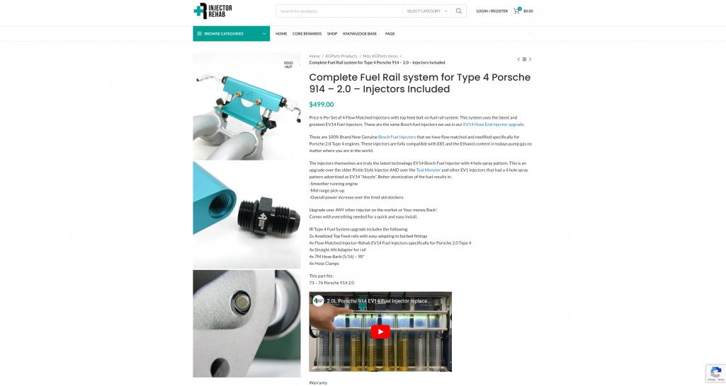

I am looking hard at this as I am getting tired of the gas smell and hard starts. It seems like the dub-shop has pre-orders going on. Should I take the plunge? PMB? The dub shop? Decisions....decisions.

Currently sold out but more on the way.

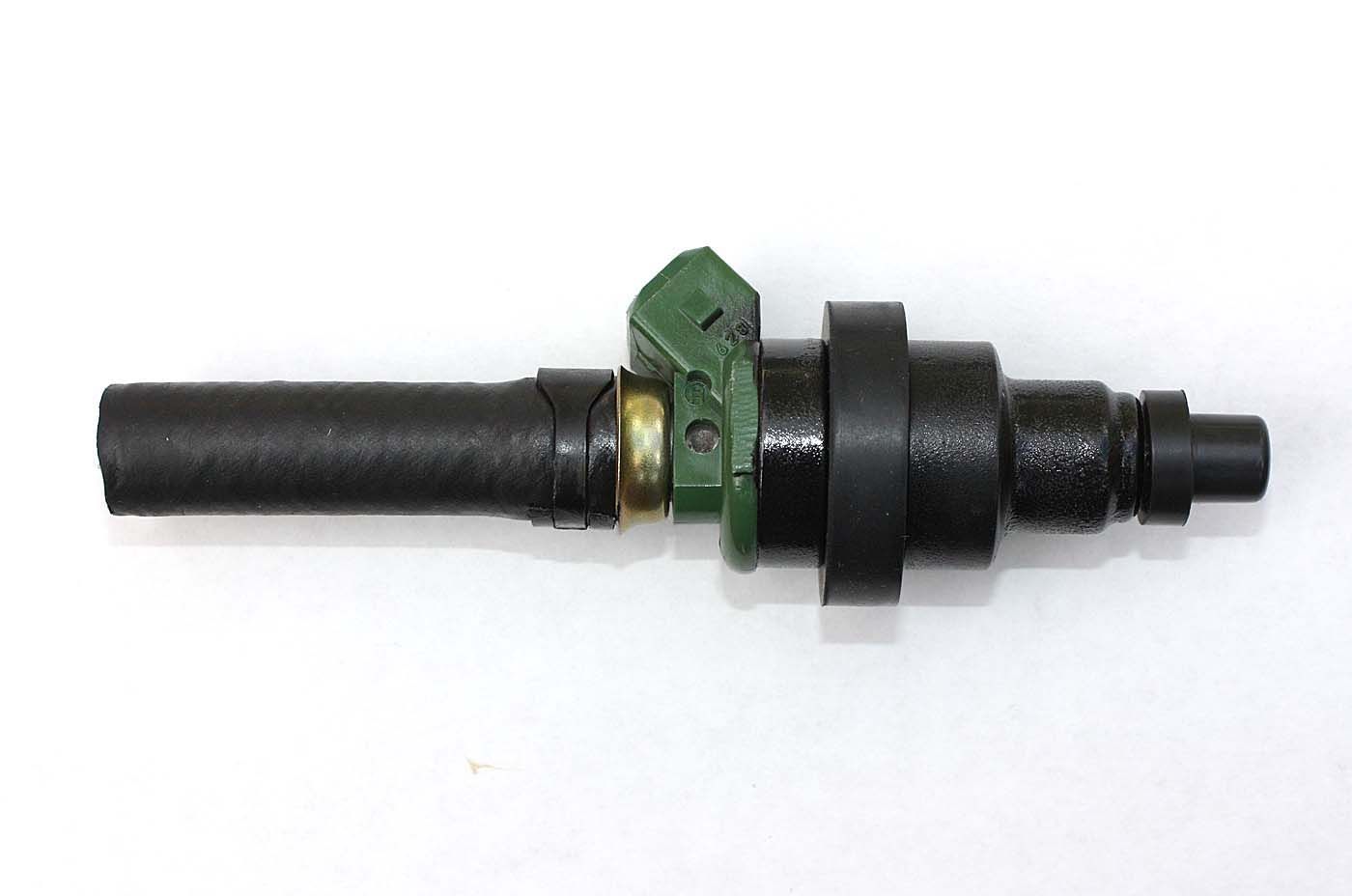

You can do that. I just decided to use the stock rails and securing hardware using these injectors...they should look familiar...
https://www.fiveomotorsport.com/high-impeda...jaguar-porsche/
I replaced the straight lines with curved ones from 914Rubber (or was it Pelican? I forget).

Ive talked to those guys, it seems the real value of those rail kits is the ability to use newer non-EV1 injectors.

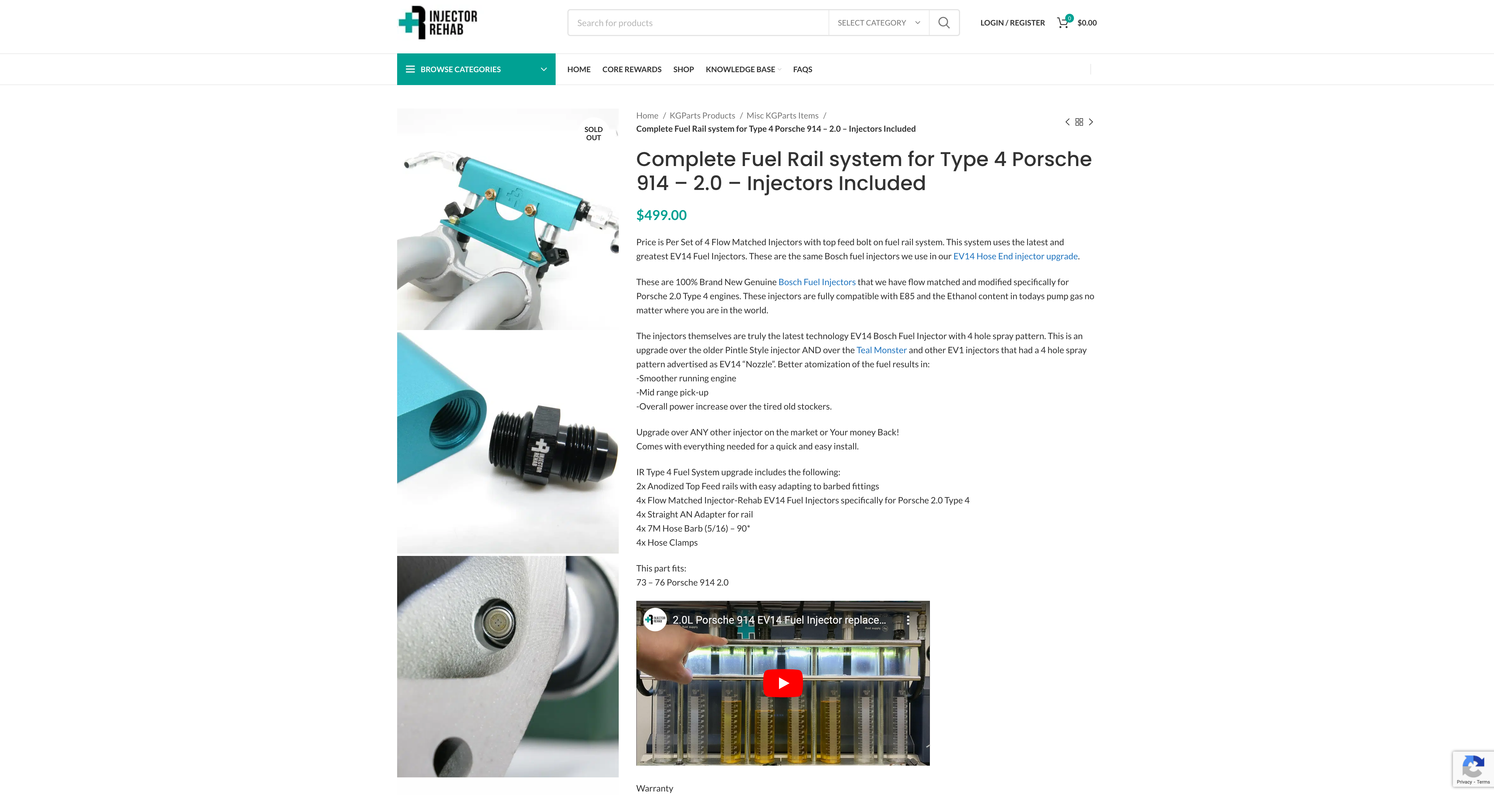

this company i have known about- for a while , so i reached out to them again today, and they had an issue with their mounts. i am looking at this if i were to avoid the ITB’s and just get a programmable FI system but stay with my 50mm throttle bud and kept the direct injector, but have new improved bosch injectors that go with these fuel rails. seems keeping direct injection is best, and 50mm probably getting me plenty of air, i have an AFR ans it seems i have enough fuel although at WOT it feels like it needs more ans does go more lean, thst is so hard to change with D-jet it can’t be mapped out lik you could with a more modern FI ECU.
so maybe the Haltec EXU ans sensors to go with my stock intake runners ans 50mm TB ,
would not be a lot of $$,
Injector rehab has one set of rails and injectors, but have to make a new retaining bracket for it, so i’m drying to work out a deal with them and get that, going to look into SDS, Haltec, and get with Eric about their system they have for 2056/2270 motors they developed . not sure which ECU they use.
Phil
QUOTE(914Sixer @ Feb 6 2023, 03:05 PM) *
