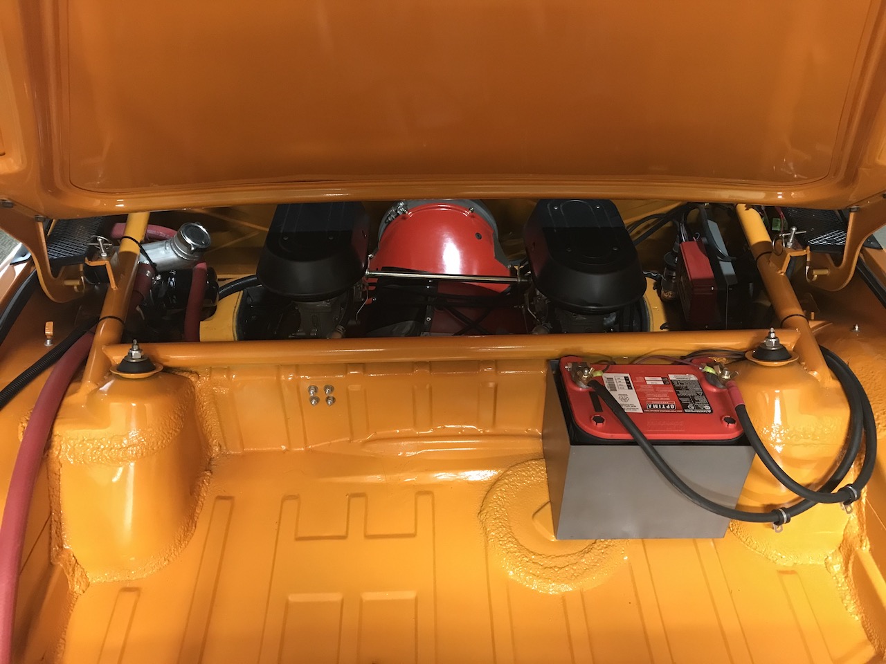

I've had Optima's for the last 20 years, never an issue. In the 914-6 GT Tribute for the last three. Best, MarkAttached Image

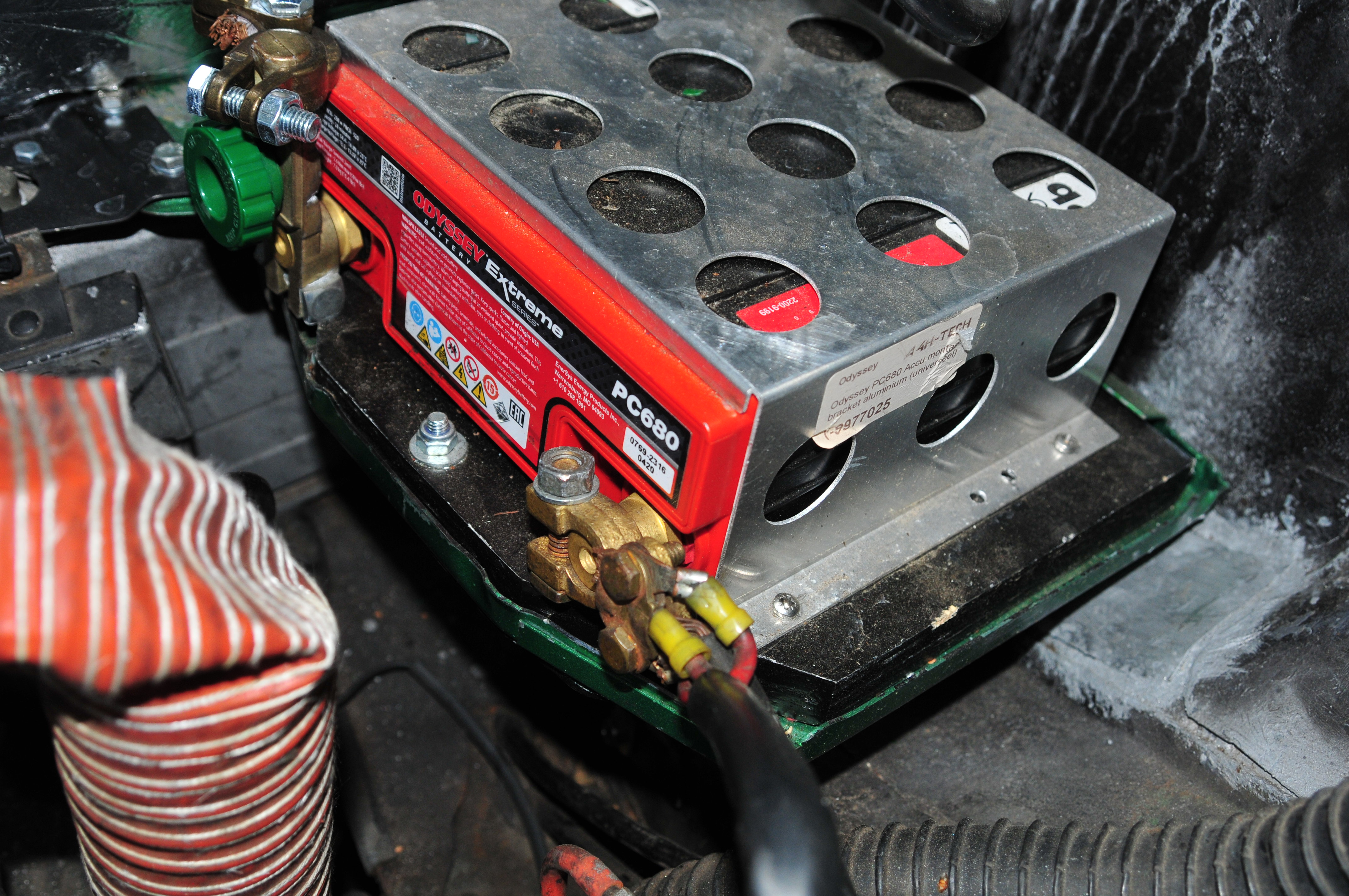

I have the PC680 since 2 years now. It's very light and the car starts every time from the first time. But I always disconnect the battery if i don't drive the car for more than a week and from time to time I use a battery tender since the weather here in Belgium is too bad to drive a lot during wintertime.
To disconnect the battery I have the little green wheel at the negative of the battery. Very easy to install and very cheap. I also had to buy a bracket to hold the battery in place. Until now , I'm very happy with it. I have no radio and no AC, probably you will need a bigger battery or a really good alternator if you have them and use them a lot.
I only did this to reduce weight and I think the AGM's keep their charge longer ( when disconnected).

Slotty from this angle it looks like that positive terminal is so close to the metal tray. I'd feel worrisome, but it's probably further away in actuality.

QUOTE(nditiz1 @ Mar 18 2023, 06:11 PM) *
Looking at the pic, I was thinking exactly the same thing, but in reality it's not that close. Maybe I'll put some insulation in between, just to be sure.
