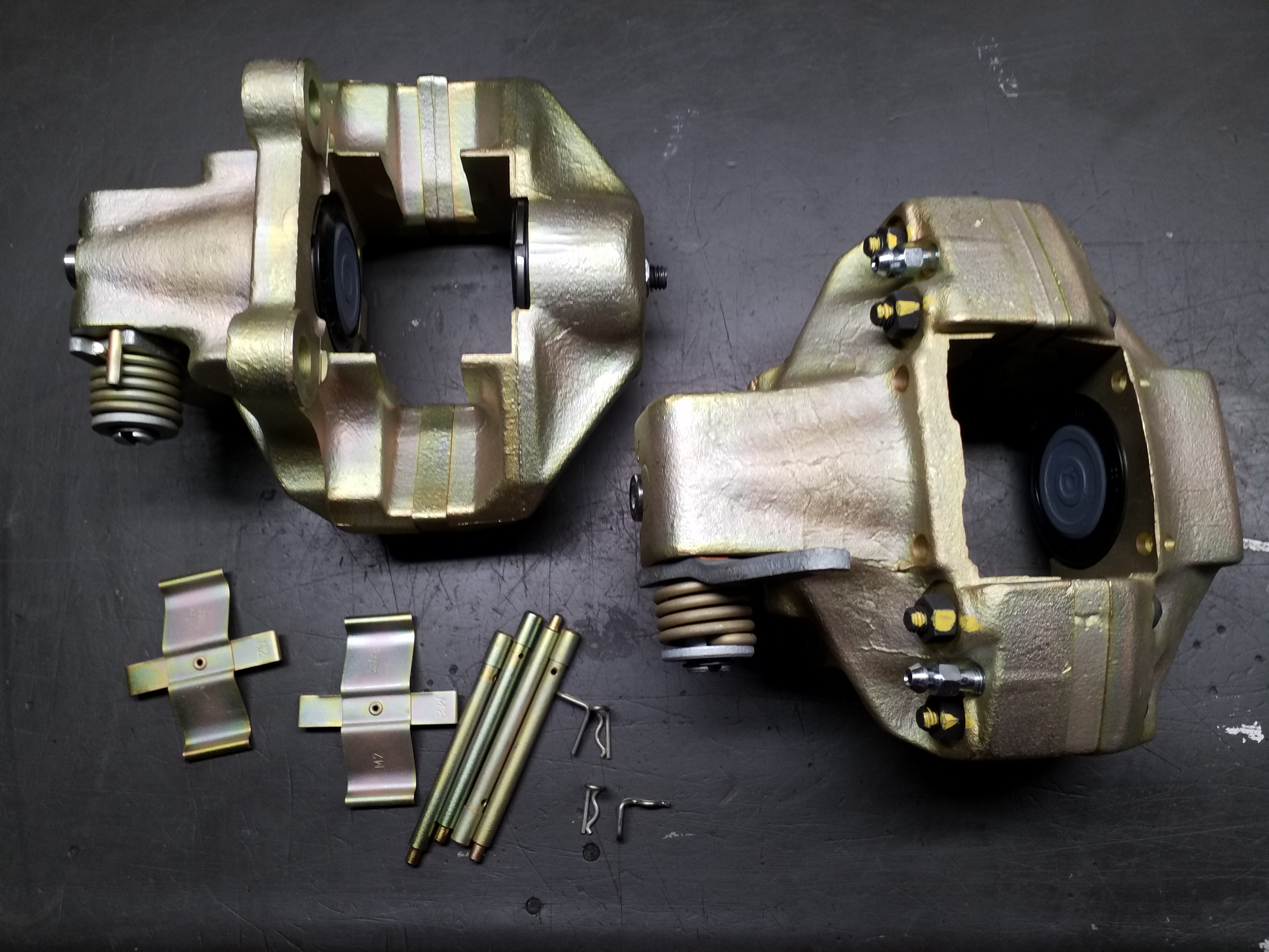

Here are my 308 calipers. I had a machinist add the second bleeders so they are on top when mounted on my 914/6 conversion. Fresh from restoration at PMB last month.

Nope - I’m wrong on a casting common to all three applications. You can see the /4 casting has a different formation than the Ferrari rear inboard casting.
The other thing that is implied is that Krieger’s calipers had to be drilled to the /6 orientation meaning that the 308s weren’t dual bleed screw.
The mystery continues as to what would prompt ATE to have two bleed screws on the /4. (IMG:style_emoticons/default/confused24.gif) I’m still thinking someone else was using the /4 casting for another OEM. That will take some digging. I’ll see what I can find on ATE classic site.
/4 photo from Pelican

No can do. The 308 calipers are back on my car. They look like they are ~ 25% larger than the 4 cylinder ones
