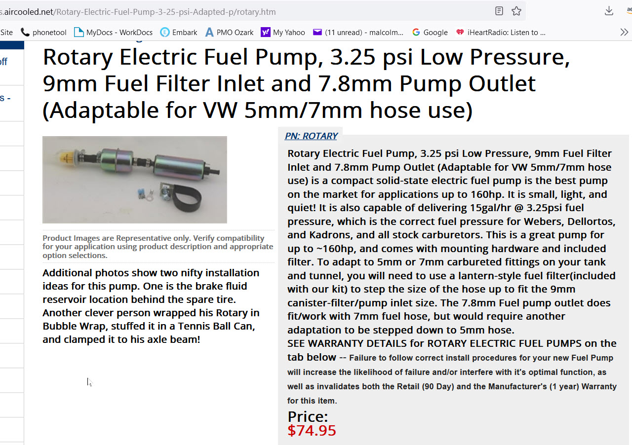

What flavor of fuel pump are you using?

Just a quick fuzzy picture yielded similar threads on both carbs. 11 to 12 threads on each.
Pump is also from ACN. Do not think ROTARY is a brand. I believe Carter is a similar design. But I mounted it under the tank on the frame of the Drivers side.

Also, the repackaged Carter pump retailers sell (CB, PP, AC.net, and others) is available on Amazon for about half the cost. Not sure why there's such a big markup on these from the average car sites. Carter part number P90091.
https://www.amazon.com/gp/product/B07BBDSZP...=UTF8&psc=1
