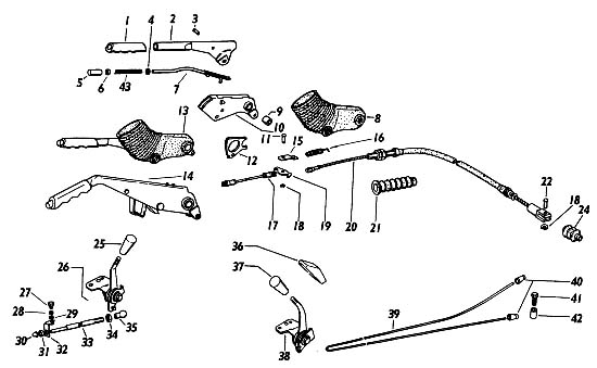

My car was previously a race car with a nice 2.0L engine and already had a 5 lug conversion when I got it. The rears I believe are just drilled 4 lugs.. anyway, my emergeny brake works - that is it holds the car solid from moving when I pull it up. Problem is, the handle won't stay up (keep those jokes to your self) by itself. I think it's missing the half round ratching parts. I never looked closely at it because I just assumed there was more to it because of the 5 lug conversion. Could it be I just need those ratcheting pieces...why would someone remove them. I need a schematic of the handle and ancellery items.

I just fixed mine (73 late style). The ratchet piece was missing. Under the handle, closer to the front of the car should be a blind nut welded to the brake bracket. The ratchet peice should be bolted onto that. The ratchet part is piece #12 in the diagram. Picked one up from AA for $8.50.
