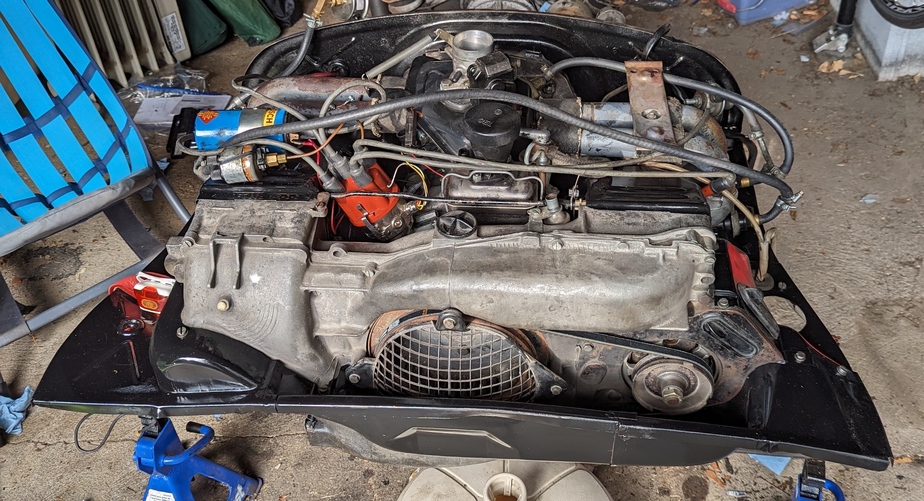

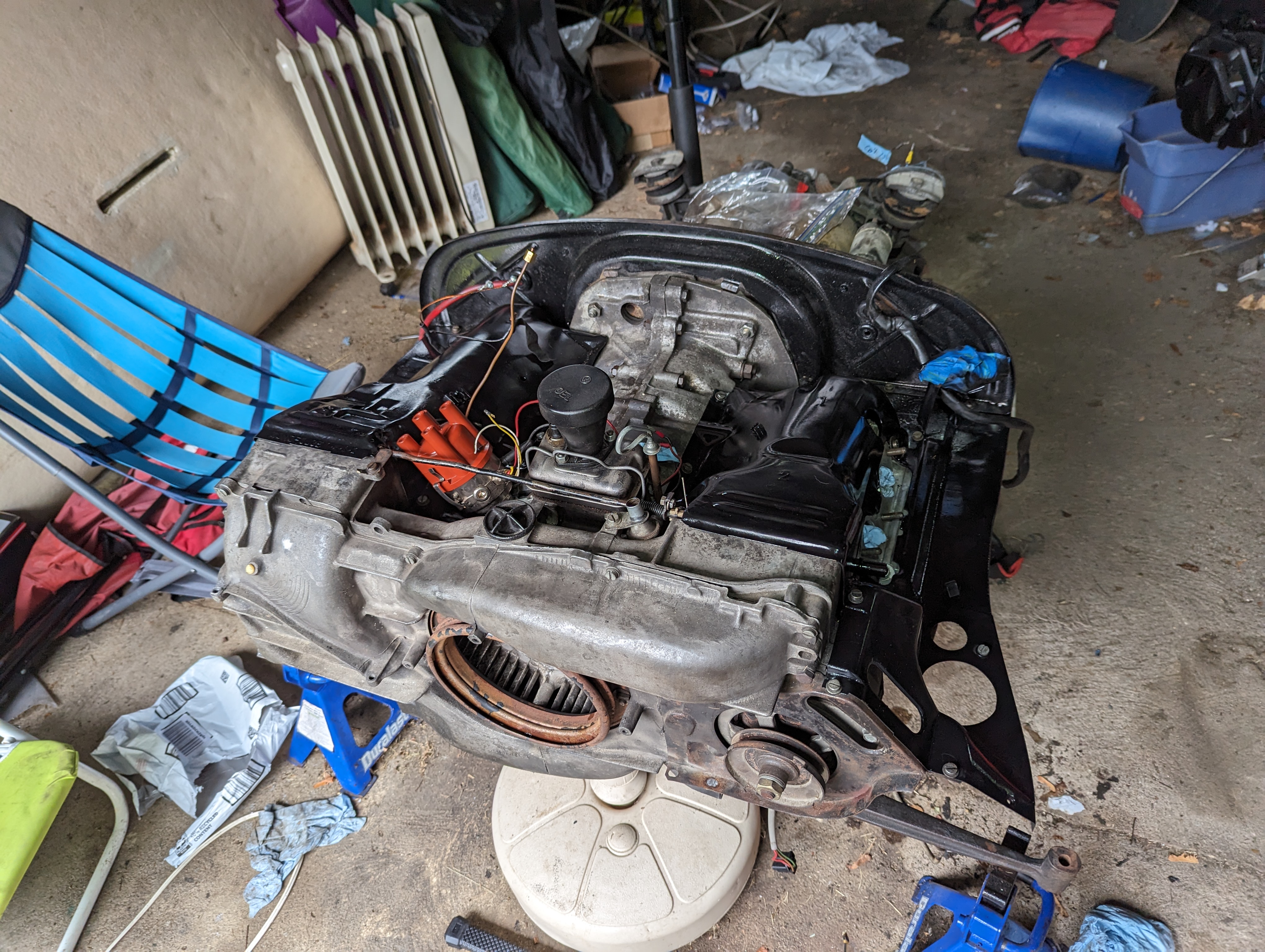

New oil cooler installed. Along with the new sleaves, pistons, and valves (2056, somewhere near 8.4:1 compression).
Question for the hive mind. Should I put the heat exchangers/headers on now or wait till it's in the car? It is not on an engine stand.Attached Image

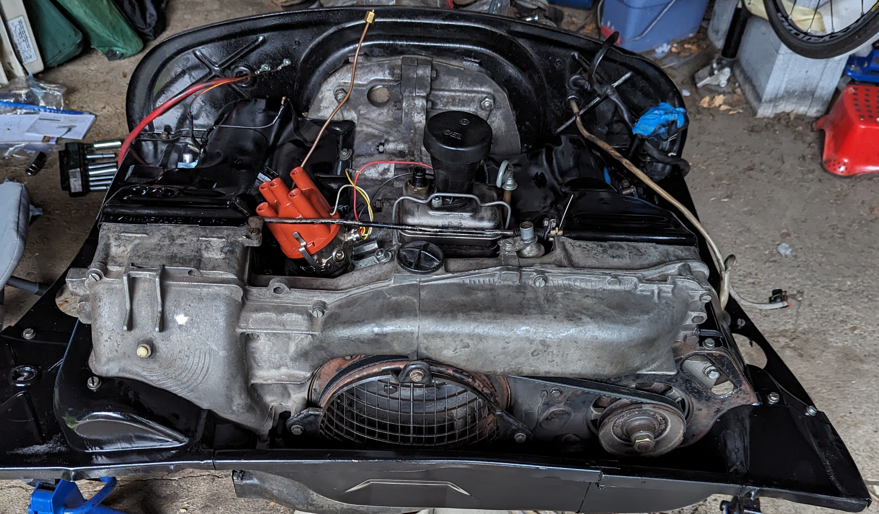

And a little protection...

Without an engine stand, you can tilt the engine up on the valve cover (with good padding) & install the upper H/E, then tilt on other valve cover & install the other, Install the muffler hanger loosely. You can do an air leak test on one tube at a time with it's exhaust valve closed.
Easier than balancing the H/E's on your knees while trying to install overhead. (IMG:style_emoticons/default/headbang.gif)
Good luck
ClayPerrine
post Aug 25 2023, 07:34 AM
Posts: 16,542
Joined: 11-September 03
From: Hurst, TX.
Member No.: 1,143
I always wait until the engine is in the car. That way you can loose assemble everything and then torque stuff in the correct order.
And you don't have to worry about bumping the heat exchangers while installing the engine.
Just my $.02

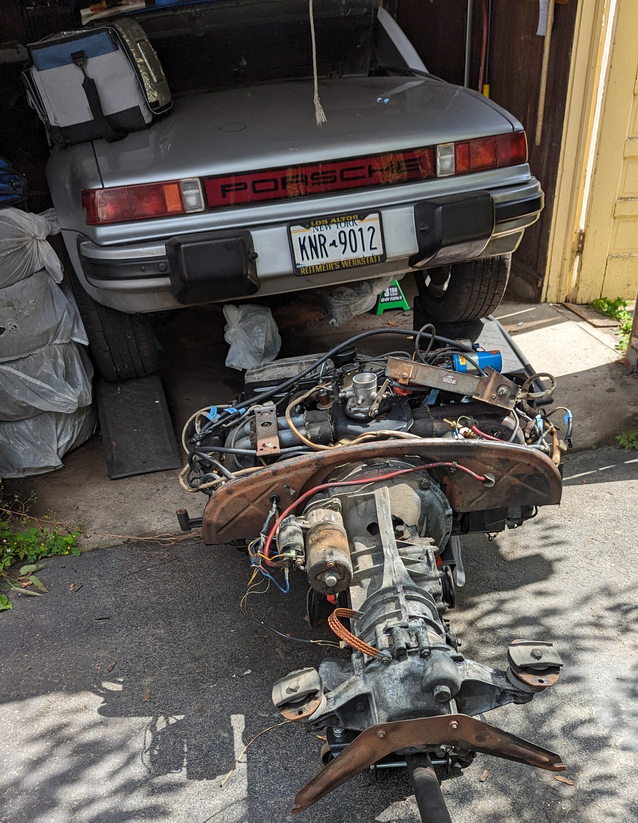

I think I am going to put it in without. No damage, the car is in a nice position for me to work on it comfortably laying on my back. Without the exhaust I can have better access at all the cabling, heat stuff etc.

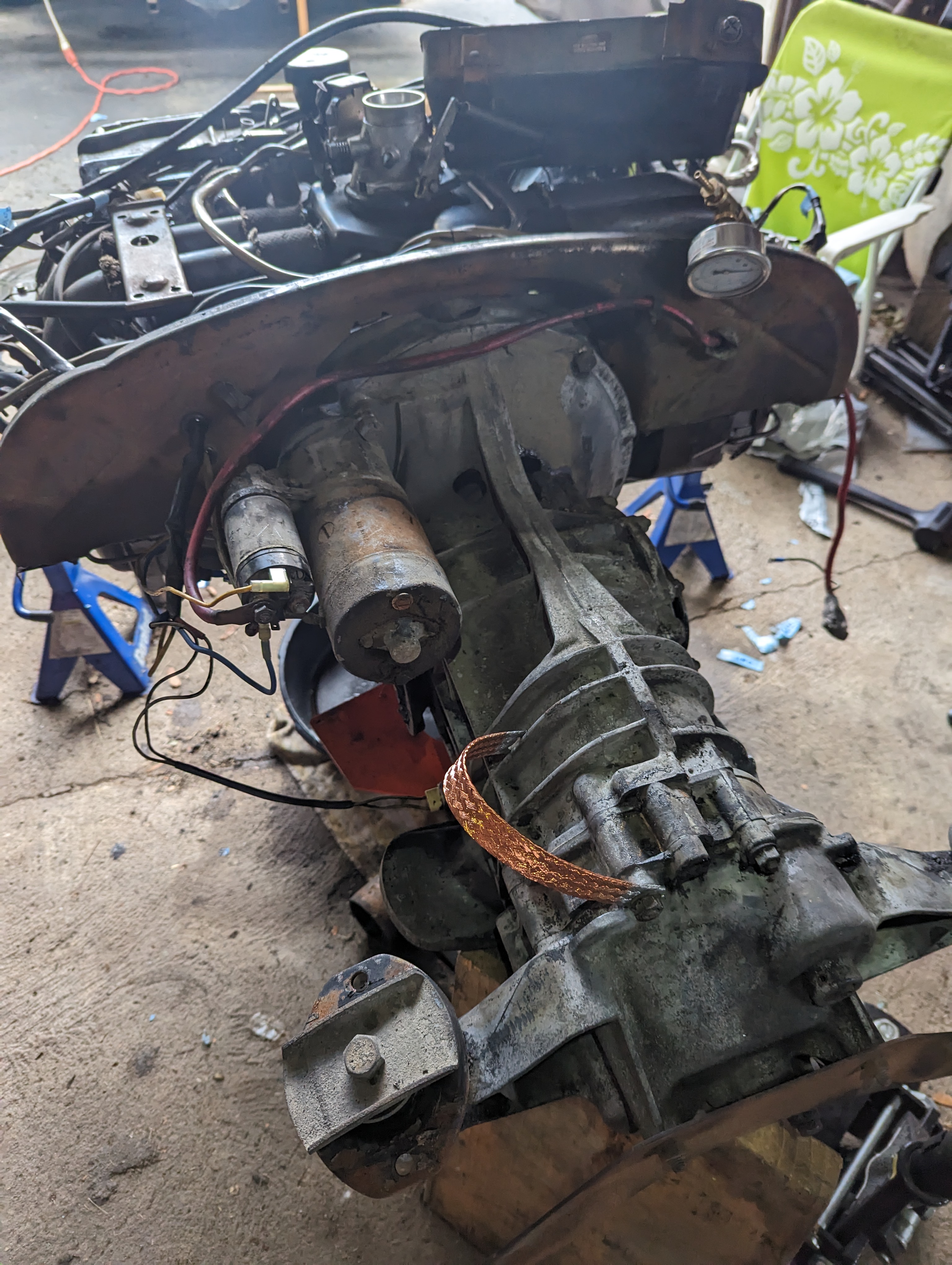

Guess who forgot to do the ground strap before I put the cvs and the exhaust back on... it could have been so easy....

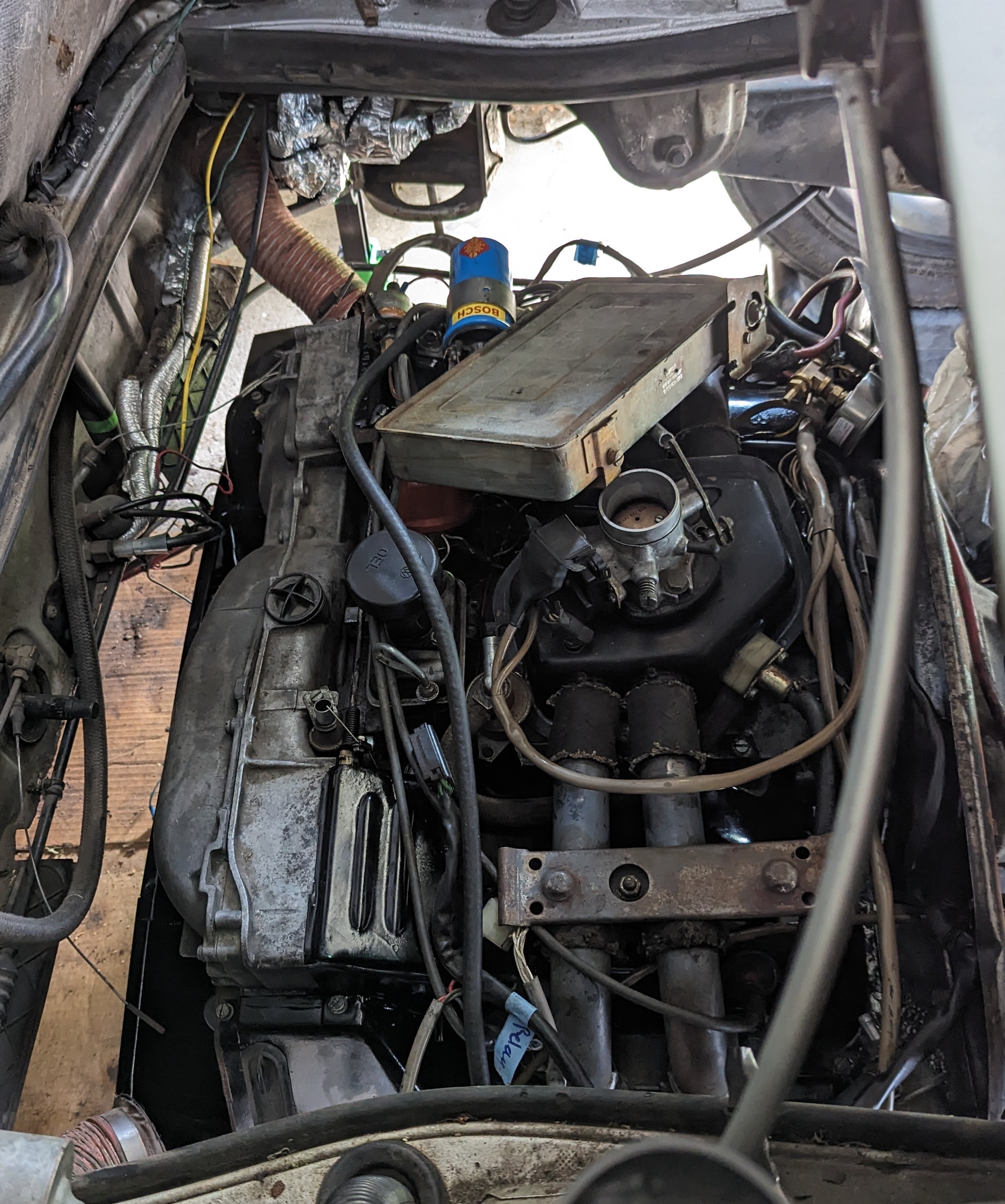

Put it all together this morning up top, turned over maybe 20 times and fired up
