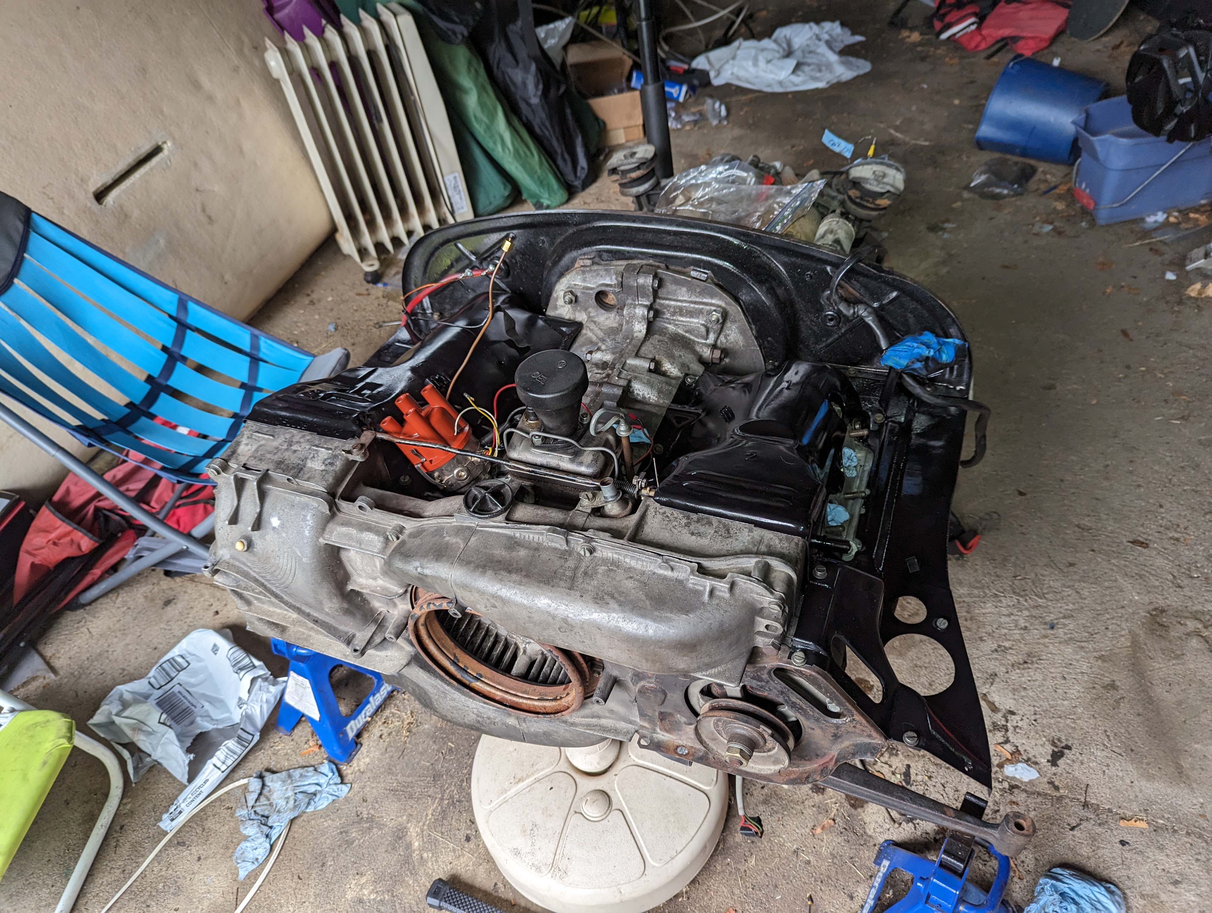

New oil cooler installed. Along with the new sleaves, pistons, and valves (2056, somewhere near 8.4:1 compression).
Question for the hive mind. Should I put the heat exchangers/headers on now or wait till it's in the car? It is not on an engine stand.

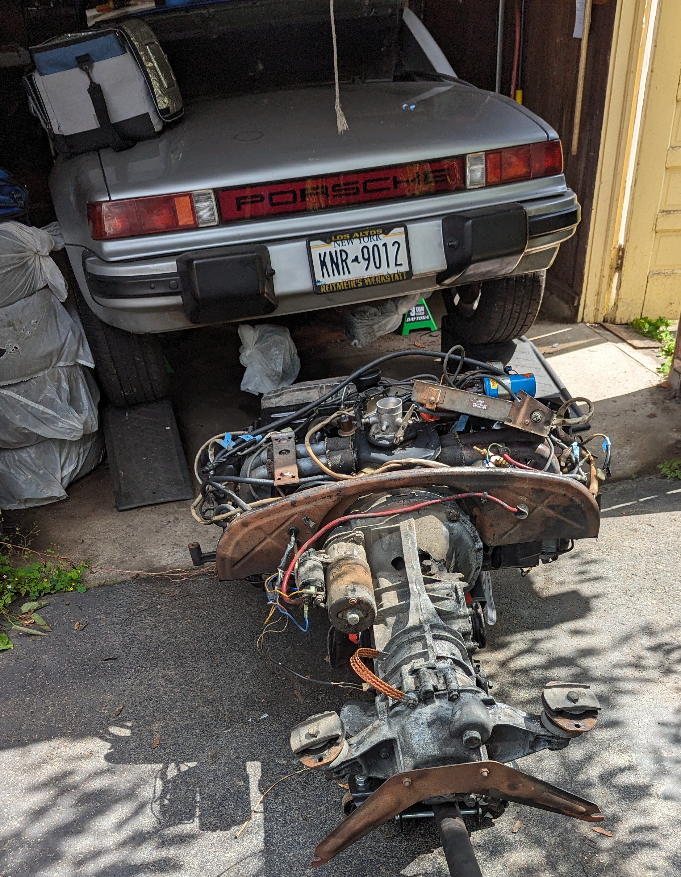

I think I am going to put it in without. No damage, the car is in a nice position for me to work on it comfortably laying on my back. Without the exhaust I can have better access at all the cabling, heat stuff etc.

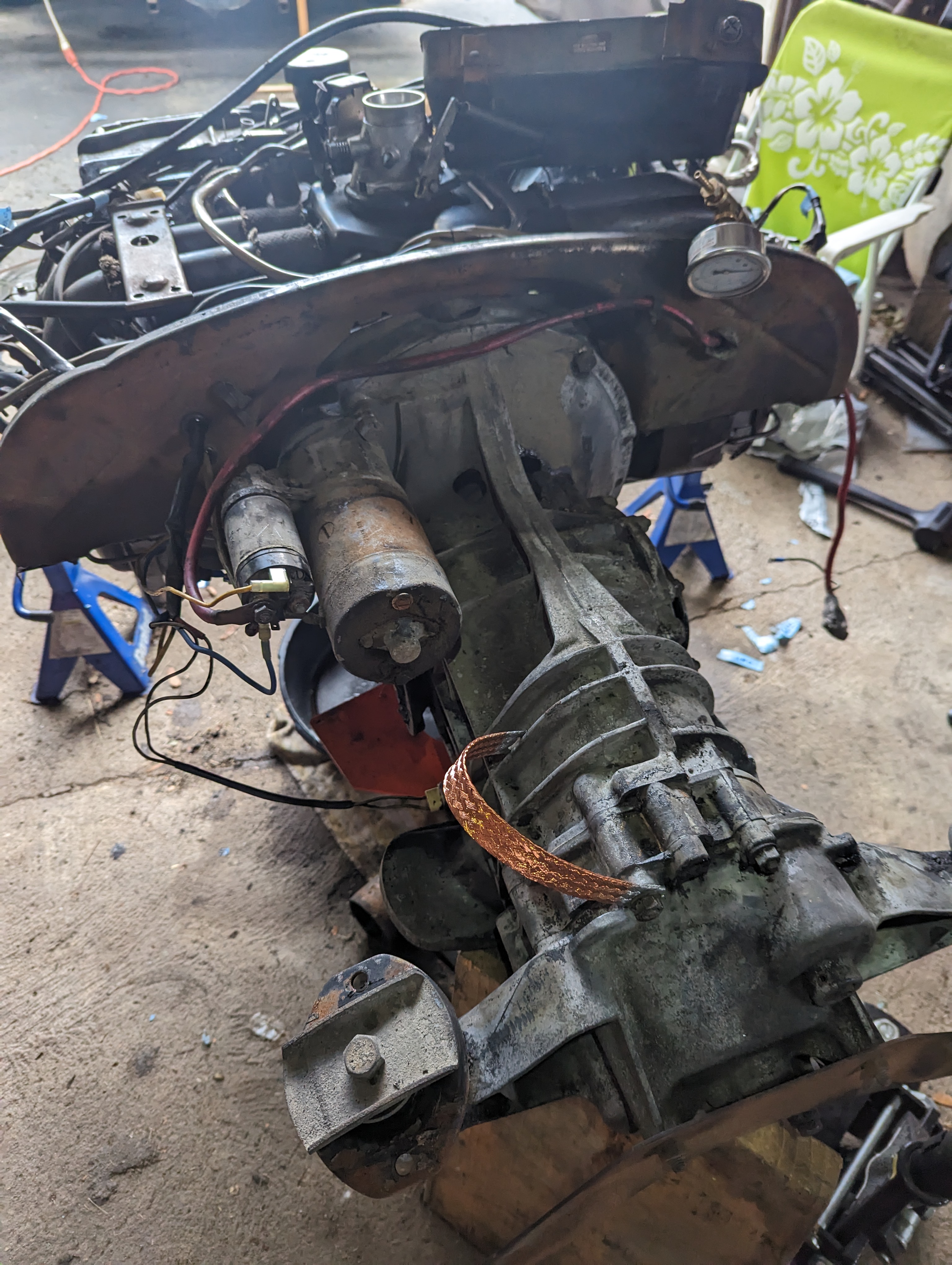

Guess who forgot to do the ground strap before I put the cvs and the exhaust back on... it could have been so easy....

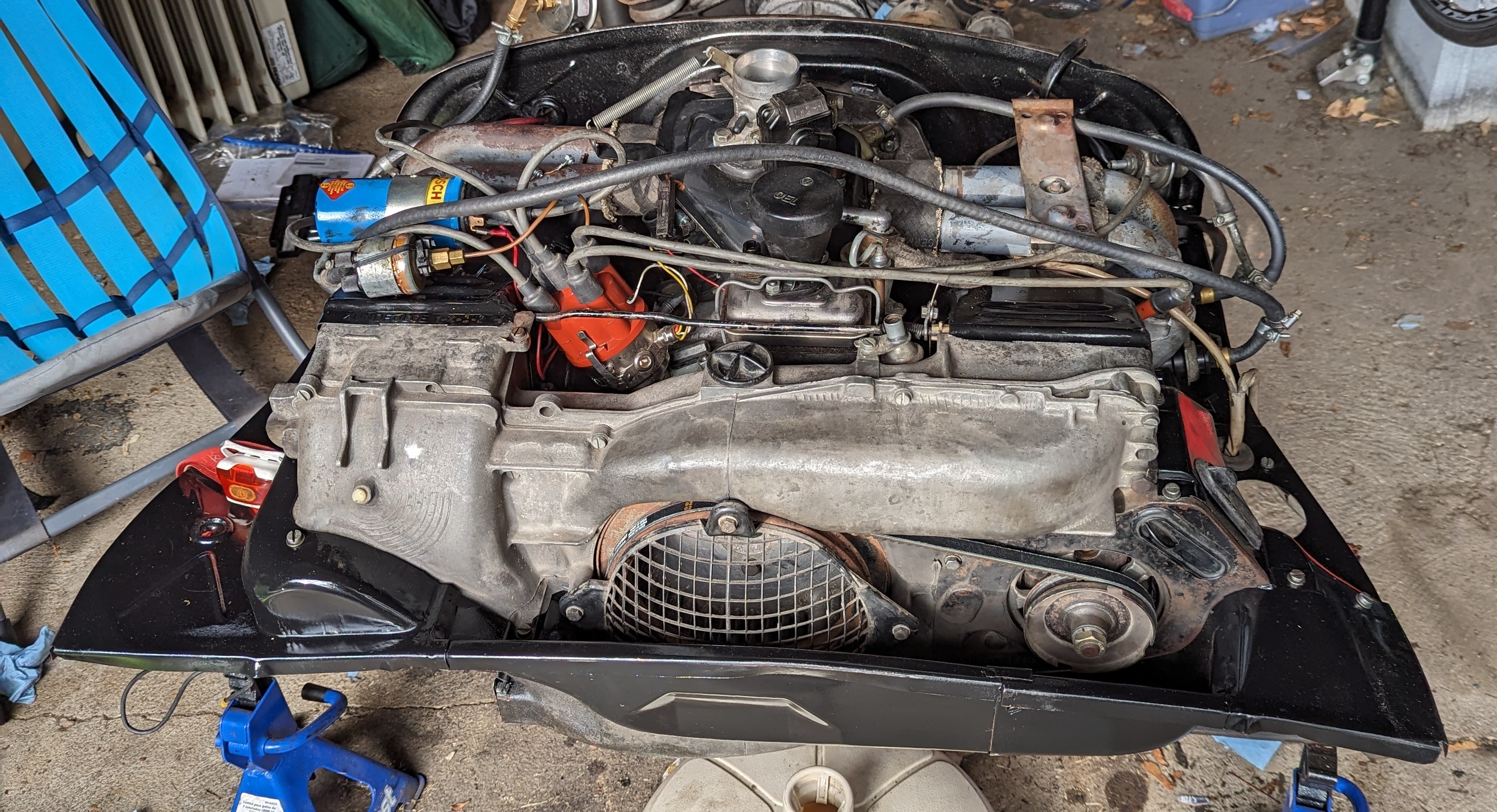

Put it all together this morning up top, turned over maybe 20 times and fired up

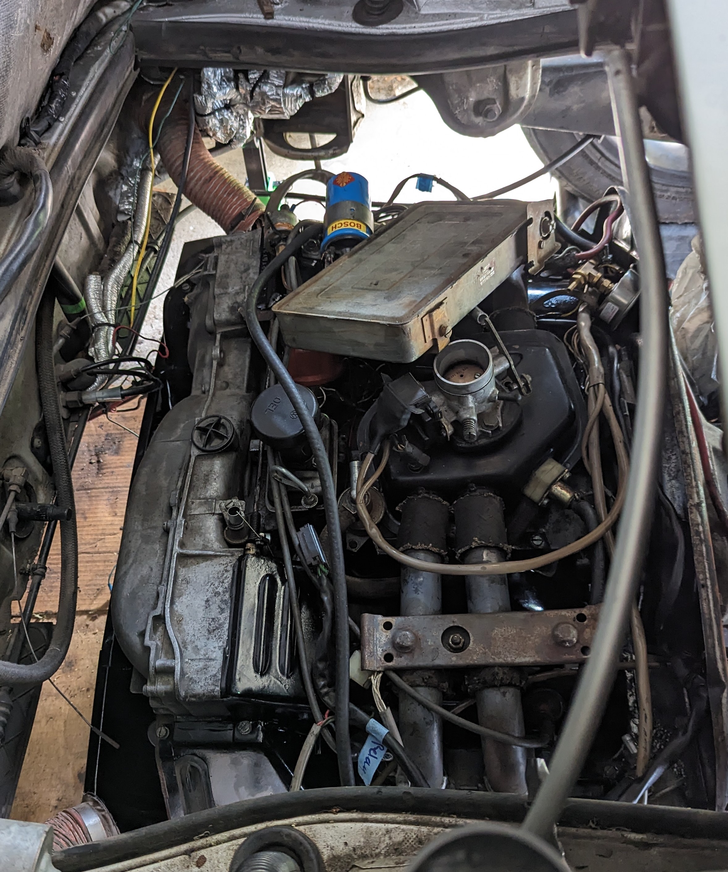

I wanted to revisit the exhaust question. Waiting till the engine was in worked very well. Didn't even need child labor. Rested the tail of the exchangers on the jack and pumped it up using my leg as I wanted more height. Super glue on the annealed seals. Reassembly of the heater boxes and the rest of that crazy stuff was easy as could be.
