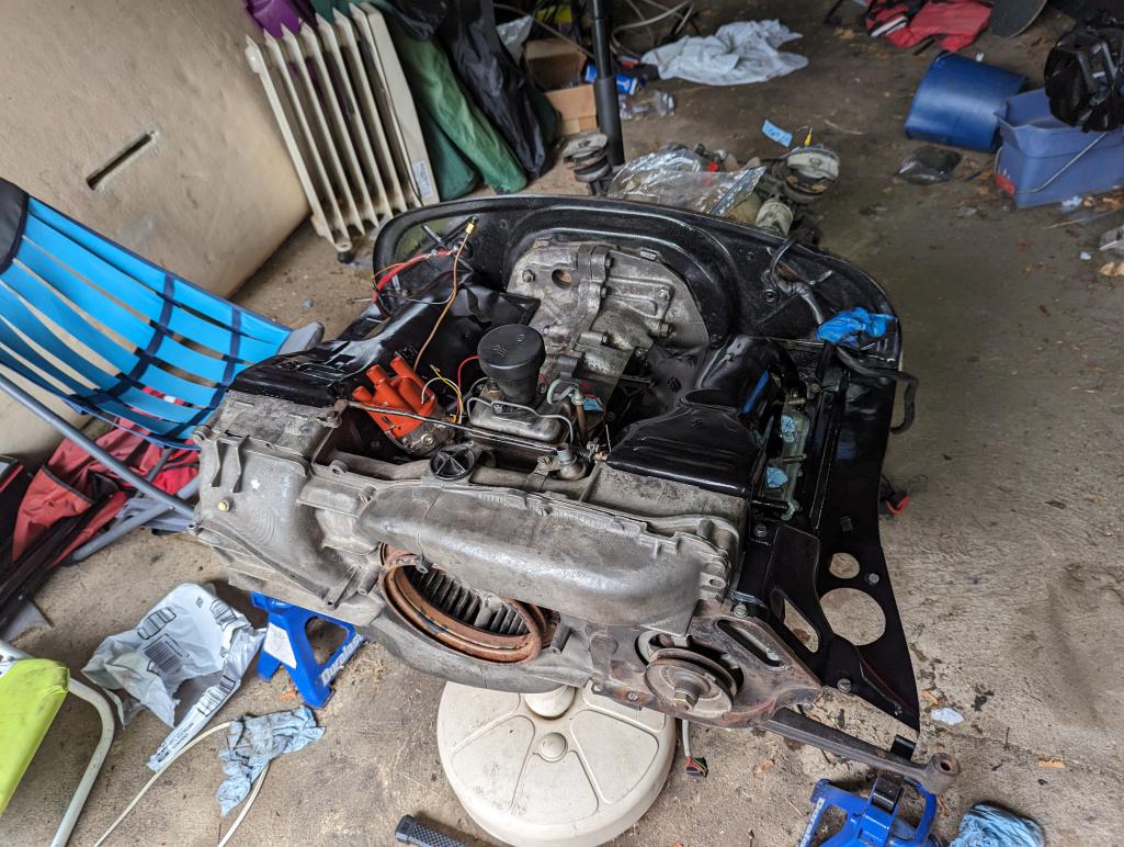

New oil cooler installed. Along with the new sleaves, pistons, and valves (2056, somewhere near 8.4:1 compression).
Question for the hive mind. Should I put the heat exchangers/headers on now or wait till it's in the car? It is not on an engine stand.Attached Image

barefoot   Without an engine stand, you can tilt the engine u...   Aug 24 2023, 05:12 PM
ClayPerrine   I always wait until the engine is in the car. Th...   Aug 25 2023, 07:34 AM
Al Meredith   I agree with Clay. Install the heat exchangers and...   Aug 25 2023, 09:07 AM
bkrantz   I agree with Clay. Install the heat exchangers an...   Aug 25 2023, 06:50 PM
emerygt350   I agree with Clay. Install the heat exchangers a...   Aug 25 2023, 07:15 PM
GBX0073   Great Question I have wondered myself I have the t...   Aug 25 2023, 09:29 AM
emerygt350   If I do it now I could probably rig up stuff to ho...   Aug 25 2023, 10:40 AM
r_towle   It is easier to install the engine without the hea...   Aug 25 2023, 11:25 AM
emerygt350   That is what I was thinking. That and all the pip...   Aug 25 2023, 04:32 PM
