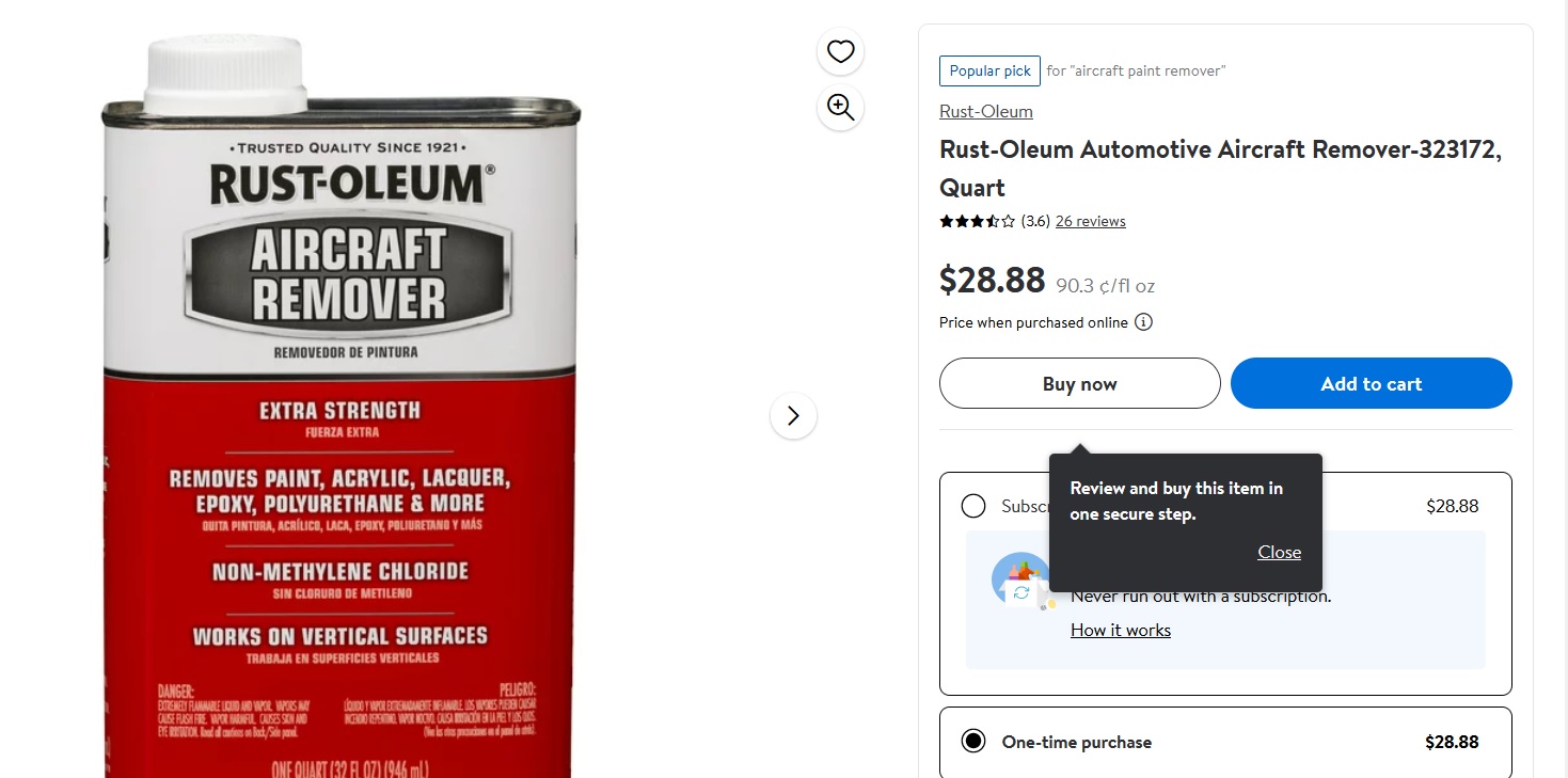

Heat is a good way to go. Don't use oven cleaner right away, even if you intend to polish. It will not work on the paint as well as the anodized finish. Remove the paint 1st. You can use aircraft paint remover. It will not attack the aluminum.
You can buy in many hardware stores, even Wallmart.
Rustoleum makes a version as well as Klean-strip
Then use whatever you plan to strip the anodizing off with. The lye or oven cleaner will not attack the paint as well as the finish making it uneven.

I should have been clearer in my earlier response. I used Klean Strip “Aircraft Paint Remover,” as recommended by Gonzo54, with good results.

Since CA and CO have banned MEK, I've found that most of the strippers hardly work. I recently tried out Kleen Strip on my never ending quest to find something that works as good as the old Aircraft Stripper. I put all the door hardware for my Westfalia in a cup, covered it, left it for three days and the paint barely softened. I ended up blasting it.
The only 'new and improved' product that kind of works is Jasco. It's just way more product and way more time. When it comes time to strip another large project, I'm going to take a road trip to New Mexico to pick up some real stripper.
