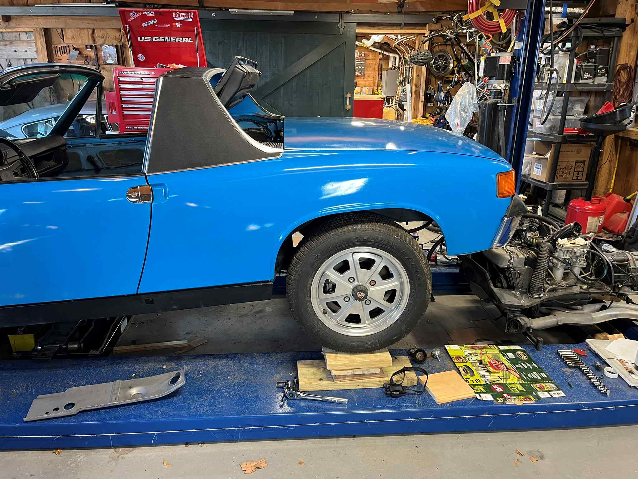

The previous owner told us the hell hole and longs had been done and he seemed like an honest car guy. So that was dumb and naive of me. It was clear that a bunch of work had been done around the hell hole, which looked good from the engine bay. When we got it home and on the lift we were faced with a rusted out lower firewall.
Ordered a firewall repair panel.
We pulled the engine today and cut out the lower firewall and it’s pretty ugly.Attached Image

There was even an epoxied in piece of heavy gage sheet metal in the corner that’s now open under the heater duct.
I wanted to add more pictures but was told I exceeded the limit for this post). Need to figure out how to compress iPhone photos. The bottom of the RH long is pretty rusted.
I understand I need to take off the RH door and brace between the upper hinge bracket and the seat belt mount before going after the rust long. I’m trying to figure out the best way to support the chassis on my 4 post lift with a punky long and a rotten firewall.
So that I still have access to repair the long.
Would appreciate suggestions, or links to relevant posts.

Oh boy! Yeah, there's more to uncover for sure. Oddly, had a 914 with similar rust that was very localized (lucky). Like maybe just that small area sat in something? Was able to patch it up and move along.

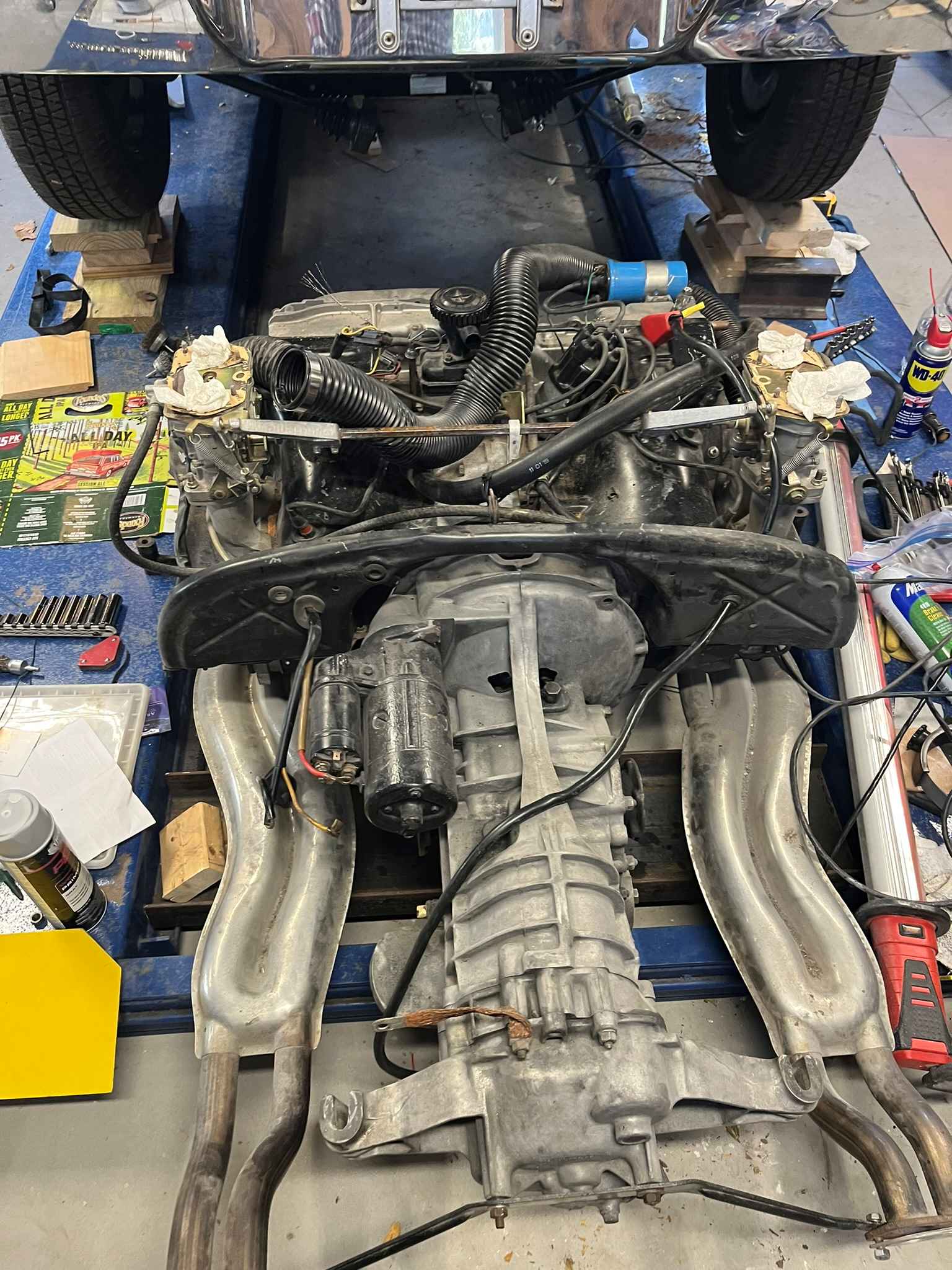

I ended up jacking up the back of the car by the suspension to get it high enough to pull the engine onto the lift.
The RH long was too weak to use as a jack point.
I figured out the photo resizing.
Here's the engine sitting on the lift.
Tim

Superhawk996
post Jan 6 2024, 09:46 AM
Posts: 8,179
Joined: 25-August 18
From: Woods of N. Idaho
Member No.: 22,428
QUOTE(Tim17 @ Jan 5 2024, 05:30 PM) *
(IMG:style_emoticons/default/av-943.gif)
I’m laughing with you not at you. Welcome to 914ville. (IMG:style_emoticons/default/welcome.png)
I’ve come to the conclusion that many peoples definition of fixed is quite different than my own.
You look to be on a good path toward a better fix than epoxy. (IMG:style_emoticons/default/laugh.gif)

Many others have walked this path and brought back cars in far worse shape than what you’re dealing with so far.

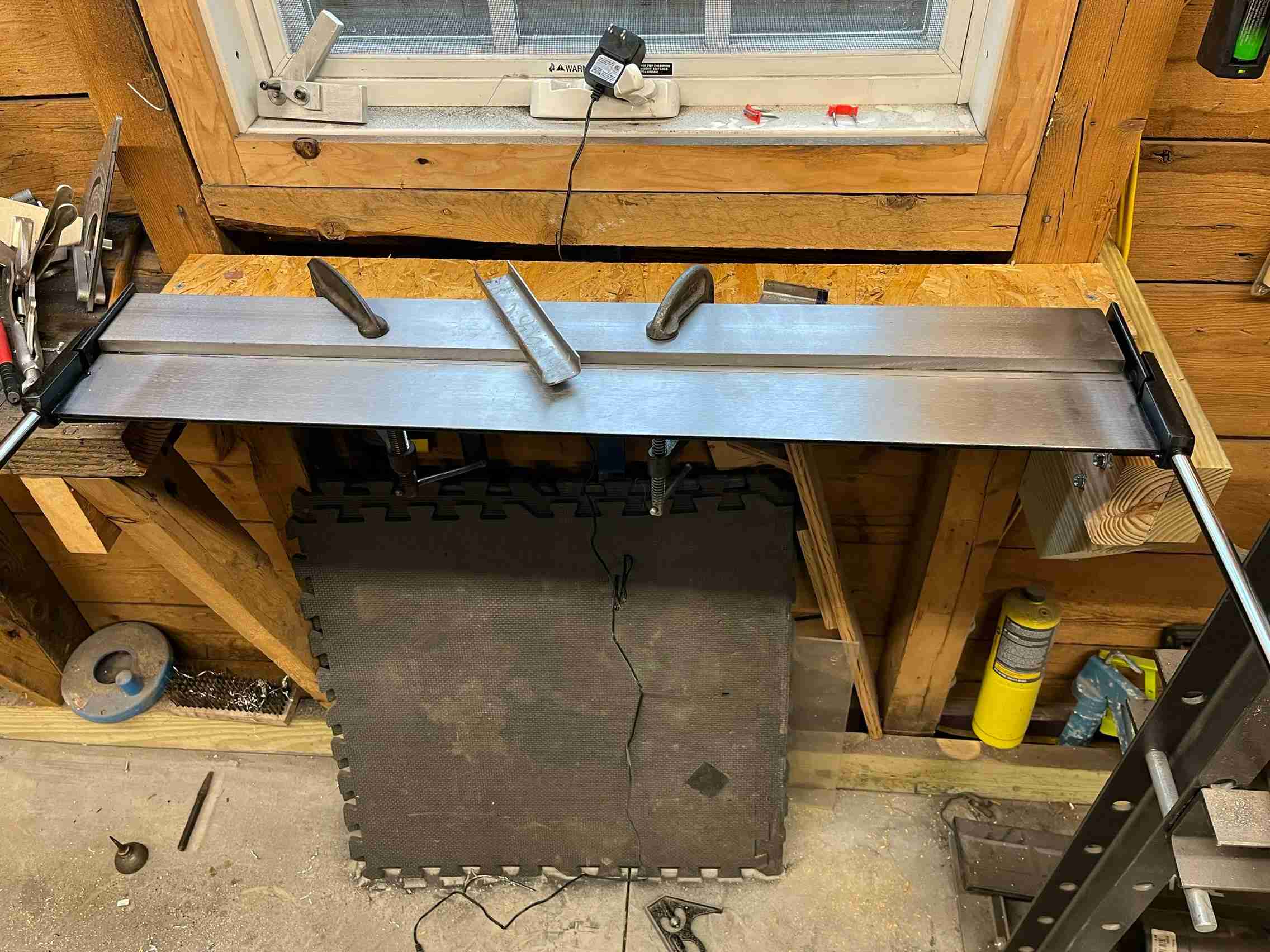

Picked up this 30" HF sheet metal brake on sale yesterday and mounted it on the wall.
Bent up a short length of 18g sheet into a U as a test. It did fine but I could see the movable jaw deflecting which will only deflect more with wider stock. Thinking about adding more rigidity to this.
Anybody else modified one of these? I still think its a great value at $63.
