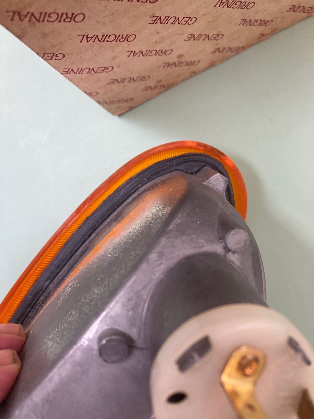

to assist for reference.
orig factory part spares that i have never taken apart and have had in the box for 30+ years. they come in box as complete units assembled.
original to car.
only been apart when first put it on road in aus 30+ years back.

maybe this will help.
i think it was literally 30 years ago i last had these off.
the bulbs have lasted. (IMG:style_emoticons/default/beer.gif) (IMG:style_emoticons/default/beerchug.gif)
but i do remember it was a bit like screwing the tail light lenses back on my old type 3 squareback. you had to tighten them to get the gasket to compress but you had to go oh so gently with the screws. a little bit at the top. then a little bit at the bottom.
(i learned my lesson breaking a few type 3 hella lenses back in the day when you could get hella lenses and they weren't NOS rare stock etc (= extortion exchange rates etc). (IMG:style_emoticons/default/biggrin.gif)
as you can see in this photo of mine the lens is very slightly bowed.
but its enough to compress the seal.
(and i swear the last time this lens got touched was way back in about 1993)..

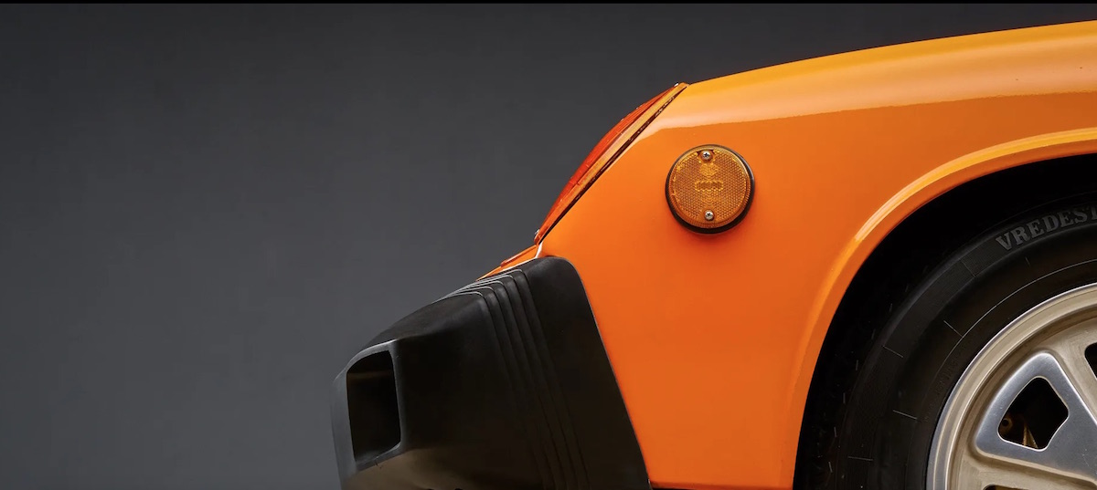

i had a bit of a look on BAT for you.
some very good photo galleries.
seems similar fitment on some very good condition restored cars.
just slightly bowed to clamp the seal down not at all different to how mine is.
whatever you do just go real real easy.
i am sure the lens can split along the the join line and its there even in the pure amber lenses (where the split was for the euro lens as well). i remember thats where my old type three lenses would go ka pow if i got over zealous screwing it down. and they do need to be screwed down a little bit. similar kind of rounded gasket seal on all those old VWs light lenses.
(IMG:style_emoticons/default/beerchug.gif) good luck. should work. i think gasket is ok. just needs to squash. a tiny bit.
