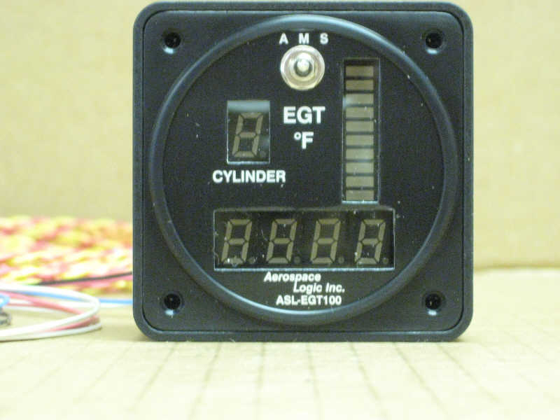

The title is the question.
I know what to look for with water-cooled stuff.
I have no experience with air-cooled stuff yet...
What say you?
Is there a normal range?
A never exceed number?
Anyone ever use 4 thermocouples?
Was there any noticeable difference (#3 is of concern to me)?
Thoughts, tips, any data would be greatly appreciated!

QUOTE(gereed75 @ Jan 8 2024, 03:19 PM) *
Chris, were you running 4 sensors and if so could you see any delta?
I had visual data only for all 4 cylinders, on a single digital readout, scanned in sequence at one second intervals. If one went out of range the readout stayed on that cylinder.
There was some variation but in general it was fairly uniform.
At times I reamed a jet orifice to make the spread smaller.
ChrisFoley
post Jan 8 2024, 03:36 PM
I am Tangerine Racing
Posts: 8,016
Joined: 29-January 03
From: Bolton, CT
Member No.: 209
Aerospace Logic changed the standard 5 second scan interval to one second for me, same with my CHT.
