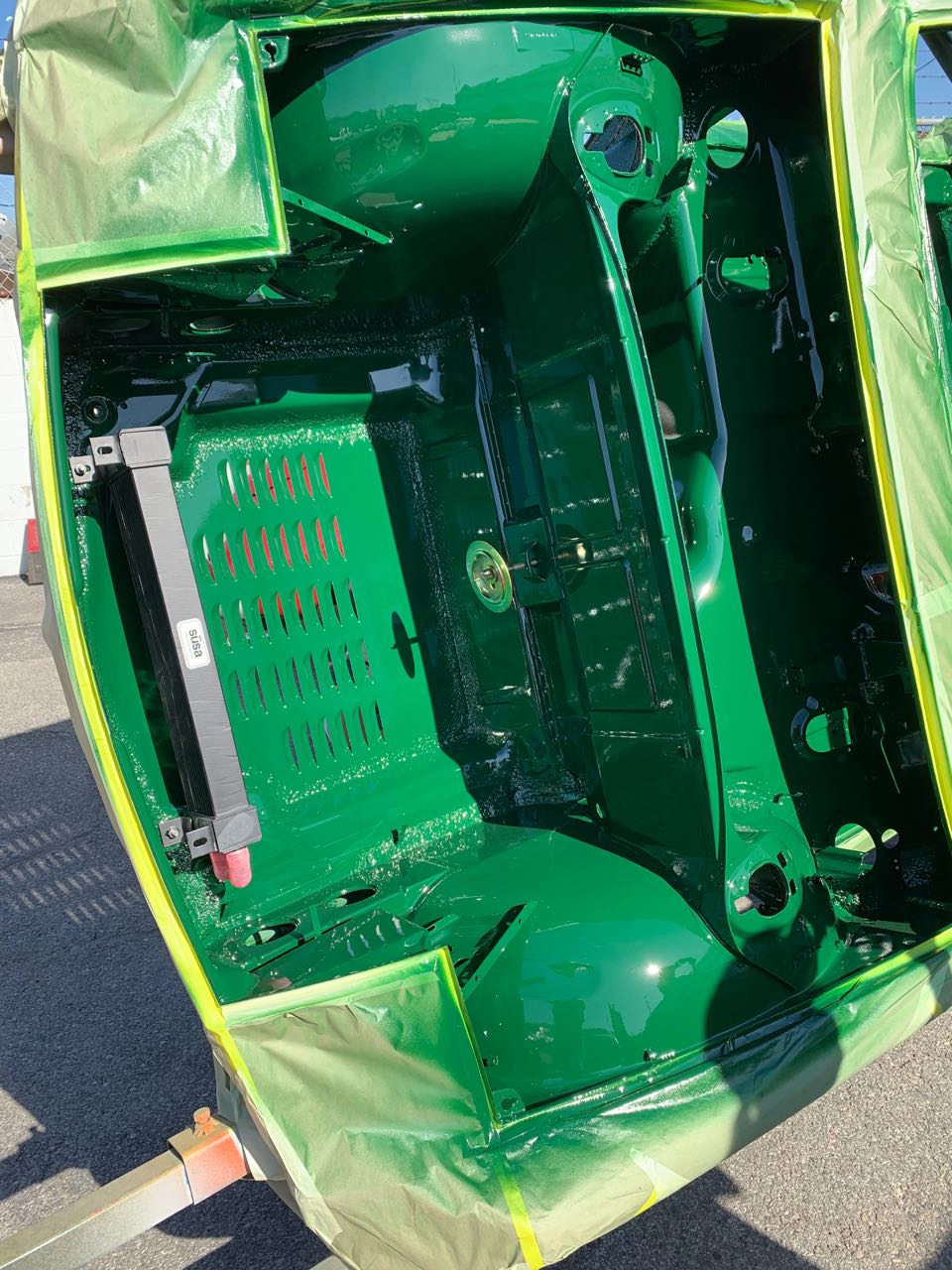

To be fair, my front end was a stock front bumper (no GT modification) with a GT modified valance. For air flow, I had the 5 round rubber plugs in the nose panel removed.
I realized I was having rising temps in sitting traffic during the summer so I had a front bumper "GT modified" to match the valance, essentially doubling the air inlet opening and have had very good results like that. However, since I am going to the 3.6 with no engine mounted cooler, I will start with adding the 2 Spal 6.5" fans with a programable thermostat and see how that works. If that doesn't get it done, I will then open the nose up, essentially connecting the round body plugs and see what that does. If that does not provide a solution, I will replace my current oil cooler with a larger one that I have.

QUOTE(Cairo94507 @ Feb 18 2024, 11:55 AM) *
I realized I was having rising temps in sitting traffic during the summer so I had a front bumper GT modified to match the valance, essentially doubling the air inlet opening and have had very good results like that. However, since I am going to the 3.6 with no engine mounted cooler, I will start with adding the 2 Spal 6.5" fans with a programable thermostat and see how that works. If that doesn't get it done, I will then open the nose up, essentially connecting the round body plugs and see what that does. If that does not provide a solution, I will replace my current oil cooler with a larger one that I have.
How are you currently exhausting the air?
I'm guessing you don't really want to cut into this car.
Before i cut the hood and added the shroud i simply removed the two large plugs in the trunk floor. While that did somewhat work, you could see the hood lifting at higher speeds and the front end felt very unstable above 80.
Adding a shroud would help with that but the surface area of those holes probably won't be enough to keep your motor cool. Plus, you'll be dumping all that hot air under the car, which is the last place where you would want that.
Anyways, after all the things i have tried, out the top is still by far the best option in terms of air flow and down-force but i understand that the look is not for everyone.

Hi Andy - I have an aluminum shroud that seals the oil cooler and once I add the 2 fans, the fans so air will exhaust out the louvered panel in the trunk floor. That should provide sufficient air flow. If not, Plan B goes into effect.

QUOTE(Cairo94507 @ Feb 18 2024, 02:57 PM) *
Took my breath away!
That's just freaking gorgeous!
I'm so envious...
Put a temporary manometer in the duct (precise pressure gauge) and actually measure pressure BEFORE you cut out those beautiful louvers!
Opening front OK in my book.
Adding fans, just brain dead, automatically do it on anything that is used as a streetcar.
Changing the way that front trunk looks would be the very LAST mod I'd do...
