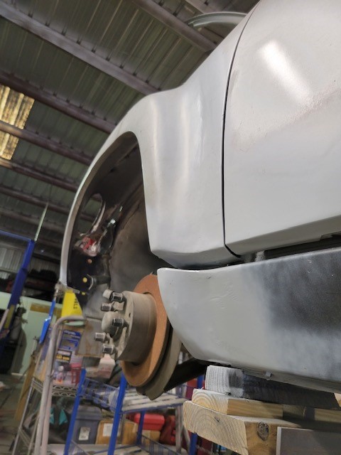

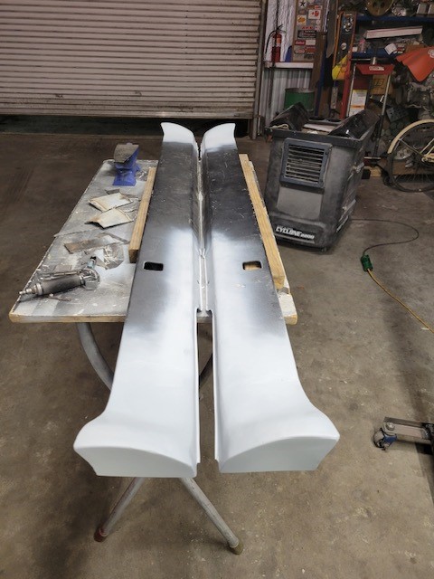

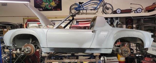

I used Ben's ends on my original metal rockers, still a lot of work to get them right but way better than the fiberglass alternatives
Attached Image Attached ImageAttached Image

Those look great Dave. Mark
