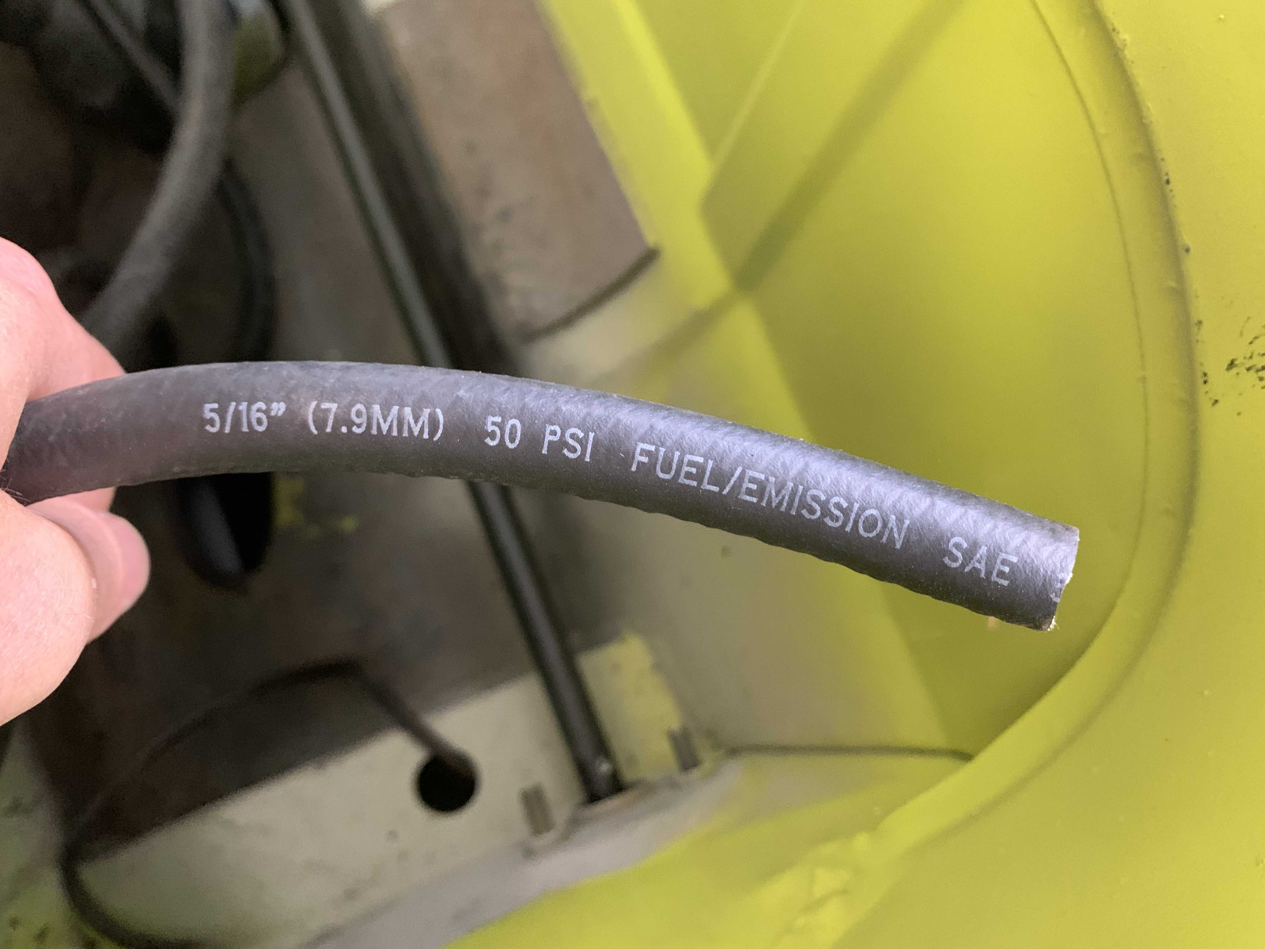

Looking for help regarding correct fuel lines while I await a new Dansk tank to replace the unusable one I received (thread here).
I have a '73 2.0. A PO moved the fuel pump up front and under the tank and cut out a door so that the fuel pump can be accessed from the frunk (like the '75 and '76).
First question: regarding the send and return pipes on the bottom of the tank - the send line measures at 10 mm and the return at 8 mm, yet the list in the AA fuel line kit lists both lines as 7 mm. Is that correct? I didn't want to force it, but I cannot seem to get the 7 mm line in the kit over that 10 mm pipe.
Here are pics of the pipes I'm speaking of as well as pics of what the lines were when I removed the old tank (a 5/16 AKA 7.9 mm USA made line on the send and a 7 x 3 made in Germany line on the return).

Bruce, yes, the return line from the tank will mate with the line in the tunnel. Sounds like you're suggesting a 7.5 mm rubber line there (instead of the 7 x 3 rubber hose that was there originally). Ok.
However, the send line does not mate with the tunnel line - it goes to the square fuel filter (8 mm inlet). Sorry I did not mention that in my original post. Thus, trying to figure out what line to use that goes from the 10mm tank pipe to the 8mm filter inlet.
As stated in original post the original rubber line there was a 5/16" (7.9 mm). I guess was the PO's solution - it appears to have worked since it's in between the two sizes it mates to on each end. Should I just try to find a new 7.9 mm hose?
For what it's worth ... the filter outlet goes to a 12 mm line which connects to the fuel pump. I'm using the square filter that came in Auto Atlanta's kit and a new fuel pump I bought from AA as well. The outlet from the fuel pump mates to the line in the tunnel.

Why - what is the benefit of converting the original 10mm send pipe on my tank to an 8mm other than more hose options?
Because I believe I already have that figured out - use a 9mm hose from the 10mm tank pipe to a Tangerine Racing reducer/adapter (9.5mm to 8mm) then a 7mm hose to the 8mm inlet on the filter.
From what I can tell that should work. Hoses should be .5mm to 1mm smaller than the fitting.

I used this on a 74 that got a front pump Gates 5/16, 3/8 Inch Hose Connector - 28594. $5 at Oreillys and usually in stock.

If you already have an adapter, then yes, no reason to change anything other than to reduce possible failure points. I was trying to address your question 'what line to use that goes from the 10mm tank pipe to the 8mm filter inlet'. You didn't mention you had an adapter until your last post.

Google SAE 30R14 T2 which is the spec the hose is made to.
Add Gates to the search if you want to see Gates products
This is because the 75-76 cars had both pipes as 8mm, and correspond with filter pn133.133.511 (8mm in, 12mm out).
Assuming that's the filter you have - your best bet is to change the big pipe to an 8mm pipe (which maybe should have been included in the kit) ..
