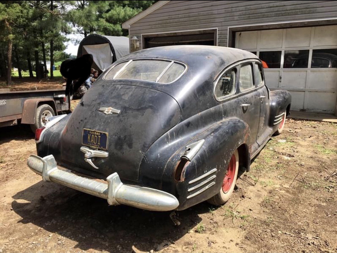

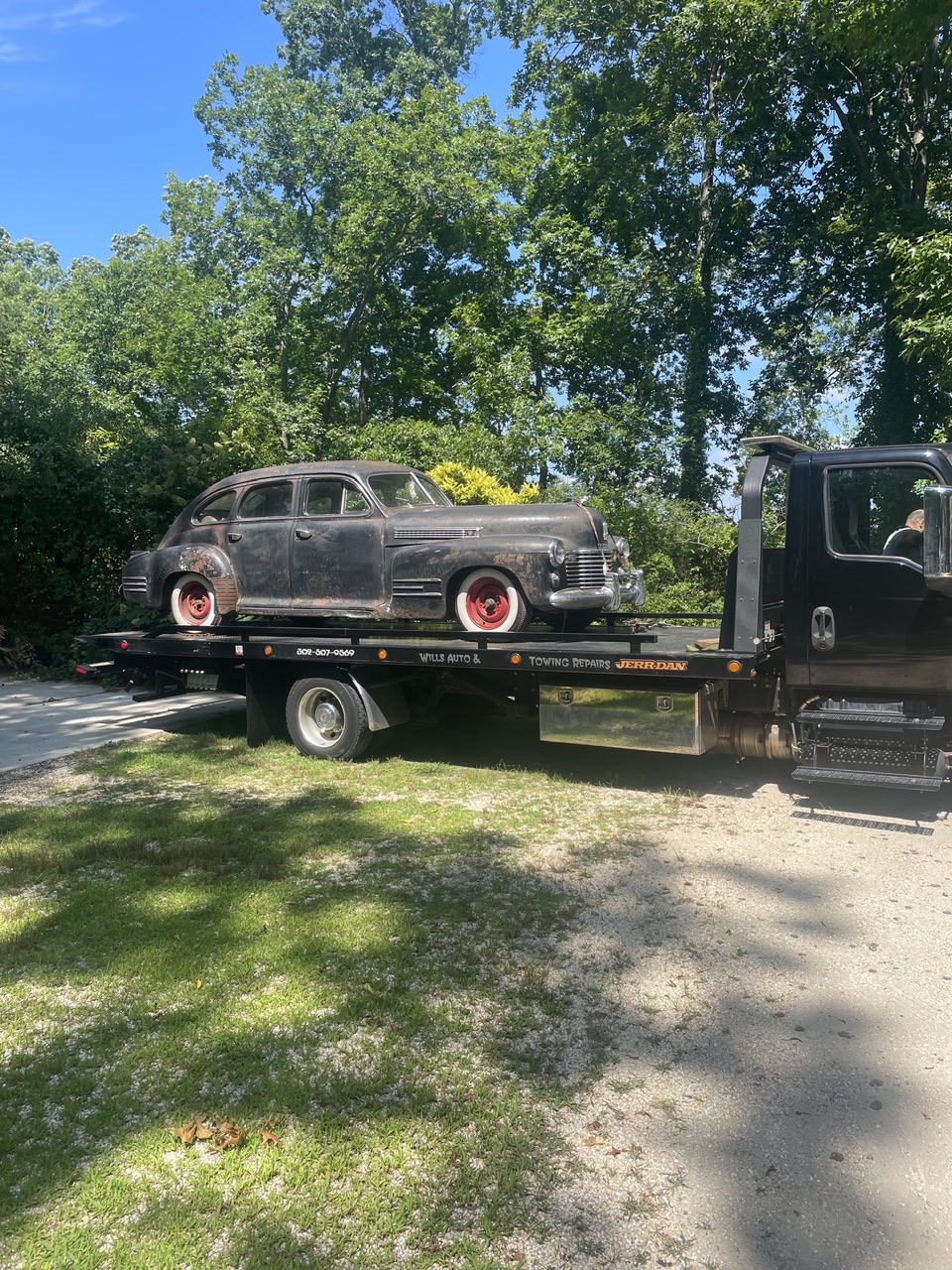

So here’s my next project now that the Safari 914 is done. I don’t anticipate getting into it until fall/winter, but I now have the base for the project. It’s a 1941 Cadillac series 61 that I plan to put on a modern Escalade platform.
If there’s interest I’ll update this as a project thread. I realize this is far from the intended scope of this forum, and if there’s no interest I’ll not fudge up the forum with this non-914 project. But if there’s interest, I’ll post progress once I dig in.

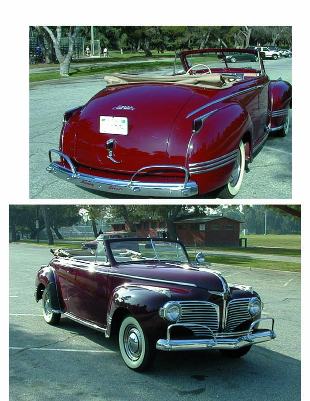

This is a picture of my 1941 Dodge Convertible. Note the 3 stainless strips on each fender. In the early 40s before the war this was the look of high design. 1941 was a very interesting year. You will see design elements running through all the different makes that had an abrupt stopping of production for the war in 1942.
It will be interesting to see how you blend the very old with the new technology. That is a big boy.
Best Bob B

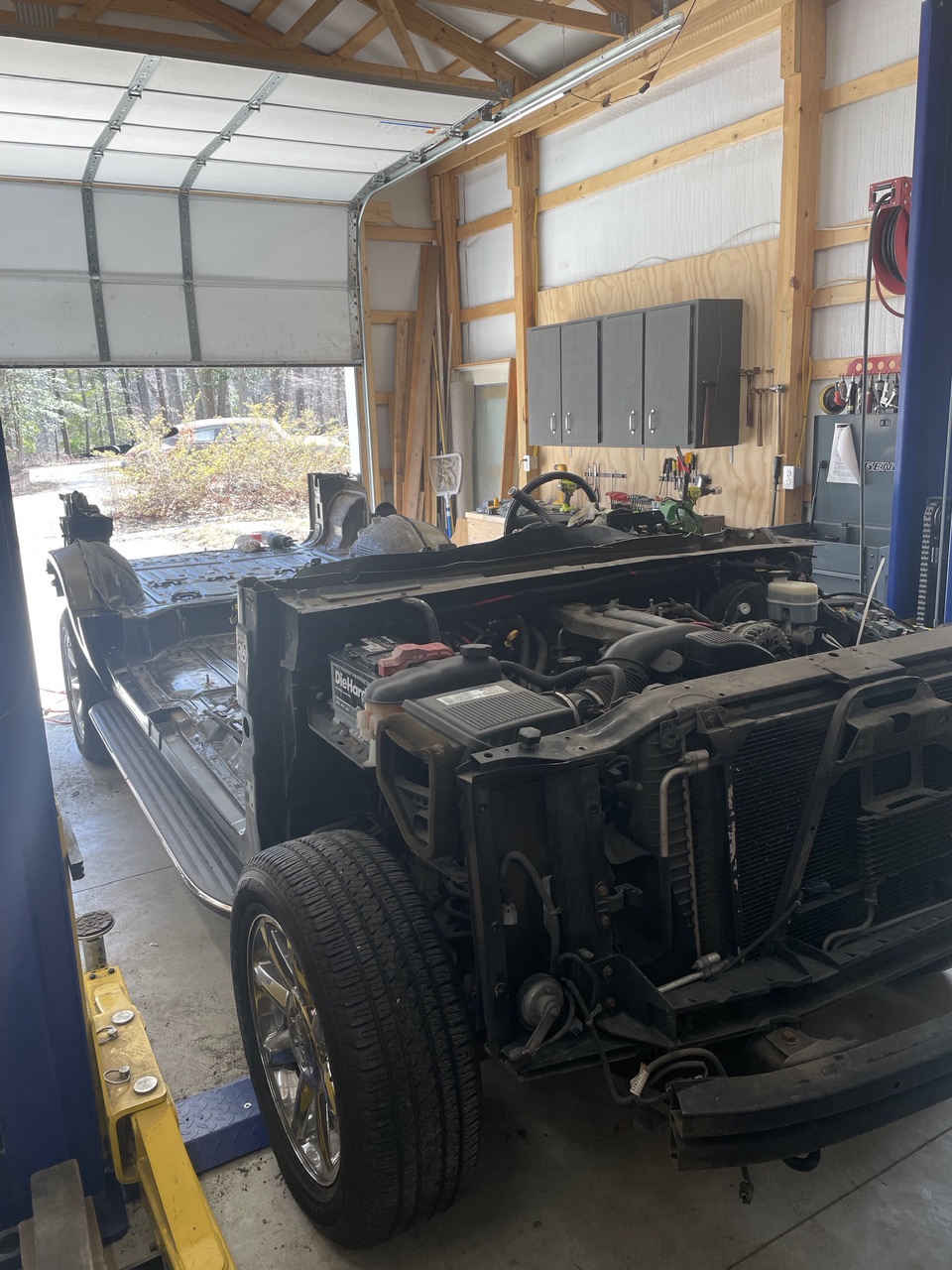

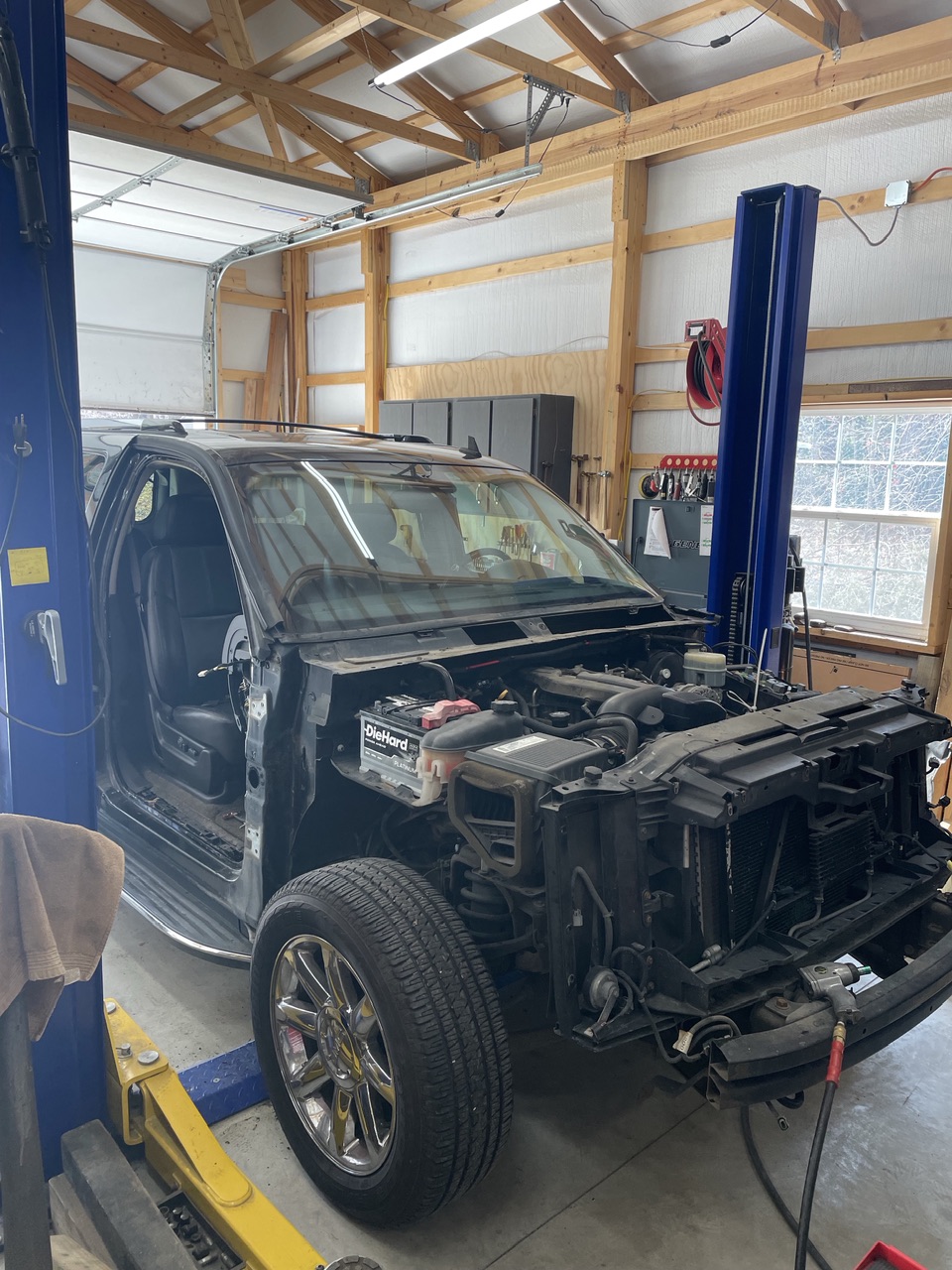

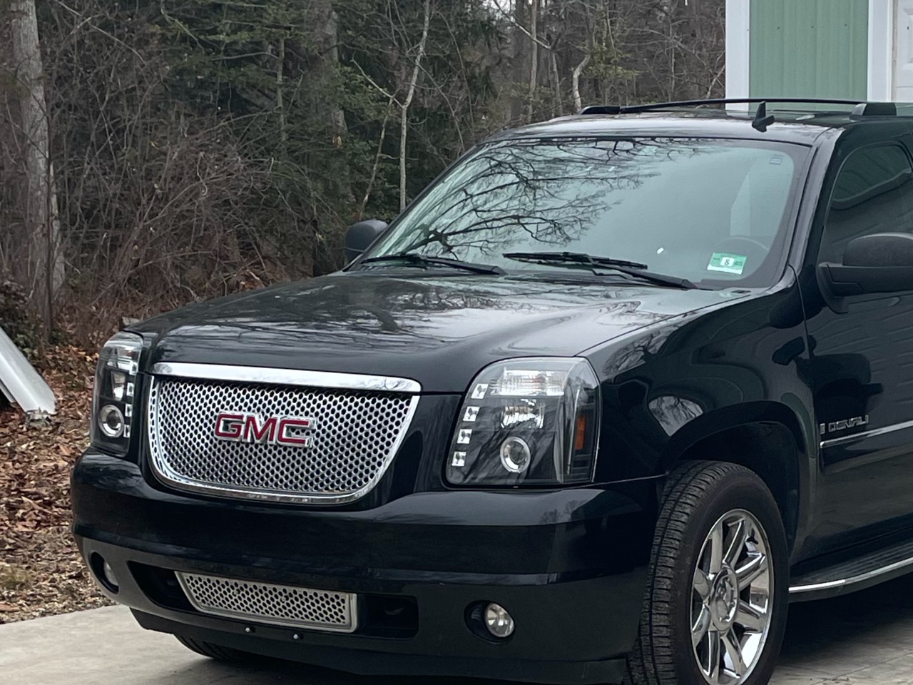

I picked up the “donor” for this project. It’s a 2008 GMC Yukon Denali. It’s got a good drivetrain, with a 6.2 non-DOD engine and AWD transfer case. I’m going to use the floor pan and firewall from the Yukon and graft the Cadillac body onto it. The Yukon is in decent shape and I drove it quite a bit until it’s 30 day temp tag expired.
That doesn’t sound too difficult but there will be many challenges!
Here’s my donor:

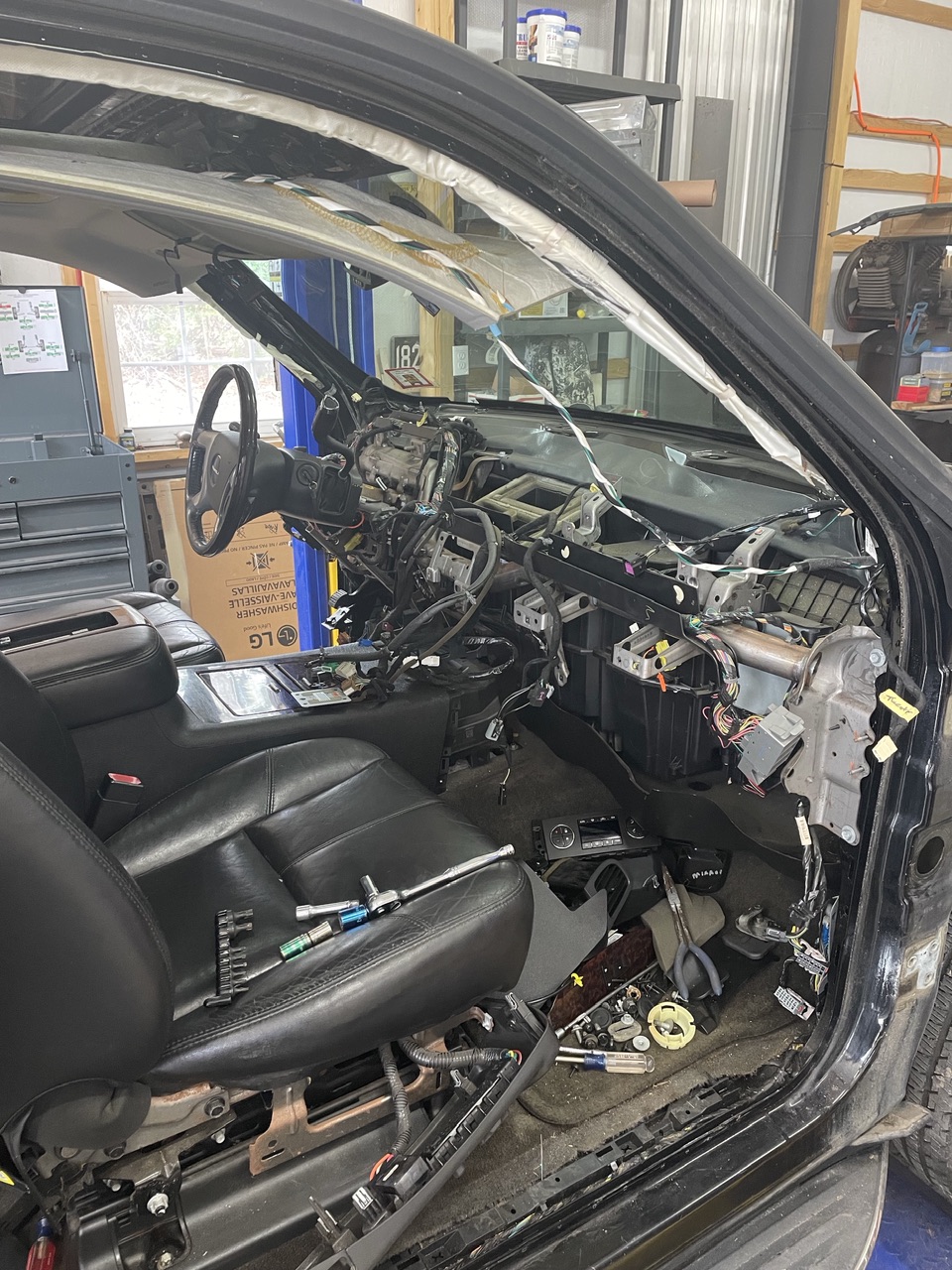

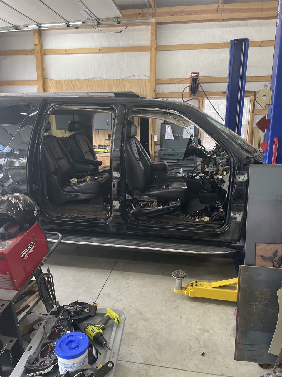

The last couple days I’ve been deconstructing the Yukon. After removing 5 gazillion screws, bolts, nuts, clips, and bloodying all 10 knuckles it’s starting to get down to its bones.

post Mar 17 2025, 08:09 PM
Posts: 1,483
Joined: 23-July 15
From: New Mexico
Member No.: 18,984
Your going to need more labels

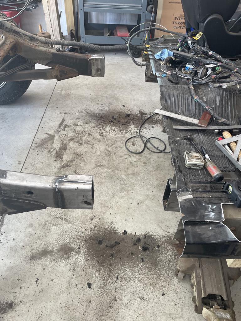

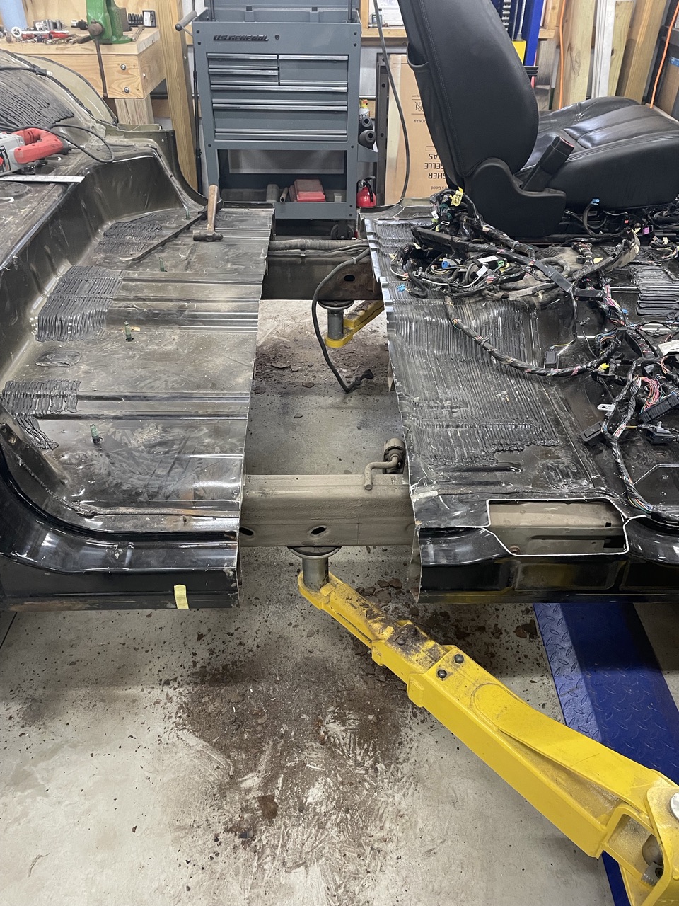

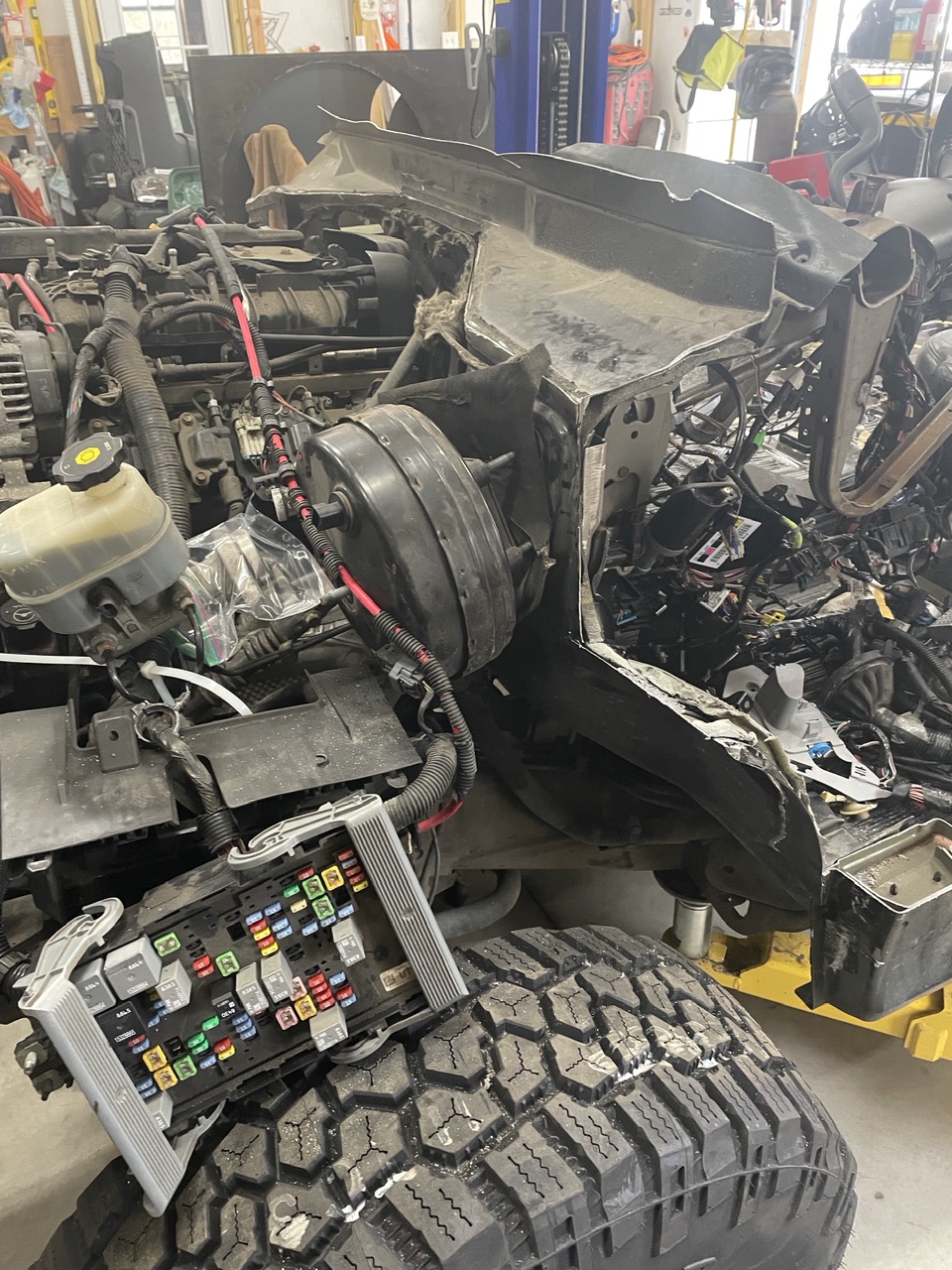

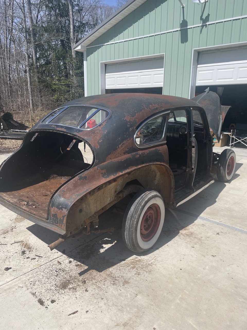

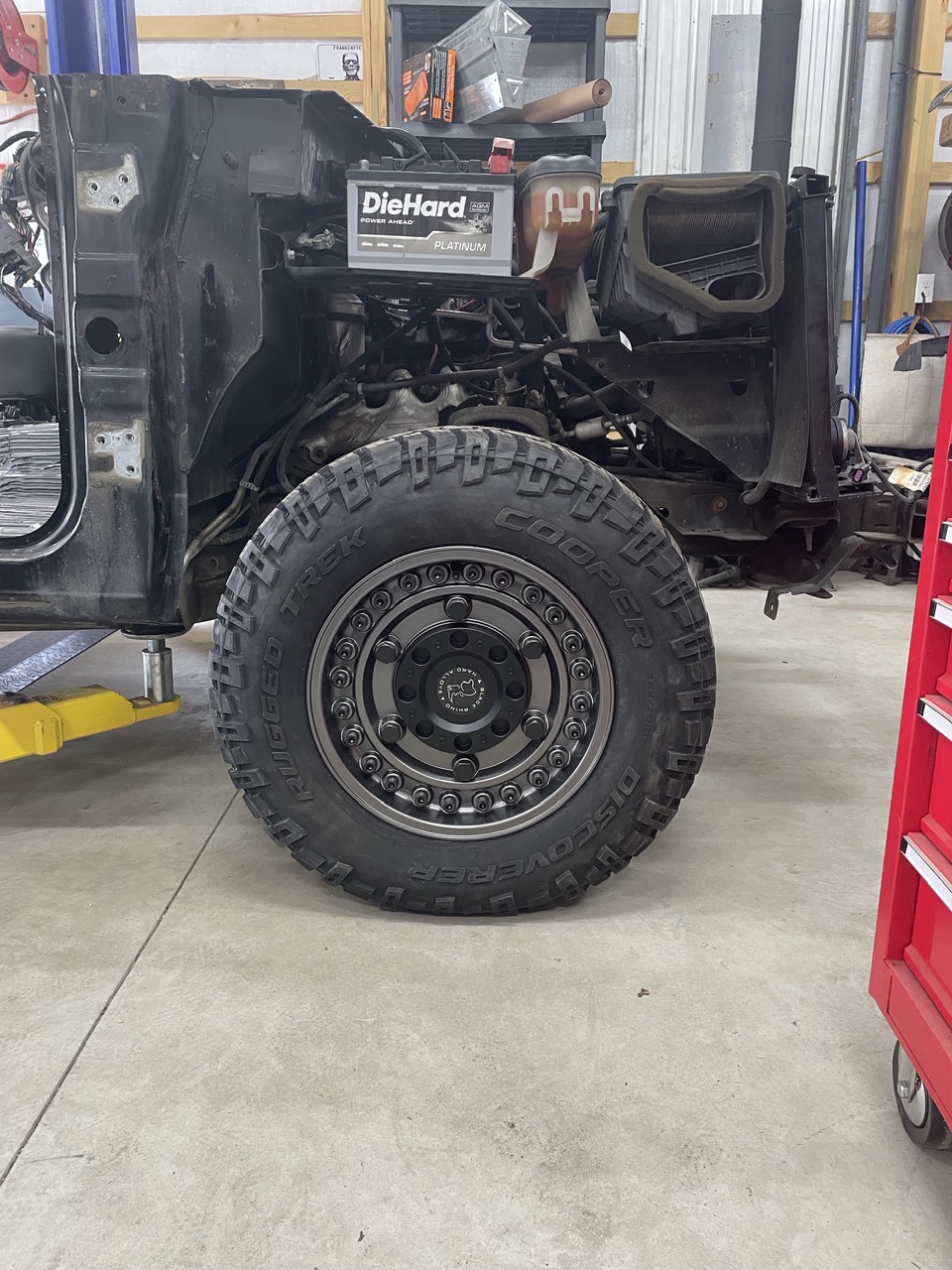

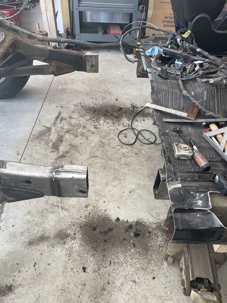

Got the Yukon down to bare bones and getting ready to take 12” out of the frame to make things “fit”.
Here’s the trimmed down body and the floor with 12” sectioned out, frame cut is next.
I also narrowed the firewall to match the Caddy. I’ll have to use a hydro boost brake setup when putting it back together because the narrowed firewall won’t allow for the vacuum brake booster. Also got the Caddy stripped down a bit…..fun stuff!

Oh yeah……and got new shoes for the project. I wanted something industrial looking and these nailed it!

post Apr 17 2025, 06:40 PM
Hey nice rack! -Celette
Posts: 21,382
From: Now in Superior WI
Member No.: 43
You may want to "Z" cut those rails rather than chopping a vertical cut
This will make a way stronger butt joint. Then a plug welded plate

QUOTE(rick 918-S @ Apr 17 2025, 05:40 PM) *
I’m still debating that in my mind…..research is showing straight cut for a fully boxed frame and “Z” cut or step cut for C-channel (unboxed frame). This is a boxed frame, but I still may Z cut it. Either way, it will be plated on both sides after welding.

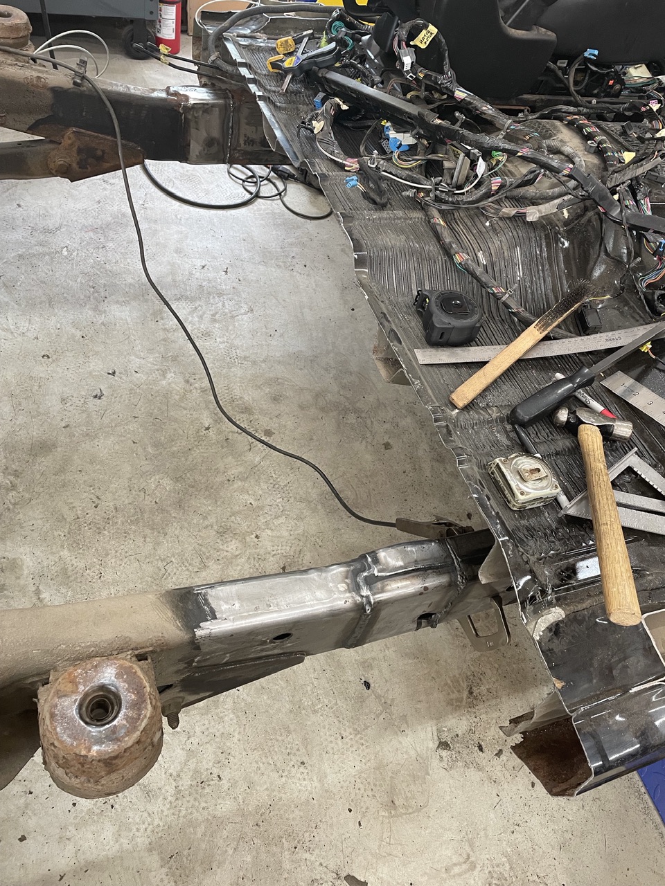

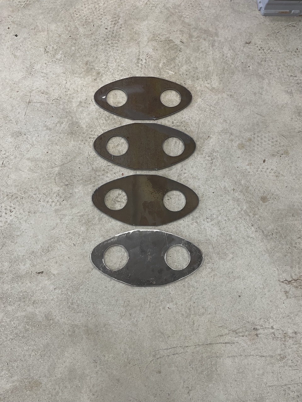

Big step completed…..had to shorten the frame 12” to make it work for the Caddy. I cut a 12” section out of a straight section of the frame and welded it back together. I also made “fish plates” that I’ll be adding to the splices.
Cut
Paste
Fish plates I cut on the plasma table
KELTY360
post Apr 24 2025, 08:22 AM
914 Neferati
Posts: 5,192
Joined: 31-December 05
From: Pt. Townsend, WA
Member No.: 5,344
Must really trust your welding skills. (IMG:style_emoticons/default/smilie_pokal.gif)
