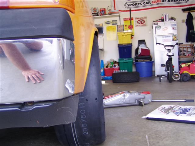

> New Keiser rims w kumho tires mounted, Looks like I need to adjust ride height

Went to Tire Rack today and got the Kumho V710's mounted on my new (too me) Keizer rims. Went the with the 205 50 15 non heat cycled. Of course when I got home I had to put them on the car. I using 1/8" spacer on the rears and 1/4"on the front looks like I need to adjust my ride height a little. Front is setting 24 inches from floor to top of wheel arch, rears are at 22.

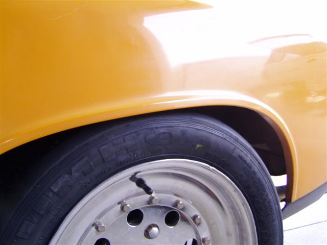

Tight fit in the rear, glad a PO somewhere along the line rolled the fender lip.

Damn you can go 4 wheelin wit dat car.
Don't worry so much about the hieght of the fender lips or top of fender.
Measure ride hieght at the lift donuts. When you get her down below 4" then you got sumpin. I am some where around 3 3/4 to 3 7/8.

Well I had to go and measure. 5 3/4 at the donuts. (IMG:http://www.914world.com/bbs2/html/emoticons/huh.gif)
Bring on the flood waters (IMG:http://www.914world.com/bbs2/html/emoticons/laugh.gif)

Those tires and wheels look really nice.
Do you have adustable rear spring perches?
You'll need those if you want to lower the rear at all.
front- Haynes pg 106.

He can't go lower anyways. The tire WILL rub the outer fender and it only takes a little bit to burn the paint. With stiff suspension poly bushings I had a 3/8 " between tire and fender. 1 run and came back with 2 of the cutest burn marks in the primer. size of a quarter.
I forgot about the rear suspension as I am used to coil overs.

How much clearance do you have on the inside at the rear? If you have good clearance between the tire and the inner fender, take out the rear spacers, and you will gain the clearance you need at the rear fender lip.

You can fit the 205/50/15 right in there.
I've done it on 7" rims, so has Nathan and Grant has 8" rims. (IMG:http://www.914world.com/bbs2/html/emoticons/smash.gif)

without the spacer on the rear the rim rubs the brake caliper (IMG:http://www.914world.com/bbs2/html/emoticons/dry.gif)

Its not a problem with my fuchs, If I remember correctly the backspacing on fuchs is.... 5 1/2? The keizer is 5 1/8. Maybe its the other way around. I will check tomorrow.

Well I went out and tried to adjust the ride height...I'm fuched (IMG:http://www.914world.com/bbs2/html/emoticons/ohmy.gif) It's is low as it can go, though I can get it adjusted up to over 7 inches from the floor to the donut (IMG:http://www.914world.com/bbs2/html/emoticons/laugh.gif)
so now what (IMG:http://www.914world.com/bbs2/html/emoticons/confused24.gif) I guess just run it the way it is and see what happens.

I'm assuming you are referring to your front end suspension, which is totally adjustable for ride height.
You need to re-index your torsion bars.
I quote Skline:
Remove the end cap on the torsion bar on the inside by removing the adjustment bolt and pull the end cap off and change it to give you more adjustment. In other words, if it is at the top when you remove it, put it back in more towards the bottom and then put the adjustment bolt back in. Then you will have more adjustment. You will need a jack underneath the control arm to get it out and then to put it back in.
If you're referring to the rear suspension, you need to give us more info.
