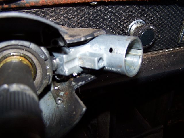

I have the steering wheel off and the t. signal levers out and I need to know what to do next. I have no key and the steering is locked in place. It won't matter if the switch is mangled.

The locking pin will stop you from getting that bugger out. Take out the passenger door handle and take it to a locksmith to make a key. Easy 'nuff.

driver side door, trunk locks (either) or the glove box lock. Actually the rear trunk lock would be the easiest to pull. Aside from that, your fuched. Actually not, you can have a mobile locksmith come out and make a key for you on the spot. They did that for me about 10-15 years ago for about $50.00 Of course the next day I found the key I lost (IMG:http://www.914world.com/bbs2/html/emoticons/wacko.gif)
I tried like hell to get the switch out of the ignition, using dental picks and crap to try to push in the locking pin. It wasn't working for me, at that point I was looking for a chainsaw.

Didn't I read somewhere that if you know where to drill you can drill a little hole and depress the locking pin through that? Or was that for something else?

Okay here we go. The ignition switch can be removed if you do not have a key. I removed the igniton switch by poking a small pin into the small hole you see int eh switch assembly. After that was done you can then push the lock assembly that sits down inside the switch to the right and pull the whole thing out. and VOILA unlocked.
