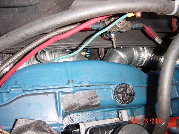

In another thread some of us discussed a variety of methods to get fresh, cool air to the engine to assist in engine cooling.
I ran this setup at M-O last weekend and my CHTs dropped to under 400 degrees for the first time since my engine rebuild. Before these ducts, I could only run 1 or 2 hot laps before my CHTs got too hot. Now, I can run 20 laps at M-O and the temps stay under 400 degrees.
2-3" ducts from each turn signal opening.
Front view with the fender off:

Into the fan housing....

groot
post Aug 29 2005, 07:17 AM
Dis member
Posts: 897
Joined: 17-December 03
From: Michigan
Member No.: 1,444
No interference... I'm running a bit more ground clearance than you're planning, ~4" in the front. I need to run this much to give me 1.25" of travel before the jounce bumper comes in. My strut could be a little shorter to give me more travel, but I'm living with what I have for now.
Many SCCA 914 have the sewer duct, but my package layout does not allow me to run one through the middle of the car.
