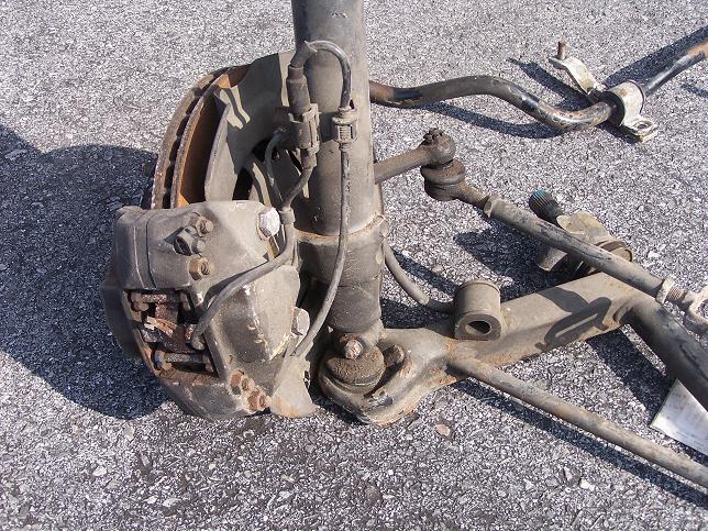

I converted my 71 914 to 911 a-arms, torsion bars, aluminum crossmember mainly for the sway bar which fits right onto the a-arms without drop links. This configuration really stabilized body roll and firmed up the ride.
For my 74, I'm going with a complete front end from an 88 Carrera including the struts, calipers, and vented rotors, 5-lug hub, aluminum crossmember, a-arms, torsion bars, and I may even use the steering rack.

Final front end suspension.
1988 struts
New pads, bearings, seals, and flex hoses
New Zimmerman cross drilled rotors. I am painting the rotor hats red.
1988 calipers rebuilt and painted red
koni adjustable red inserts new
197? 911 a arms w/ the old through body tabs for my oem through body sway bar.
- My car didn't come with one thus I will be installing that too.
- I kept the bushings and front and rear brackets from the 88' 911 a-arms as they were in much better shape. I don't like the poly or bronze? bushings as I personally find them to loud as far as transfering vibration.
I have 2 different through body sway bars one oem diameter and another a monster.
my old 74' 914 cross bar in great shape.
turbo tie rods
bump steer kit
all rusty old parts have been dropped off for bead blasting and powder coating in gloss black.
I will post pics when all is assembled.
Pete
