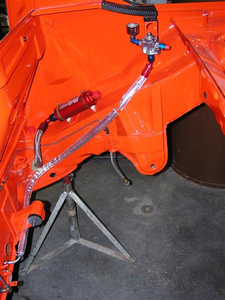

Yaroon, surely there is a better place to mount a 911 tank like where the battery should go. If the tray was cut out there would be enough room there?
I'm sure I saw a picture of a tank mounted in this position -anyone have it in their pic collection?
Oh another thing...Jaroen can I talk you into selling me your six tank as you're not going to use it?
jim912928
post Dec 4 2005, 11:33 AM
Posts: 1,487
Joined: 8-January 04
From: Granger, IN
Member No.: 1,536
Interesting question...I have an 84 carrera tank (still in the car). Would it fit in the passenger side fender well if the batter were relocated?
thesey914
post Dec 4 2005, 11:45 AM
Posts: 1,155
Joined: 1-January 03
From: Staffordshire -England
Member No.: 66
An early tank might fit better as they're a bit squarer...this nice pic of Brants car shows it might be a bit tight
