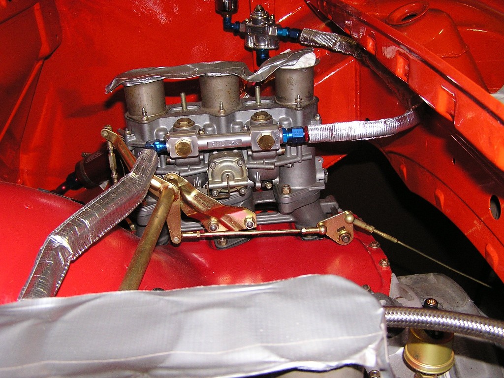

Greg,
here is my version.
close to stock -6 except the stock version screwed into the tranny a couple of inches forward of mine.
most people make a 3rd version that bolts onto the tranny a little forward of mine too.
brant

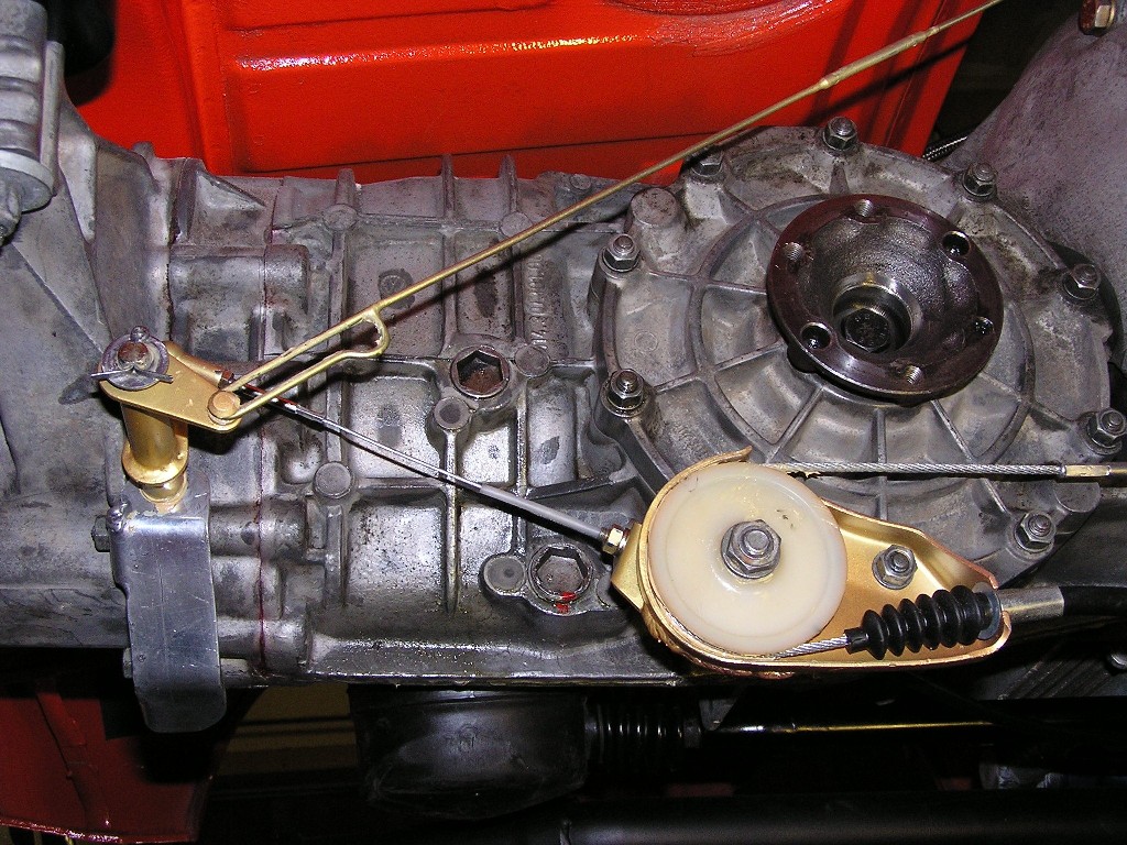

post Jan 11 2006, 04:11 PM
Posts: 12,109
From: Colorado
Member No.: 47
My car doesn't happen to have tinwork..
but most cars should/do and then would have a hole in the rear tin for rod to pass through:

The rod to the transmission is just like that on a 911 (since it's cable comes from the other end of the transmission in a 911), so the geometry is the same. The bell crank is unique to the 914-6, but the pictures are quite representative.
The 914-4 and 914-6 throttle cables are different though, so you should use the correct one.

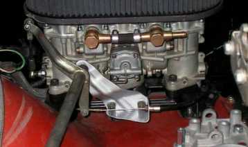

this method might make the cable bind..
It sure did. Thats pic from my carb. I used stock 914-4 cable, but the problem was that the cable was too short and it had to make too tight turns => cable bind (IMG:http://www.914world.com/bbs2/html/emoticons/mad.gif)
Now I have bellcrank system (did it myself) and I am very happy with it. (IMG:http://www.914world.com/bbs2/html/emoticons/smile.gif)
