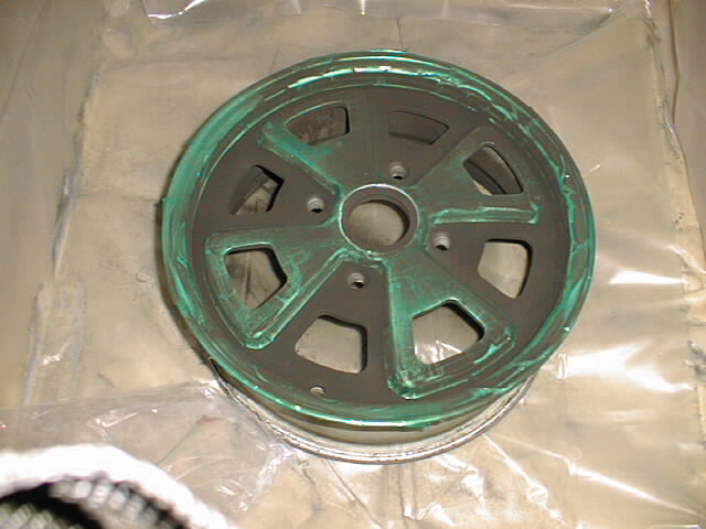

I just got me a powder coating system, I bought the craftsman setup, don't need a compressor to run the gun. I dedided to coat my spare wheel for my spare tire. Never done this before but it seems straight forward and pretty easy. The hardest part is preparing the piece to be coated.
Anyway heres some pics. of the process
The wheel all masked off ready to take some powder

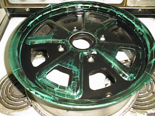

The powder is applied and ready for the oven to cure

After it cooled in the oven while the oven was cooling down, I heard this is the best way to do it, let the piece cool down in the oven as the oven is cooling down.

Now just a bit of sanding an polishing and the wheel is ready to go

so how does the powder get applied w/no compressor?

What kind of masking tape is that? I was surprised to see it go through the oven heat cycle. (IMG:http://www.914world.com/bbs2/html/emoticons/idea.gif)

The gun has its own fan system for blowing the powder out of the cup its put into, the trigger is a variable speed trigger so you can control how much powder is being applied, its a great unit it looks like a blow drier.
After reading a thread on the PP 911 board I went a bought one. Good thread on the product.
http://forums.pelicanparts.com/showthread....=powder+coating

The masking tape is high temp masking tape from 3M

The most difficult part of setting your system up is getting an oven to dedicate to power coating. I wish I had 220V in my garage. You don't want the oven in your house, the fumes are BAD.
Ok... that is 2nd on the list. First is cleaning your material, getting rid of all the crud. Sandblasting works wonderfully once the material has been scrubbed down.

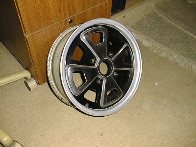

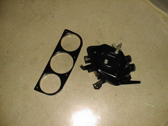

Couple more items I coated over the weekend

736conver
post Feb 13 2006, 07:30 PM
Posts: 2,117
Joined: 25-May 03
From: SE Wisconsin
Member No.: 736
(IMG:http://www.914world.com/bbs2/html/emoticons/agree.gif)
Even in my 2 car garage the fumes get bad. During the winter I leave the door open.

Stratplayer... how did you do the intake plenum? Did u take it down to bare metal? Or scrape off the gunk and powder over the existing paint?
