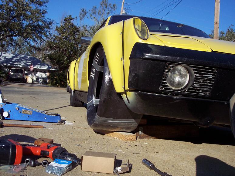

8.5" rims and big tires need ALL the fender you can get.
my Hoosiers have 1/2" outside and 1" inside with -1 degree camber.
Oh yea section width is 11.5"
and rivets rock (IMG:style_emoticons/default/mueba.gif)

I love the big duct tape tire look....
what happens to the 100 mph tape if you exceed 100 mph?
