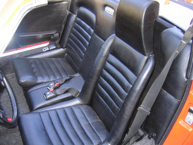

QUOTE(sixerdon @ May 24 2009, 06:39 AM) *
George, where are the "rear carpet securing tabs"?
Don
You can see where one of them is located just in front of the passenger seat cushion in the photo below.
