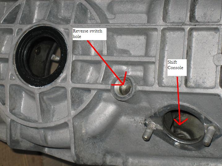

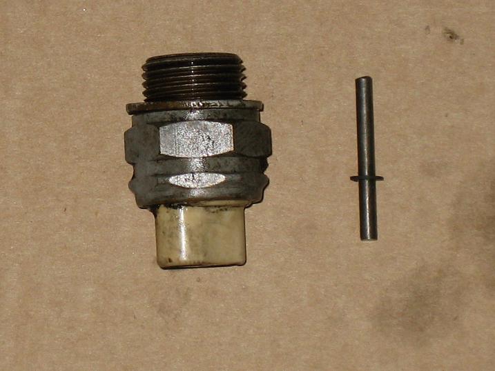

Step 1. Remove the shift console and the reverse switch with its pin

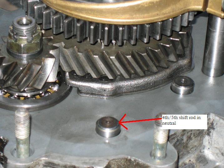

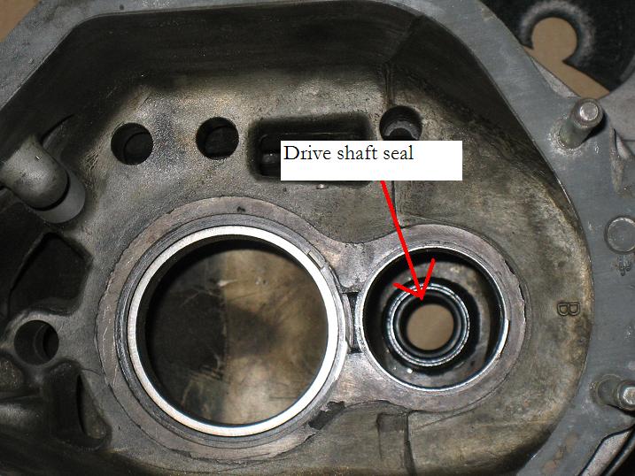

Step 2. Remove tail cone. Be ready for the reverse gear and its little bearings to fall out. You should now be looking at the business end of the tranny gear stack.

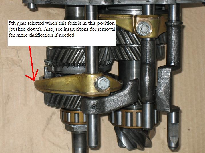

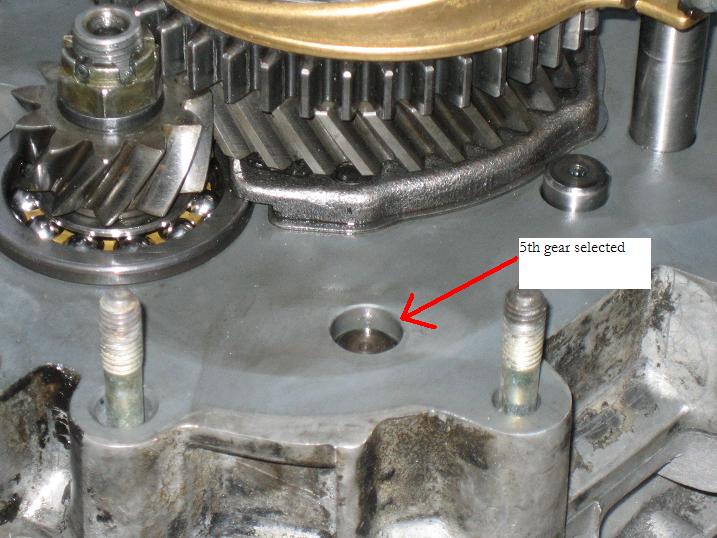

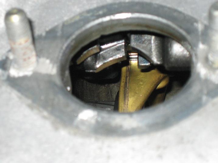

Step 3. Select 5th gear by taking a socket extension and pushing in the 4th/5th shift rod. Its ok to use a hammer, just dont beat the hell out of it (IMG:style_emoticons/default/wink.gif)
(4th and 5th Shift rod in neutral)
(5th gear selected)
You can now remove your gear stack by lifting at the intermediate plate.

Step 1. Select 5th gear on your gear stack.

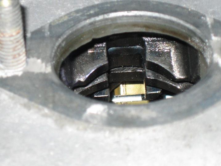

Step 5. It is now time to put the tranny back into the neutral. In the first pic you can see the shift rod notches are off center. Take a screwdriver and push the 5th/4th shift rod so it is centered. It should look like the second pic.
Step 6. Once in neutral, put the shift console back in. The shift console only gets the O-ring. The gasket that comes with the seal kit is for the plug of the tail shifter that goes there, not for the side shifter console so don't use it.
Step 7. Reinstall the reverse pin and switch.
