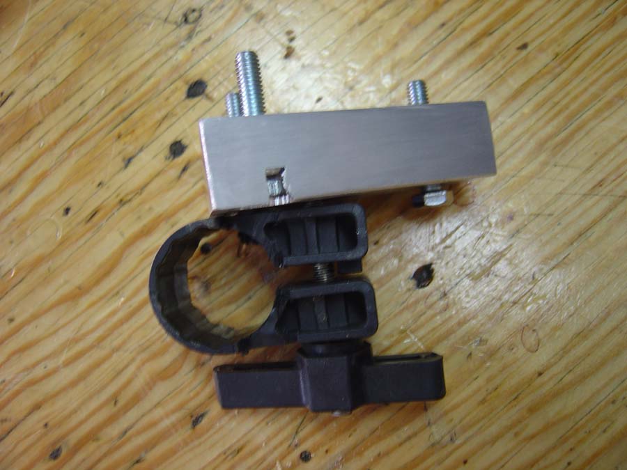

I made these to mount on the old ski rack holes at the bottom of the targa bar.

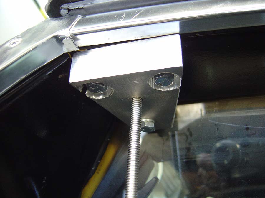

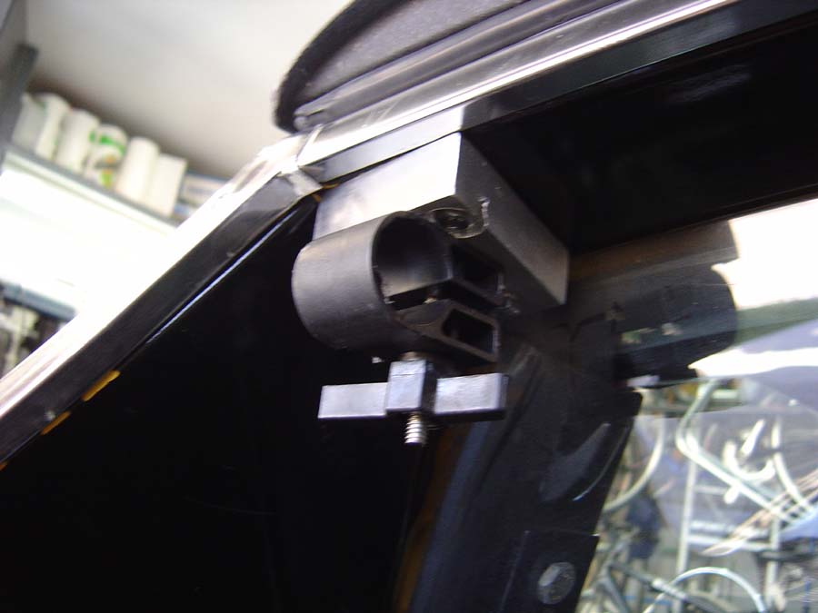

like this.

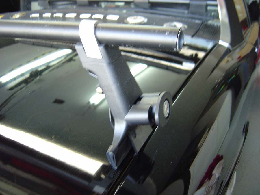

Forward bar.

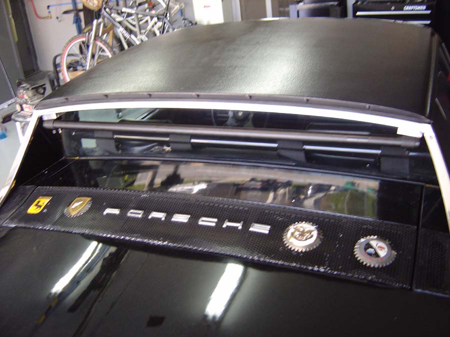

Rear bar.

I clamped a tray between the bars and the bike mounts in the tray. Sorry for the lousy pics. Taken in available light with a $20 camera. I'll take some better pics with the bike mounted on it later. The bike was tested on the rack at WCC 05 at 100 MPH and didn't budge.
