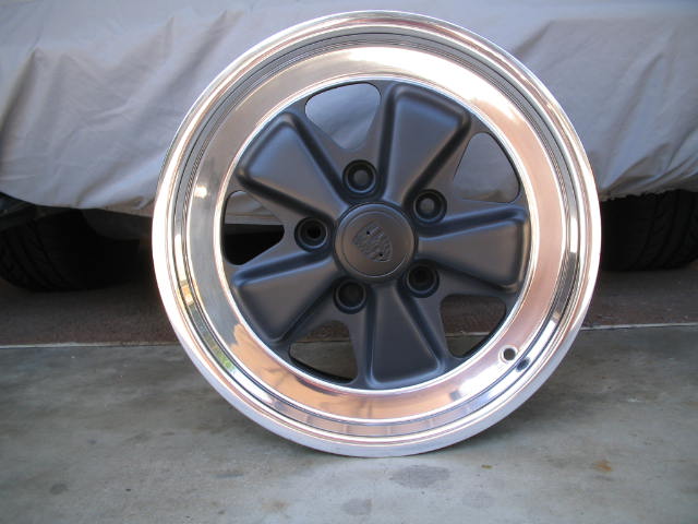

Here's a wheel i just finished. Eastwood wheel paint (satin black) for the centers and Krylon semi-flat for the cap.A little difference between the two, more gloss w/ the krylon semi flat.

Yup, you don't need to remove the original anodizing. Just clean things up and paint. Just rattle can wheel paint.
That is a great picture. You can see the difference bewteen a satin finish and semi-gloss finish.
