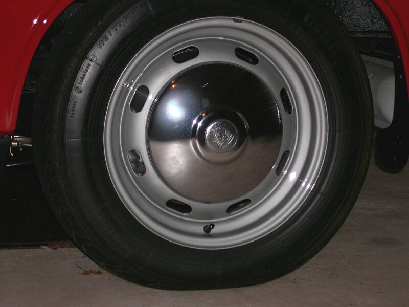

About 15 years ago I had mine shell blasted & refinished with a Glasurit paint (supposedly a factory match) by a Porsche shop in Cincinnati. They did great work & the paint is still perfect. If anything, the finish may be too glossy, but it's never been polished - only waxed every couple of years. As I recall, the price then was about $100 & worth every penny. I'll dig through my records for the paint number.
Wow they look great.......
But our wheels on 914's..Steel types..that is
Were not clear coated .....just shot with stock silver..
BUT I do love the clear on your's..
Gives it the .proper, look..

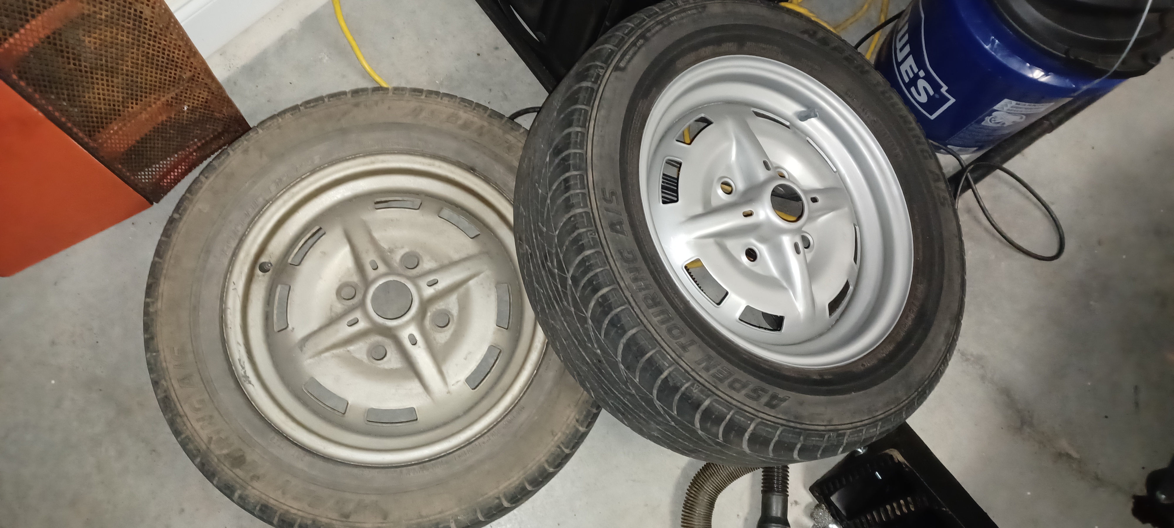

I recently picked up some rattle can paint at Home Depot that I thought might be close. Glidden Max-Flex in "Shining Armor Satin". It turns out to be a pretty good match for the factory finish, dries really fast if you use light coats and it covers like crazy. I only used 1 can for 4 wheels! Pic is of OG finish and painted wheel for comparison.
