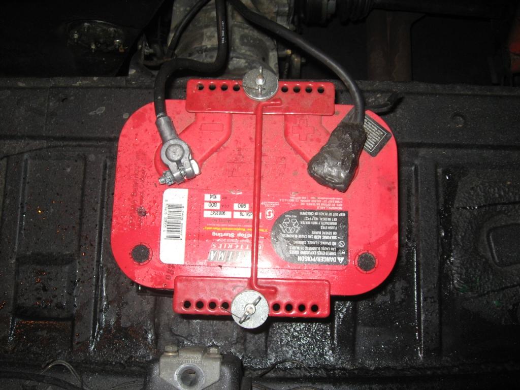

From Optima's Website regarding RedTop Batteries (http://www.optimabatteries.com/publish/optima/americas0/en/config/product_info/automotive.html)
"OPTIMA batteries withstand the high underhood temperatures associated with these Performance vehicles. The sealed cells make the battery spill-proof, even if you install it on its side! This prevents external gassing and leaking which can damage engine components and limit battery performance."
Well, I disagree and here are the pics to prove it...

Are you positively certain that came from inside the battery?
If so, what voltage are you feeding that battery? Are you sure?

The only way I got one to "leak" was by overcharging it.....17.5 volts worth. That got it hot enuff to boil.
It actually spewed green shittage out the vents up on to the trunk lid....that is acid, BTW. (IMG:style_emoticons/default/biggrin.gif) I was glad it wasn't in the engine room.
I got a new one FOC.

Could the muffler underneath have raised the temp of the battery excessively? Is the muffler heat shield still installed?

The car is actually ShadyGrady's here on the board. I broke two motor mounts Friday night on my car during the SEC2006 drive and he let me continue with his track car...
The pics were taken that night when we arrived in Helen, GA (1.5 hour drive). We suspected an overcharge, but it is still being investigated. Fortunately Lewis Broyles brought a spare battery with him when he brought my car up the next morning, so Grady was able to run his car on the SEC drive.
I always here "Optima Batteries DO NOT leak." Well, in some cases they do...
BTW: Battery acid was all over the trunk lid too. We know it was acid becuase the battery was soaked and the fumes were horrible.

Murphy's law says "Anything designed not to leak.....will." Optima is the lesser
of two evils. You could put in a acid resistant battery box.

The optima's do have vent holes but they don't vent vapors like normal batteries unless overcharged. It's more like they are leak resistant rather than leak-proof.

We manufacture specialty battery chargers (www.morningstarcorp.com). The optima is a gel battery. The electrolyte is absorbed in a glass matt (often called AGM - Absorbed Glass Mat) I believe the two black pucks in the top corners are vents. I've never disassembled one of ours, but most batteries have them. If you overcharge the battery (or overheat it, but I have no direct experience there) it will outgass. If there happens to be gel in the way of the vents, it will blow the gel out. It shouldn't vent unless there is a problem though. They are just there to keep the case from exploding (which is REALLY messy).

I agree. I used to head the battery charger manufacturing here some years back. I also have to design lead-acid batteries into some of our products. Heat kills batteries. The heat may be internal from overcharging, or external, say from the exhaust system. Basically, that battery is in the wrong place to start with, it is exposed to too much heat I believe. Overcharging may also be a factor.

Top view. You can really see where the leakage occurred through the vents. Also, the battery had a sticker on the side that says "Non Spillable."
