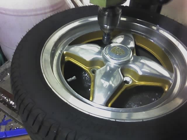

Success! 16 new chrome gorilla cone seat lug bolts and perfect 60 deg cone seats drilled into my allow wheels thanks to a very generous member (thanks again Patrick!). Neither the AR wharehouse guy, HPH, EASY or classifieds for >1 week resulted in the correct lug bolt. Well, I now have 12 extra of these mag style lug bolts if anybody needs one (IMG:style_emoticons/default/beerchug.gif)

Do you have a picture of the cutting tool you used?
