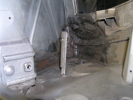

Hell hole. I left the battery tray off for easier acess to the frame rail. I'll weld it in later

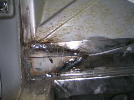

Pergatory, the driver's side. This was much harder. there were no preformed pieces and the engine lid release was in the way.

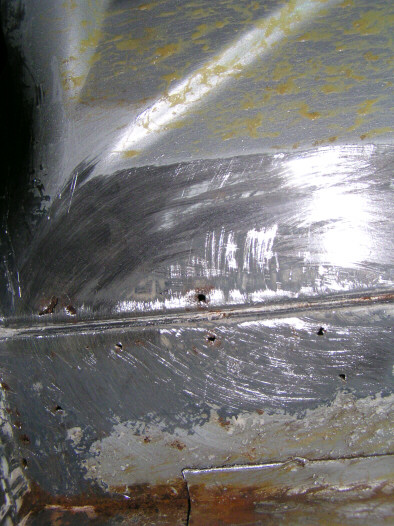

Driver side firewall

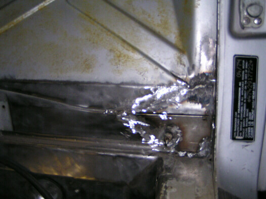

Passenger firewall

I wouldn't say it's beautiful but it's the best I can do and I'm pretty happy with it.
The pieces from Restoration Designs are wonderful. Definitely a must for something like this. I still can't weld for sh*t but I'm getting better. Fortunately, grinding sort of comes naturally for me. Lota work but pretty satisfying.
