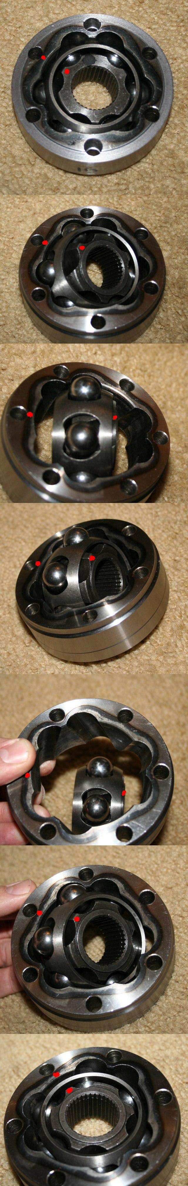

So I'm assembling the drive axles and those pesky cv joints won't stay put. One I accidentaly dropped and it came apart, the other, well, it basically came apart too.
I've heard reassembly to be similar to solving the rubiks cube...never did it without taking it apart or just changing the stickers.
Tips and tricks?
(and no AA, don't offer any tricks again, sheesh) (IMG:style_emoticons/default/mrs.K.gif)

Yeah, I looked, found a little here, little there. Oh well. I've been playing with it a while now and got it back together, tried to mate the stub axle to the cv and it got all outa wack again. I'm sure there is some *real* way to do it, I'll try it again later. It's probably a two man gig for me.

follow the red spots..pay attention to the how the "point" goes to the "wide" section of the mating part.
starting at the top picture, if both hands are on the CV at the 9 and 3 o'clock postion, your fingers on your left hand would be pushing "up" while your thumb on the right hand would be pushing down.
When the middle section is about 90° to it's original postion, it will slide right out (with a little help, but not much)
reassembly is reverse...

Oh see now we're talkin!
Thanks Mike!
I guess my problem is losing the cv's composure when trying to mate it to the stub axle.

too late I guess, but I would remove the stub axles....only thing it'll cost is 2 new cotter pins

if you access to a band saw and a drill press (or mill)
I "think" a tool like this could hold the CV...the rectangle part would clamp the axle, the protruding rod would go into one of the holes of the CV, this would prevent it from moving too much..only problem I see is that the rod would have to be pretty long and getting it clamped to the axle for easy removal might be a PITA...the block should be 2 piece, I "forgot" the split line on the top (IMG:style_emoticons/default/smile.gif)
